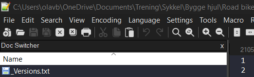

                    Love the new dark mode. Only problem is that I’m addicted to the “Doc Switcher”, where the “Name” column still is eye damaging (not really) white. Also, if you highlight/ select a file, that too will become white.
                    Nothing critical, but would be nice to have that fixed as well.
