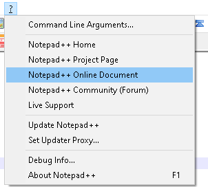

              Have you checked the online documentation at npp-user-manual.org, which is linked from Notepad++'s ?-menu:
              Because the “Searching” page has a section on how to use the “Mark” tab of the find/replace/mark dialog. And it has another section called “Highlighting” which details how to use the 5 numbered styles.
              Notice that they are controlled from different commands, and are not the same action, despite the similar names (I wish that the Search > Mark/Unmark All menu’s were called “highlight” rather than “Mark”, but we’ve got years of history, and they aren’t going to change that name at this point). But you should think of them as completely separate functions, which aren’t controlled from the same place or in the same manner. The Mark dialog is for a search/regex based marking of text (the Mark dialog), whereas the Mark All numbered-styles submenu is for manually highlighting a single selection (or all the smart-highlighting matches, if smart-highlighting is enabled). Put another way, the Mark All numbered styles are used to make the current smart-highlighting selection persist (stay highlighted) even when you move the cursor someplace else.

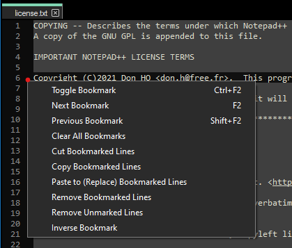

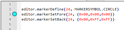

                                And, while it is possible to do some manipulations with the bookmark symbol, if what you want to do extends beyond something visual, there’s going to be deficiencies.
                                But, still, I am unclear on what your intentions are for bookmarks that reflect a color.
                                But, for the sake of fun, here’s an example of making the bookmark look like Style #1:
                                I should mention that the 24 is Notepad++'s internal number for a bookmark.

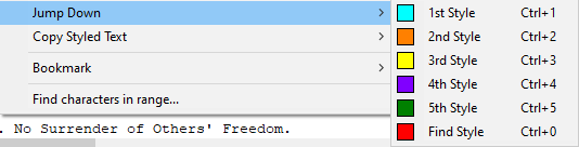

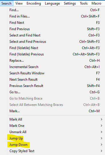

                                      Alan Kilborn @Sridhar Raghavan
                                      @Sridhar-Raghavan
                                      I’m still unsure why you even need the bookmarks.
                                      Say you use the script to mark multiple pieces of text with multiple different colors.
                                      Then you can use the Jump Down (or Jump Up) commands on the Search menu to navigate to any color you’d like:
                                      Either one of these submenus contains the colors possible:
                                      So for example, say you mark some text (with the script) in the 5th style, i.e. default of green color. Then you may find occurrences of your marked text from you current position to the end of your file by repeatedly pressing Ctrl+5.
                                      No need for bookmarks of any type, or am I still misunderstanding your desires?
                                          @Sridhar-Raghavan said in Using Mark (Markers) and Styles:
                                          I am sure there would be additional operations may be invoked on “Bookmarked” lines, that can be very useful.
                                          Side Note. Like Copy Bookmarked Lines, Remove Bookmarked Lines, Remove Un Marked Lines.
                                          You mean these kinds of commands? (note red dot is right-click point):
                                            Note: Current Mark Panel has a “Copy Marked Text” button, but it only copies the “marked text” and not the lines. So you get a redundant list of the same text many times (except one is using regex).
                                            Yes, it often goes unstated here when people talk about Copy Marked Text, but it really is only useful when dealing with text that was marked by a regular expression search.
