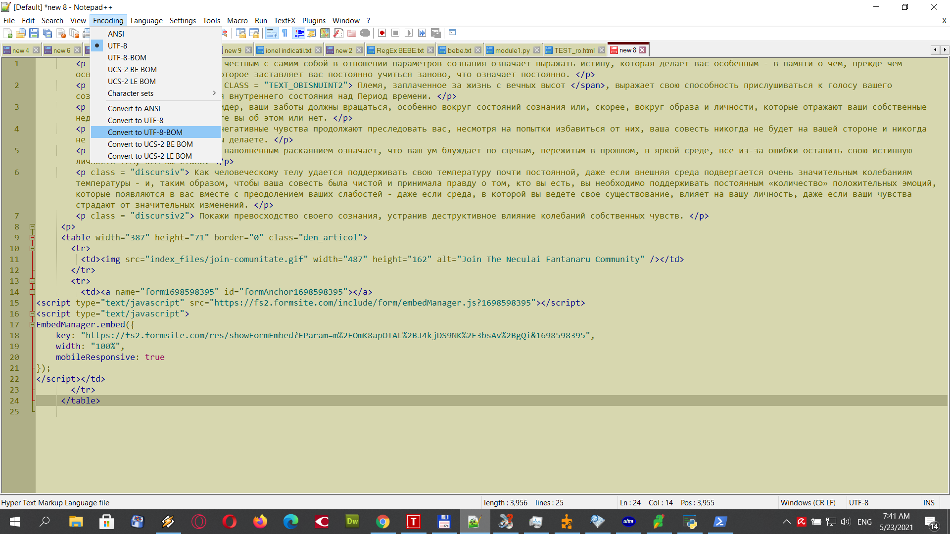

      hello, I have many txt files encoding on UTF-8. If I convert one by one to UTF-8-BOM, is ok. But I don’t have time to do this operation in all 800 txt files. Can it be done easier on all files?

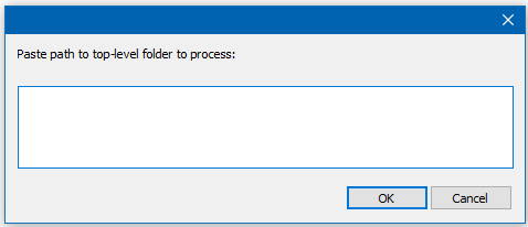

                    Here’s the PythonScript I had in mind:

                    When you run it it prompts you thusly:
                    and once you paste a folder name in there and press OK, it proceeds to add UTF-8 BOMs as necessary to all files in that folder hierarchy.

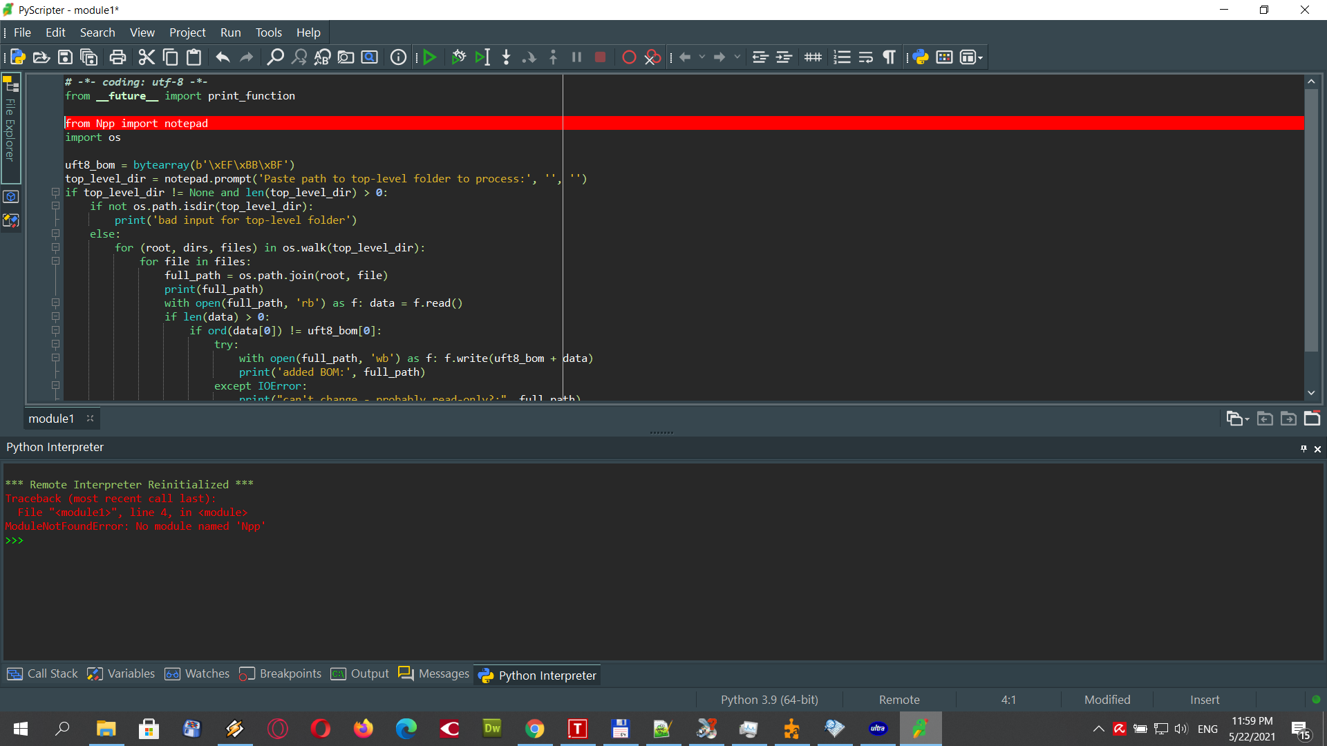

                        @Alan-Kilborn said in Change / Save encoding How to convert 800 txt files UTF-8 to UTF-8-BOM:
                        I got this error, after running the Python script
                          Alan Kilborn @Vasile Caraus
                          @Vasile-Caraus said in Change / Save encoding How to convert 800 txt files UTF-8 to UTF-8-BOM:
                          You’re probably not running it under the Notepad++ plugin called PythonScript.
                          Vasile CarausV 1 Reply Last reply Reply Quote 3

                              • Vasile CarausV
                                Vasile Caraus @Alan Kilborn
                                good morning @Alan-Kilborn Yes you are right. I had to use PythonScript from Notepad++. WORKS !! Thank you

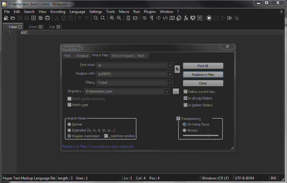

                                  Hi, @Vasile-caraus, @alan-kilborn and All,
                                  Oh, I’m really silly ! You just can do it with Notepad++, without any restriction !
                                  So, I assume that all your .html files, in your directory, are UTF-8 encoded ( and not UTF-8-BOM ! )
                                  In this case, here is the road map :
                                  • First back-up the directory containing all the .html files to modify ( Wise ! )
                                  • Start Notepad++
                                  • If some .html files, located in this specific directory, are opened in N++, it’s best to close all these files
                                  • Now, open the Find in Files dialog ( Ctrl + Shift + F )
                                    • SEARCH \A
                                    • REPLACE \x{FEFF}
                                    • FILTERS *.html
                                    • DIRECTORY Your SPECIFIC folder
                                    • Tick the Regular expression search mode
                                    • Click on the Replace in Files button
                                    • Confirm the Are you sure? dialog
                                  Voila ! Now, all your .html files, in this specific folder, should be UTF-8-BOM encoded ;-))
                                  P.S. :
                                  Note that the opposite manipulation of changing a UTF-8-BOM encoded file to an UTF-8 encoded file is always impossible with a regex !
                                  Indeed, as the \A is the location between the BOM ( The three bytes \xEF\xBB\xBF ) and the very first byte of your UTF-8-BOM file, you cannot delete the Byte Order Mark with a regex !!
                                  Hellena CrainicuH 1 Reply Last reply Reply Quote 3

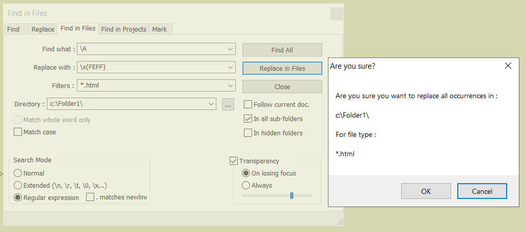

                                  • Vasile CarausV
                                    Vasile Caraus
                                    @guy038 said in Change / Save encoding How to convert 800 txt files UTF-8 to UTF-8-BOM:
                                    \x{FEFF}
                                    hello @guy038
                                    I test your solution, this is the print screen. I can tell you that is not working. Nothing is change. Only the Python script of @Alan-Kilborn WORKS !
                                      @guy038 's solution works for me.
                                      But, it has some problems:
                                      • it doesn’t check to see if a BOM is present before adding one
                                      • if run multiple times it will keep inserting more and more BOM byte sequences at the start of file
                                      So, if you’re sure that NONE of your files already has a BOM, it seems like the regex replacement approach will work.

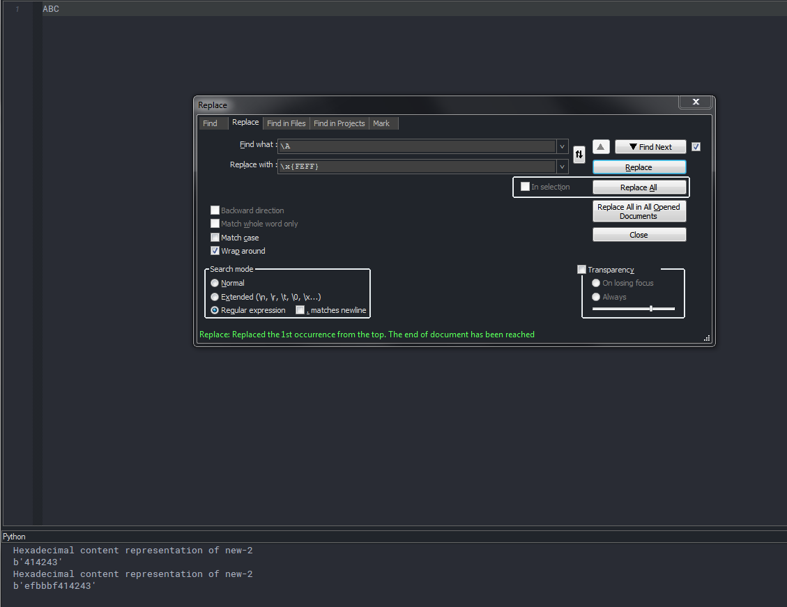

                                      • Vasile CarausV
                                        Vasile Caraus
                                        \A
                                        Indeed. @guy038 solution is good. Except if I press CANCEL for the first times. So, as to work, after I press “Replace All” I must also press OK immediate, not cancel it and again press “Replace All” and Ok
                                          @Vasile-Caraus
                                          If you end up with extra BOM sequences at the start of your files, you won’t see them. They’ll be zero-width-non-breaking-spaces. They’ll be there, but you won’t know it. I don’t know what that will do to the “integrity” of your files, probably nothing. But I always like to know what’s in my files.
