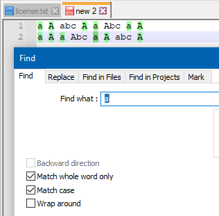

      1. When a “Find” window pops up, you enter ‘a’ with both the selection box “Match Whole Word Only” and the selection box “Match Case” checked, press the button “Find Next”, all ‘a’, ‘A’ appearing in any words will become colored of green and whole ‘A’ will show a slightly different green color indicating they are selected.
      The correct operation should be that only the whole ‘A’ should be in green color and others are not color changed. In other words, only strings which is fully in an agreement with the selections should be colored.
      It causes inconvenient consequences, but not an error.

        For 1, you mean this effect?:
        If so, you are confusing two features of Notepad++.
        Note that at this point, you haven’t actually done any “Find” yet (Find doesn’t use the light-green color).

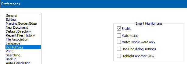

        Smart Highlighting is the feature that uses the light-green coloring.
        It becomes active when some text is selected (which is what happens if your caret is on some text when you invoke Find).
        Smart Hightlighting behavior options are set in the Preferences here:

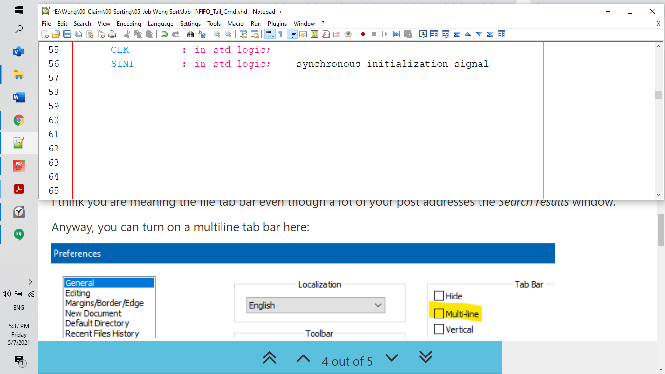

          b. When the number of opened files exceeds 8, one must continuously press the left or right icon to shift file names in and out. When a project has more than 10 files to edit, it is a real headache!
          I think you are meaning the file tab bar even though a lot of your post addresses the Search results window.

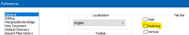

          Anyway, you can turn on a multiline tab bar here:

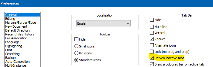

          c. File names in file items are gray colored and their texts except for the currently opened file are difficult to recognize.
          Try changing this setting:

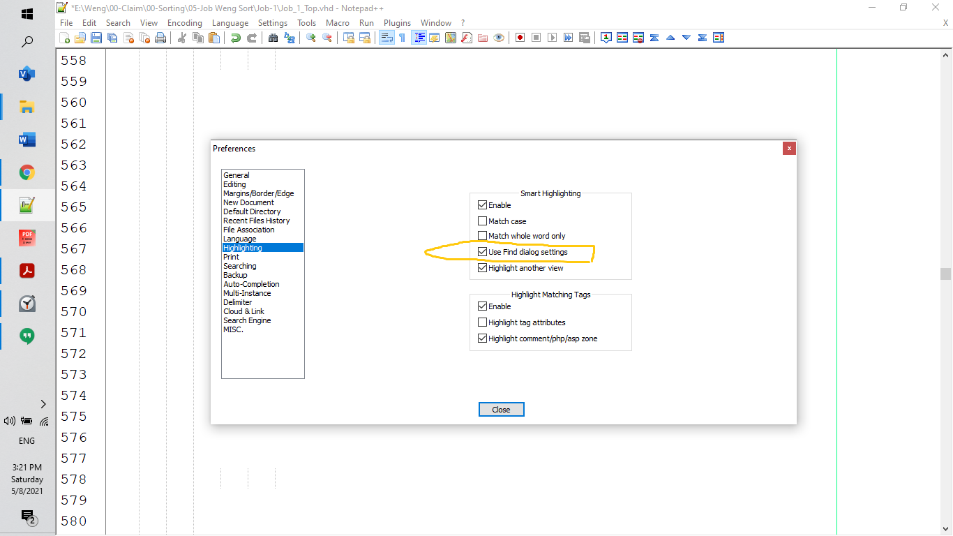

                    If you don’t like the light-green, you can turn off Smart Highlighting by unticking its Enable.
                    Maybe best to do for your case would be to tell Smart Hightlighting to Use Find dialog settings so that you won’t have a difference.

                      Smart highlighting function works excellent, and I find that check Setting --> Preference --> Highlighting --> Use Find Find Dialog Seeting resolves my problem!
                      So now I have 1 problem to be resolved: Download Navigate plugin.

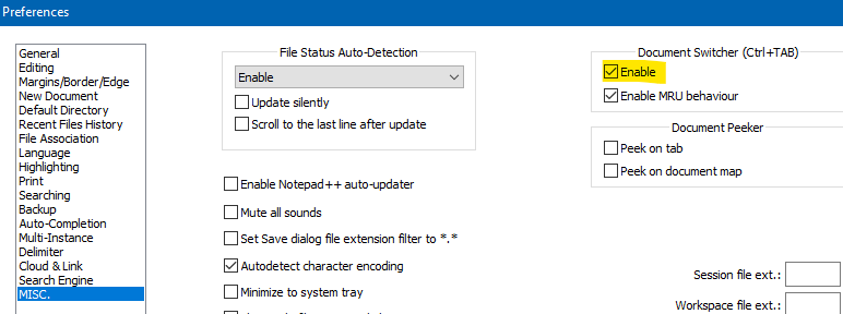

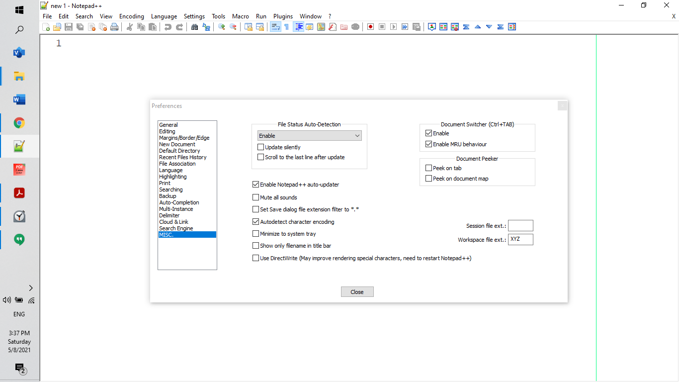

                        Your “Ctrl+Tab” method works differently from mine; pressing “Ctrl+Tab” in my case it switches to the first file, and then back and forth, no list tables you show appears.
                        You might want to check this setting, although I believe it should be enabled by default:
                        W TXW 1 Reply Last reply Reply Quote 0

                          @Alan-Kilborn It is the default setting and I do not change it.

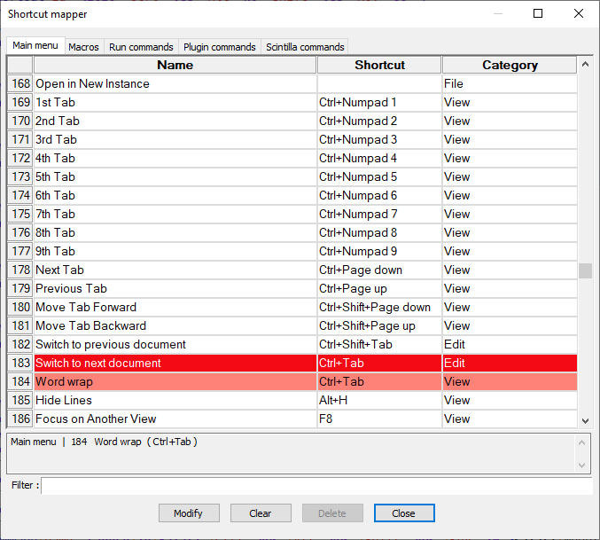

                            So I discovered something odd.

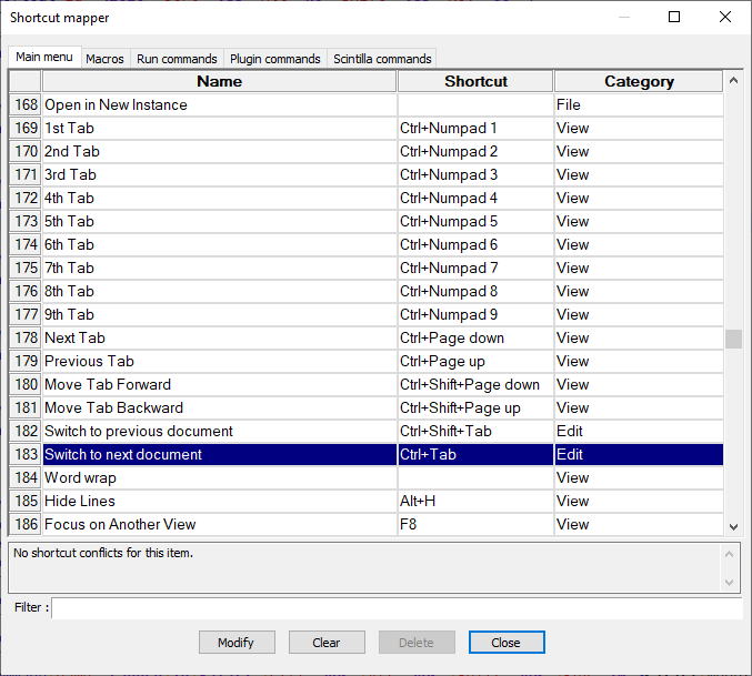

                            “Ctrl+Tab” seems to also be defined in the Shortcut Mapper:
                            Your “Ctrl+Tab” seems to be working like the one from Shortcut Mapper, and not like mine.
                            Sorry, I don’t know why this is. :-(
                            Maybe if you unmap it in Shortcut Mapper it would then work like mine to give you the yellowish popup list of tabs?
                            PeterJonesP W TXW 2 Replies Last reply Reply Quote 0
                              @Alan-Kilborn said in 2 improvements!:
                              I don’t think so… at least, not for me. Mine works like yours. If I unmap it in Shortcut Mapper, then Ctrl+TAB does not pull up the document switcher.
                              If I switch the shortcut to something like Ctrl+F12, then Ctrl+F12 pulls up the document switcher, but I have to hold down Ctrl and switch to Ctrl+TAB to cycle through (or Ctrl+arrows to control the up/down direction)

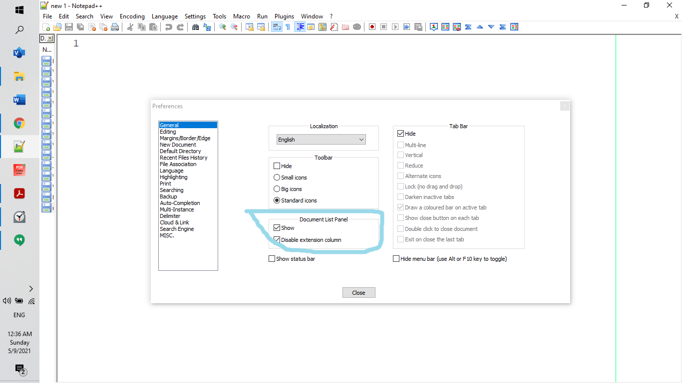

                                @Alan-Kilborn Thank you!
                                The problem seems to be fully resolved by using the following method which I accidentally come across.
                                I check the “Show Document List” box, a full document list is shown on the left side of the main edit window, and the full document window can be expanded or contracted as one wants. So I now can fully hide the document window; if I want to use it, I can expand it, select the next document, and hide it again.
                                The only improvement I hope for the document window is that one can divide the file list into groups by dragging files up or down and insert blank lines among groups.
