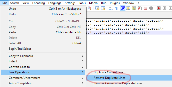

                                        Alan Kilborn @Ramanand Jhingade
                                        @Ramanand-Jhingade said:
                                        I would like all the matter/characters between the < and > which have duplicates to be removed.
                                        For example…
                                        @Terry-R said
                                        From those examples I can say that the original solution I linked … along with … subsequent line numbering and reversing should do that.
                                        I’m confused why this command was not recommended for this task, given the example data provided:
                                          Terry R @Alan Kilborn
                                          @Alan-Kilborn OP wants to use “Replace” in single mode, presumably to verify each removal. And considering he also has the {} characters to contend with I don’t blame him.
