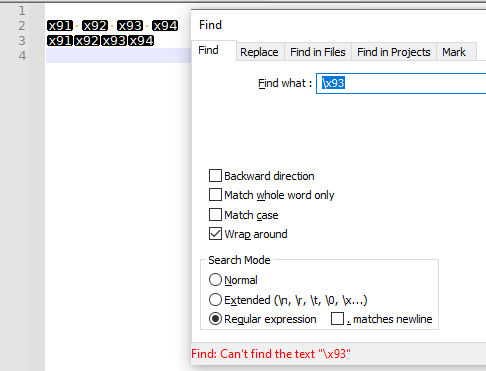

      Thank you for doing screenshots. Unfortunately, you didn’t pay attention to my request or look at my example screenshots, because your screenshots did not show the Notepad++ status bar at the bottom of the window, so there was no proof of the encoding. I will just have to take your word for “the encoding is already UTF 8”, whereas if you had done what I asked, it would have been included in the screenshots, so I could be sure. Further, you didn’t understand that my request wanted you to show a screenshot at each of the four steps of the procedure I gave you, just like my example gave four screenshots, one at each of the four steps.
      The encoding is already UTF 8, so how to find and replace the unrecognized characters?
      You appear to be not understanding my posts and screenshots.

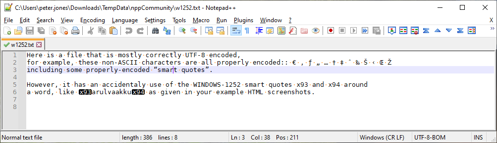

      Did you notice in my #1 screenshot above, shown again here:
      … that the “encoding is already UTF 8” – you can see this in the lower-right corner, in the Notepad++ status bar; that’s the reason I included the status bar in my screenshot, and why I asked you to include the status bar in your screenshot.
      The fact that the “encoding is already UTF 8” was the whole point of what I was trying to show you: Notepad++ thinks the encoding is UTF-8, but it has run across the x91x92x93x94 bytes which are not valid UTF 8 encoded characters – so you have badly-formed UTF-8.

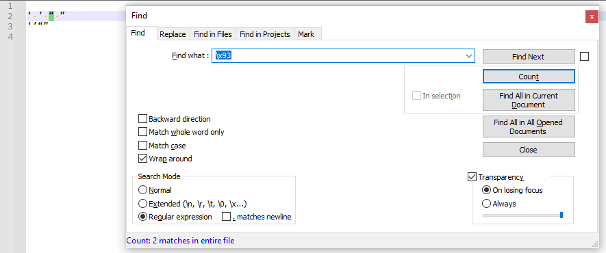

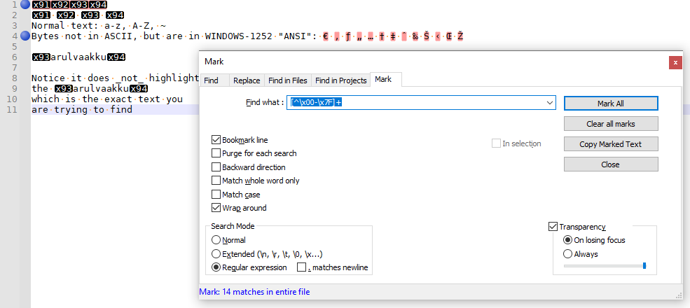

      which suggests that you use [^\x00-\x7F]+. That would work, if you were in ANSI or one of the character-set encodings. But if your file is interpreted as UTF-8, then search will not find any such codepoints, because the bytes x93 and x94 are not properly encoded characters, so the search function does not always find them. See this example:
      Notice how the only two lines bookmarked are the first (where the bytes run into each other, so that the high bytes at least match the UTF-8 requirement of having multiple 0x80-0xFF bytes adjacent to each other, rather than with non-high-bit characters like a space between) and the fourth (where there are other non-ASCII but validly-encoded UTF-8 characters); it does not match line 2 (where the bytes are space separated).
      Trying to find a search in Notepad++ to find invalidly-encoded characters is hard, because the Notepad++ search function assumes your data is properly encoded in whatever encoding Notepad++ is currently set to.

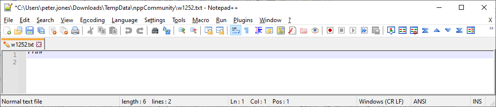

      However, I did some more experimenting, and found a procedure that should work without ruining other UTF-8 text, and just fix the poorly-encoded smart quotes.

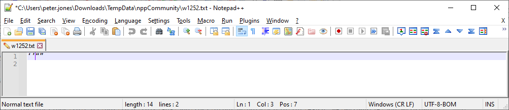

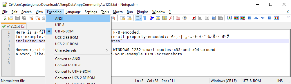

      1. Verify that the status bar and/or Notepad++ Encoding menu currently is selected on UTF-8 or UTF-8-BOM

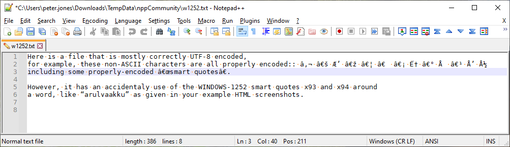

      2. Use Encoding > ANSI to convince Notepad++ that your bytes are ANSI, not UTF-8.
        1. Before: 79c6d537-3efd-4078-a6e5-de032d2b631d-image.png
        2. After: 768408a9-8e20-4500-b37f-a172cc33ae7d-image.png
        3. You will notice that the “good” characters currently “look” wrong. Don’t worry about that for now. Trust me. But now “arulvaakku” looks right
        _WARNING: If you are not showing as “ANSI” encoding before starting step 3, you have not followed my instructions and this will not work! Step 2 will get you to the right point, but only if you have followed by instructions.

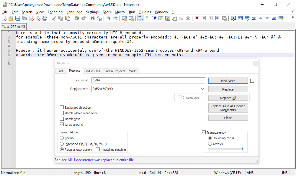

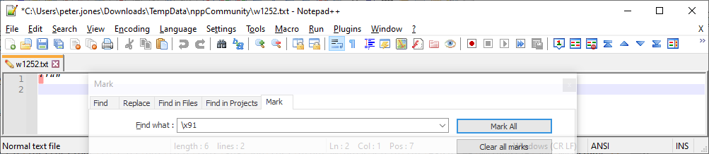

      3. Do a couple of search/replace. These four will change all single and double smart quotes into the correct three-byte sequence. (use regular expression search mode for all search/replace below)
        1. search \x91 replace \xE2\x80\x98
        2. search \x92 replace \xE2\x80\x99
        3. search \x93 replace \xE2\x80\x9C
        4. search \x94 replace \xE2\x80\x9D

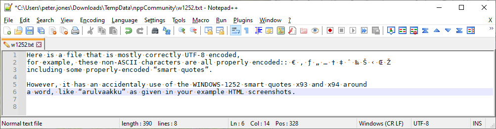

        At this point, it will look “worse”, but that’s okay. Trust me. ed37959f-afd0-4854-ab01-0def66fc86ad-image.png

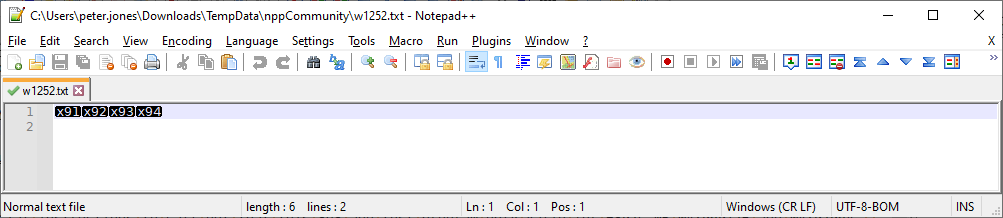

      4. Use the Encoding > UTF-8 to tell Notepad++ to re-interpret the file as if the bytes were UTF-8, which is what you want. At this point, everything looks good:
      5. SAVE

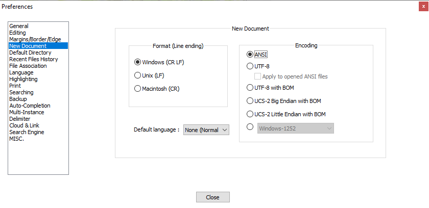

      1. Settings > Preferences > New Document: a9035066-10fa-4947-8960-9057f194e036-image.png
        • Set “Encoding” to either “ANSI” or “Windows-1252”
        • Make sure “Apply to opened ANSI files” is not checked

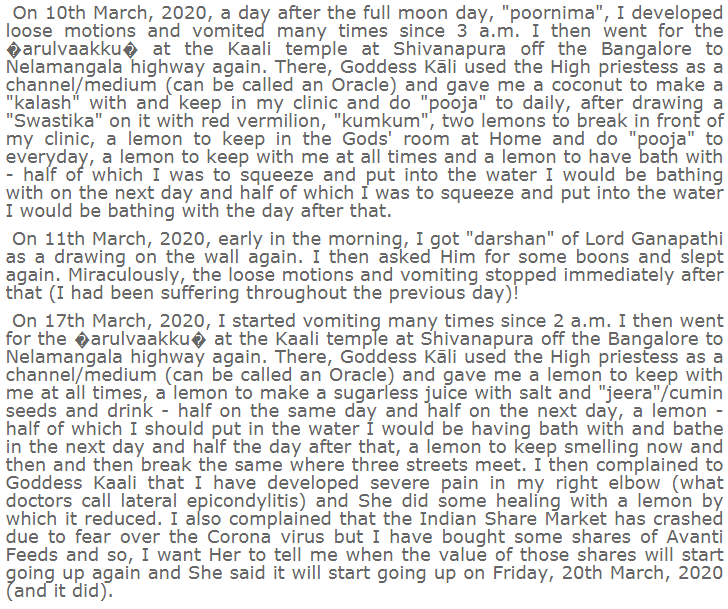

        Vasile showed it working for the bytes � (which is the UTF-encoding for �) because that was the focus of that previous discussion. But it will likely also work if you wanted to replace \x93 with “ and \x94 with ” – and might be easier for you to figure out than iconv or command-line grep.
        Given your requirements, grepWin may be the best tool for you for this particular smart-quote problem. (if you have grepWin questions, you will need to find a grepWin forum or other generic help site, because the Notepad++ Community is focused on Notepad++)

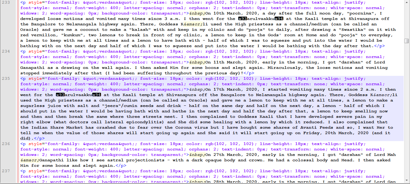

          @PeterJones I finally found a solution here: how-to-find-non-ascii-unprintable-characters-using-notepad-plus-plus
          We have to select the Regular expression mode and search/find with this code: [\x00-\x08\x0B\x0C\x0E-\x1F\x7F-\x9F]
          I will do the replacements one by one instead of using “Replace all”
          Ramanand JhingadeR PeterJonesP 4 Replies Last reply Reply Quote 1

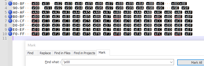

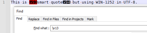

                      It didn’t make sense to me that \x93 wouldn’t find “ but that [\x00-\x08\x0B\x0C\x0E-\x1F\x7F-\x9F] would. In an ANSI-encoded file, that search makes perfect sense, because those bytes aren’t in ASCII or extended-ASCII. But in a UTF-encoded file, those bytes aren’t valid unless they are part of a multi-byte UTF-8 encoding sequence.
                      So I started cutting parts out of that expression until I narrowed it down to what’s matching: \x13 matched the x93 byte.
                      With a UTF-8 encoded file that has bad bytes with the MSB set that don’t get interpreted as part of a multi-byte UTF-8 character sequence, the following appears true:
                      For example:
                      So I built up a test file , and started doing searches:
                      • searching \x00 matches many, including x80, xA0, xB0, xB8, xBC, xBE, xC0, xE0, xF0, xF8, xFC, xFE
                      • searching \x01 matches eight, including x81, xA1, xB1, xB9, xBD, xC1, xE1, xF1, xF9, xFD
                      • searching \x02 matches eight, including x82, xA2, xB2, xBA, xC2, xE2, xF2, xFA
                      • searching \x03 matches eight, including x83, xA3, xB3, xBB, xC3, xE3, xF3, xFB
                      • searching \x04 matches six, including x84, xA4, xB4, xC4, xE4, xF4
                      • searching \x05, \x06, and \x07 each match the seven in the same pattern as \x04
                      • searching \x08 only matches four, including x88, xA8, xC8, xF8 . \x09 works analogously
                      • searching \x0A matches that same pattern of four, but also matches all the line-feed character in the EOL sequences
                      • searching \x0B and \x0C each match four, including x8B, xAB, xCB, xFB, x8C, xAC, xCC, xFC,
                      • searching \x0D matches the pattern of four, and all the carriage returns in the EOL sequences
                      • searching \x0E matches the pattern of four: x8E, xAE, xCE, xEE
                      • searching \x0F matches three of the four (but my file didn’t have x8F to match against)
                      • searching \x10 matches two: x90 and xD0. \x11, \x12, \x13, \x14, \x15, \x16, \x17, \x18, \x19, \x1A, \x1B, \x1C, \x1D, \x1E, \x1F all match the two entries from the 90 and D0 rows.

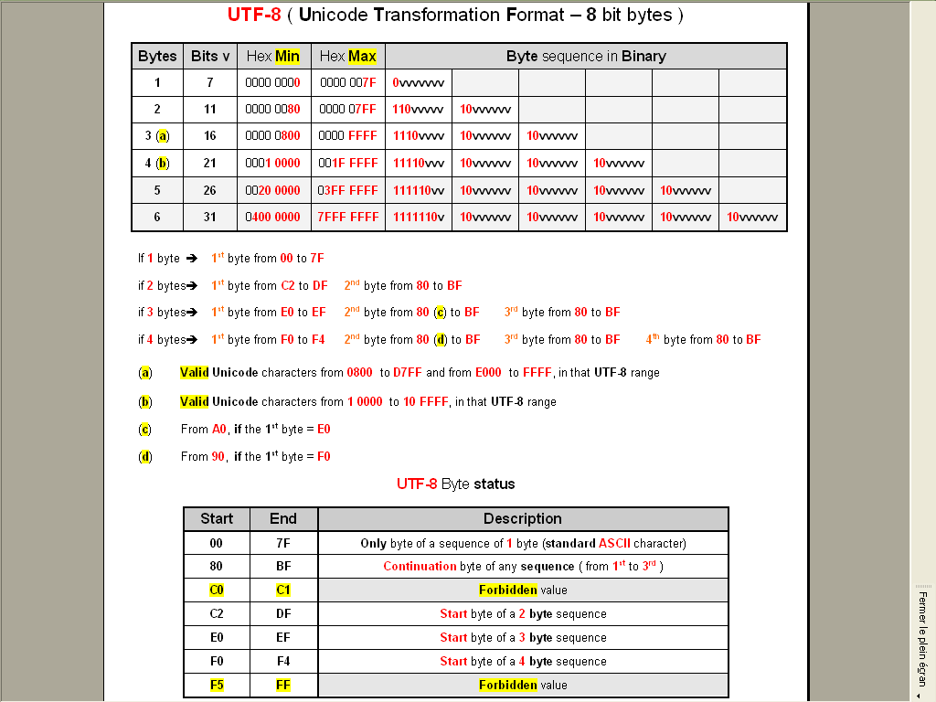

                        As a remainder, here is, in a picture, some pieces of information about the UTF-8 encoding :
                        Best Regards
                          Alan Kilborn @guy038
                          @guy038 said in How to find and replace unrecognizable characters in multiple files of a folder with the correct character using Notepad ++?:
                          That’s a nice reference. Where is it from?
                          I’ve just been using Wikipedia’s similar pictorial reference --> HERE.
                            Hi, @alan-kilborn and All,
                            No, just a personal presentation, in a Word document, of some parts of this article that I made some years ago, to fully understand the UTF-8 encoding ;-))
                            My first table is simply the extension to the complete UTF-8 encoding of the Unicode table, seen here, which is able to encode all the Unicode characters ( 1,114,112 )
                            With the complete UTF-8 encoding, up to six bytes, it can represent up to 134,217,728 characters ( so from U+0 to U+7FFFFFF )
                            As you can see, no problem for UTF-8 to encode all characters used in the different inhabited worlds of the galaxy !!!
                            And my second table is simply an other presentation of this one, on Wikipedia
