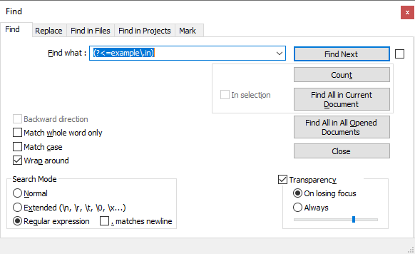

        I’d actualy combine the first two steps to be a single regular expression, like FIND=(?<=example\.in), which finds the text example.in, but will leave the cursor after that text.
        If you wanted to record this macro yourself, you would
        1. Macro > Start Recording
        2. Search > Find (or Ctrl+F), and set
          FIND = (?<=example\.in)
        3. Find Next
        4. Close
        5. type the / key
        6. Edit > Copy to Clipboard > Current Filename to Clipboard
        7. Edit > Paste (or Ctrl+V)
        8. Macro > Stop Recording
        9. Macro > Save Current Recorded Macro, and give it a name (like Append Filename to example.in).
        Now, to use that macro, open up the next file you want to edit, use Macro > Append Filename after example.in, and it will run it for you. You will have to open each file and run that macro.
