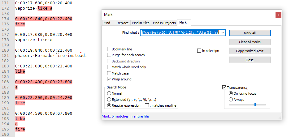

                    @Alan-Kilborn Thanks again. I see you are helping many other people so I should have put a summary in to help you :-)

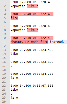

                    The problem
                    1-Simple Find and replace with a list of words (your most recent code does this)
                    2-Find and replace multi-word string that goes across a timestamp
                    Find “like a fire” replace with $2liquefy
                    0:00:17.680,0:00:20.400
                    vaporize like a
                    0:00:19.840,0:00:22.400
                    fire
                    I would like to combine the most recent code with this one (minus the manual entry box so it could use the list as in your most recent code) to search across the time stamp.
                    -- coding: utf-8 --
                    from Npp import editor, notepad
                    class T1(object):
                    def __init__(self):
                        search_phrase = 'like a fire'
                        while True:
                            search_phrase = notepad.prompt('\r\nEnter search phrase and press OK to find next:', '', search_phrase)
                            if search_phrase == None or len(search_phrase) == 0: return  # quit
                            word_list = search_phrase.strip().split()
                            regex = r'(?-is)(?(DEFINE)(\x20|\R|\R*\d{1,2}:.*\R))' + '(?1)'.join(word_list)
                            matches = []
                            editor.research(regex, lambda m: matches.append(m.span(0)), 0, editor.getCurrentPos(), editor.getLength(), 1)
                            if len(matches) == 0:
                                notepad.messageBox('No (more) matches', '')
                                return
                            else:
                                (match_start, match_end) = matches[0]
                                editor.scrollRange(match_end, match_start)
                                editor.setSelection(match_end, match_start)
                    if name == ‘main’: T1()
                    Thanks again :-)

                        @Alan-Kilborn Hi, I’m a beginner and was just using the $2 that astrosofista suggested in this post so I don’t fully understand it.
                        He suggested
                        Search: (?x-s) \x20like (\x20 | \R | \R* \d{1,2} : .*\R) a ((?1)) fire
                        Replace: $2liquefy
                        If I don’t use the $2 before the replacement word then the timestamp is removed in the replacement. I tried $1 and $3 before the replacement word as a test and the time stamp was removed in both cases.
                        Putting the replacement expression in the second part of the string (second timestamp) is preferable as it is the most likely scenario.
                        Just one bridged time-stamp is the basic requirement, in the future I might look at across multiple time-stamps.
                        There a blank line between the timestamp/phrase as in the example below.
                        $1, $2, $3, would not be present in the text so ok to use in our expression.
                        Find “like a fire” replace (end of expression) with liquefy
                        vaporize like a
                        fire
                        0:00:22.400,0:00:24.300
                        next phrase
                        Thanks :-)

                            Hello, @maximillianm, @peterjones, @alan-kilborn, @astrosofista and All,
                            @maximillianm, I assume that the timestamp always begins lines of your file, without any leading blank characters ! If it’s not the case, just tell me !
                            Here is a generic regex which searches any range of text, containing one timestamp feature, and replace it with any range of text, still containing the same timestamp
                            SEARCH (\R+\d{1,2}:\d\d:\d\d\.\d{3},\d{1,2}:\d\d:\d\d\.\d{3}\R)(*F)|(?-i)Before_Find_Text((?1))After_Find_Text
                            REPLACE Before_Replace_Text\2After_Replace_Text
                            where :
                            • Before_Find_Text represents the text to search, located BEFORE the time-stamp line
                            • After_Find_Text represents the text to search, located AFTER the time-stamp line
                            • Before_Replace_Text represents the text to replace BEFORE the time-stamp line
                            • After_Replace_Text represents the text to replace AFTER the time-stamp line
                            First example :
                            Given your initial text :
                            vaporize like a
                            fire
                            And the expected result :
                            vaporize
                            liquefy
                            The different variable parts of the generic regex S/R are :
                            • Before_Find_Text = vaporize like a
                            • After_Find_Text = fire
                            • Before_Replace_Text = vaporize
                            • After_Replace_Text = liquefy
                            which gives the functional regex S/R :
                            SEARCH (\R+\d{1,2}:\d\d:\d\d\.\d{3},\d{1,2}:\d\d:\d\d\.\d{3}\R)(*F)|(?-i)vaporize like a((?1))fire
                            REPLACE vaporize\2liquefy

                                    I could parse the list (or a separate list might be easier) so the scripted search/replace could use what is the most common situation
                                    the_list = [
                                    ‘:like a fire:vaporize’,
                                    REPLACE vaporize on second line
                                    With that my original problem would be solved and then I could experiment with Guy’s regex for the next scenario.
                                    Thanks again. You really know your stuff and I so appreciate your support!

                                        So in attempting to get something to work, I’ve come up with the following regular expression replacement (generated via code):
                                        find: (?(DEFINE)(?<TS>\d{1,3}:\d{2}:\d{2}\.\d{3},\d{1,3}:\d{2}:\d{2}\.\d{3}))like(?<RE>\x20|\R|\R*(?<TSLINE>(?P>TS))\R)a(?P>RE)fire
                                        repl: it so that it will \r\n\r\n$+{TSLINE}\r\nliquify
                                        And running it on this data:
                                        vaporize like a
                                        fire
                                        vaporize like a
                                        fire
                                        Should produce this result:
                                        vaporize it so that it will
                                        liquify
                                        liquify
                                        But it is ignoring my use of $+{TSLINE} in the replace expression and produces the following:
                                        liquefy
                                        liquefy
                                        It is working fine in the Boost emulation mode for RegexBuddy, just not in Notepad++.
