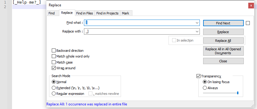

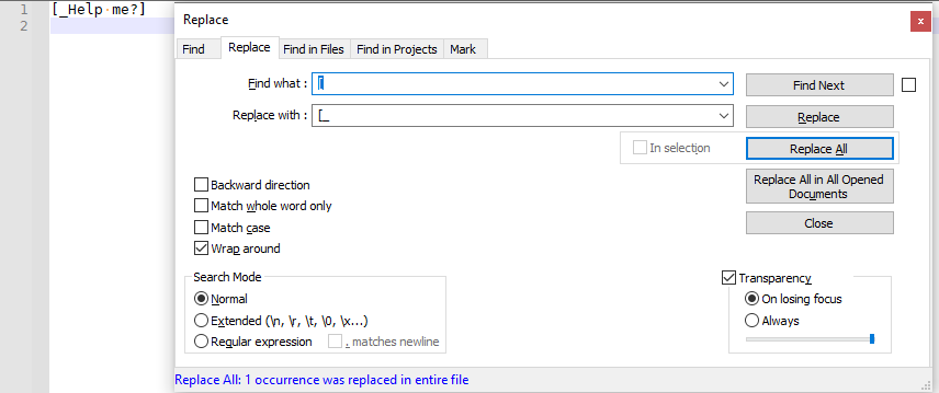

            I would do a Normal Search Mode replacement of [ with [_ followed by a replacement of ] with _].

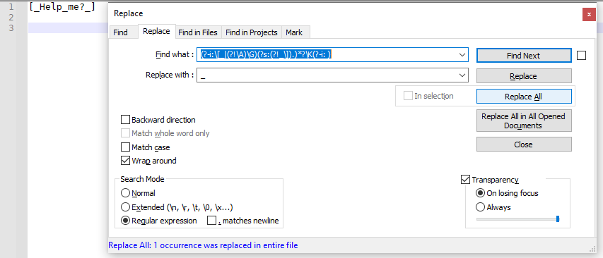

            Then I would employ the technique (in Regular expresssion Search mode) shown HERE where:
            • BSR = bs[_
            • ESR = _bs]
            • FR is a space
            • RR = _
            Note: substitute bs in the above with \ !

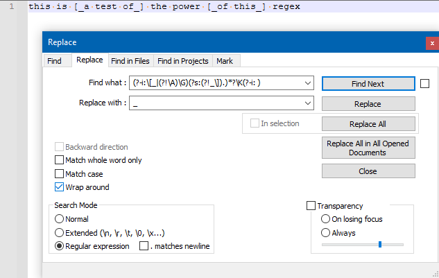

                      • What is the generic expression? From the post that was linked,
                        • You would then put the value of BSR that Alan and I gave above into the expression in the image, and similarly for ESR, FR, and RR.
                        • Finally, you would enable “regular expression” and run this final regular expression:

                      #begin_spoon_feeding

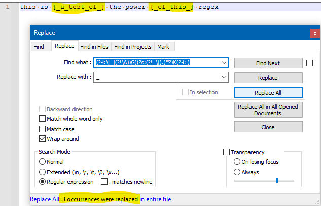

                      From the linked posting:
                      SEARCH (?-i:BSR|(?!\A)\G)(?s:(?!ESR).)*?\K(?-i:FR)
                      REPLACE RR
                      Substituting in our values for BSR/ESR/FR/RR, that I enumerated above, yields:
                      SEARCH (?-i:bs[_|(?!\A)\G)(?s:(?!_bs]).)*?\K(?-i: )
                      REPLACE _
                      Note: this site has trouble with backslash followed by [ or ], so the above still uses bs for backslash, but when put correctly into Notepad++ it looks like this in the Find what box:
                      And running a Replace All results in:
                      #end_spoon_feeding
