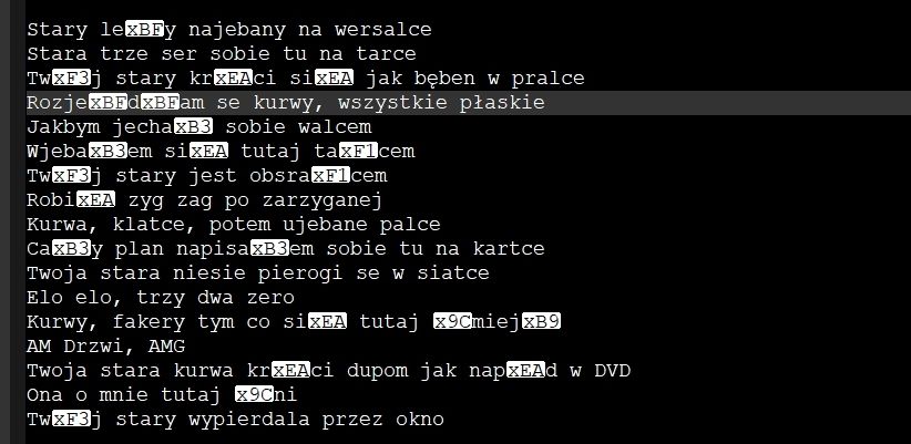

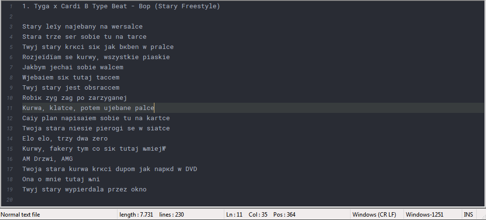

      @Ekopalypse when i try to encode to that u mentioned the letter ‘k’ is changed to ‘к’ so its cant be cyrlic encrypted before

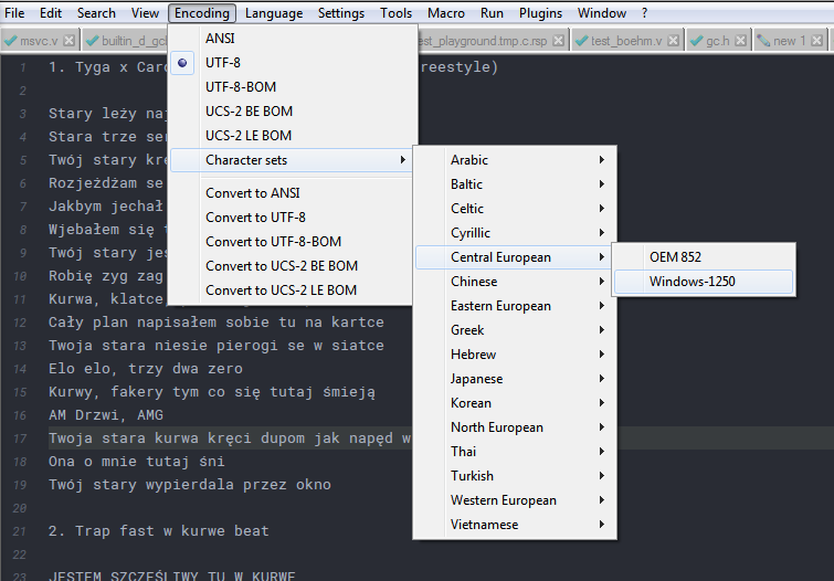

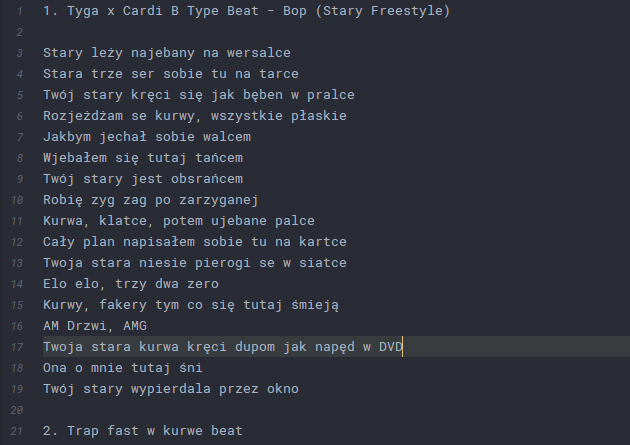

          @Ekopalypse ye, its looks now fine
            That means, select Windows-1250
            and if it looks ok - convert to utf8 - save it - done.
            nightzneroN 1 Reply Last reply Reply Quote 2
            • nightzneroN
              nightznero @Ekopalypse
              @Ekopalypse Thanks Eko a lot!

                      • Select the command Encoding > Character Sets > Central European > Windows-1250
                      => All the text seems, now, completely readable ;-))
                      • So, encode this file with the UTF-8 encoding, running one of these two commands :
                        • Encoding > Convert to UTF-8
                        • Encoding > Convert to UTF-8-BOM
                      • Save the changed contents ( Ctrl + S )
