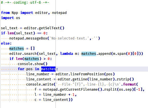

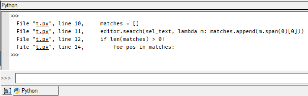

        A possibility not involving color might be to show the matching text in this fashion:
          File "t.py", line 10,     matches = []
          File "t.py", line 11,     editor.search(sel_text, lambda m: matches.append(m.span(0)[0]))
          File "t.py", line 12,     if len(matches) > 0:
          File "t.py", line 14,         for pos in matches:

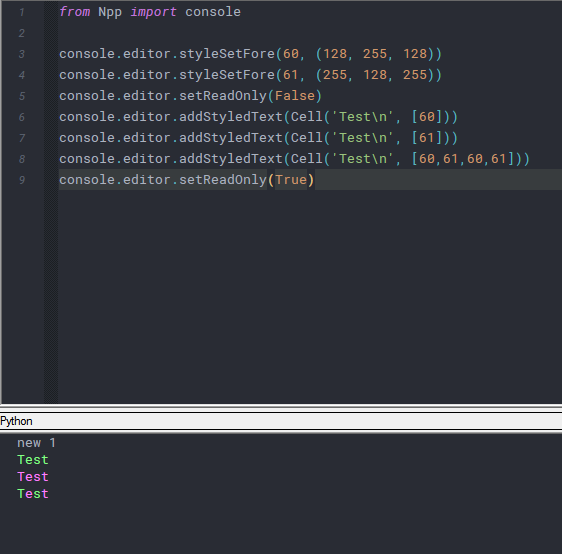

          Ekopalypse @Anthony Blinco
          @Anthony-Blinco
          for example with something like this
          from Npp import console
          console.editor.styleSetFore(60, (128, 255, 128))
          console.editor.styleSetFore(61, (255, 128, 255))
          console.editor.setReadOnly(False)
          console.editor.addStyledText(Cell('Test\n', [60]))
          console.editor.addStyledText(Cell('Test\n', [61]))
          console.editor.addStyledText(Cell('Test\n', [60,61,60,61]))
          console.editor.setReadOnly(True)

              Thanks for the addStyledText() tip. I can get it to work for my purposes but it doesn’t seem to register for the click-and-goto-line functionality when i use it to print text.
