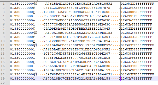

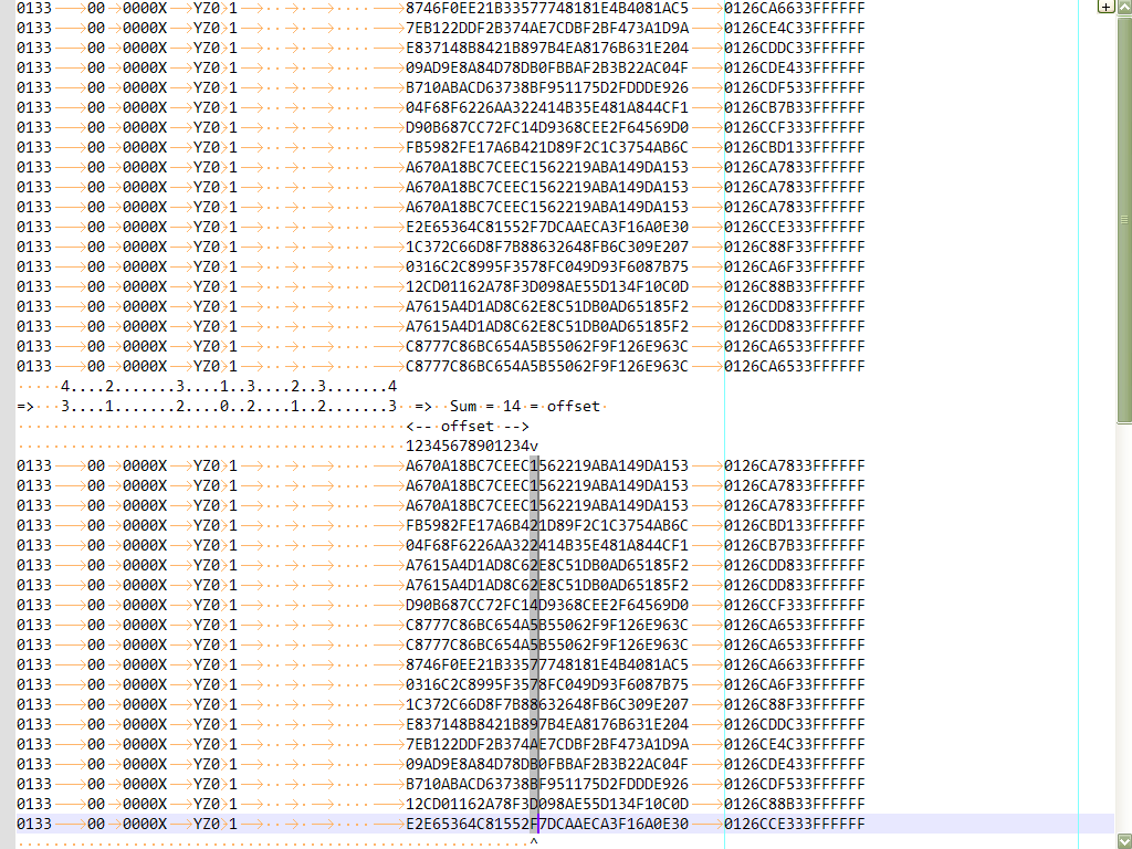

      I can duplicate @guy038 's sorting problem.
      I’m sure it has to do with a tab being one character but being treated – or mistreated, as you like – as more than one.
      It “throws” off the column used as the sort key.
      I’m sure if one really looked hard at Guy’s bad results, the pattern could be detected (I’m not going to do that).
      Probably some code is “position” based but other code is “(effective) column” based.
      It might be interesting to see if other ill-effects occur in this type of sorting situation when variable multibyte UTF+8 characters, rather than tabs, are involved.

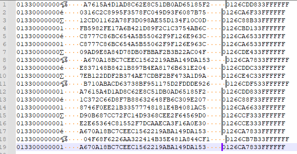

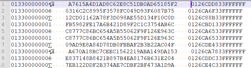

          Hello, @petr-jaja, @peterjones, @astrosofista, @alan-kilborn and All,
          Well, it’s going worse than I initially thought ! And the @alan-kilborn’s assumptions are certainly true, as well !
          First, for nice testing, you must use, at least, the v7.9 release, which corrects some sorting problems ( but not all, apparently ! ) when using the column mode selection !
          So, let’s consider this initial text, below, where I changed the last char of the string 013300000001, beginning the lines

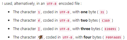

          I used, alternatively, in an UTF-8 encoded file :
          • The character 1, coded in UTF-8, with one byte ( 31 )
          • The character é, coded in UTF-8, with two bytes ( C3A9 )
          • The character ∑, coded in UTF-8, with three bytes ( E28891 )
          • The character 🦅, coded in UTF-8, with four bytes ( F09FA685 )
          01330000000🦅    A7615A4D1AD8C62E8C51DB0AD65185F2	0126CDD833FFFFFF
          01330000000é    0316C2C8995F3578FC049D93F6087B75	0126CA6F33FFFFFF
          01330000000∑    12CD01162A78F3D098AE55D134F10C0D	0126C88B33FFFFFF
          013300000001    FB5982FE17A6B421D89F2C1C3754AB6C	0126CBD133FFFFFF
          01330000000é    C8777C86BC654A5B55062F9F126E963C	0126CA6533FFFFFF
          013300000001    C8777C86BC654A5B55062F9F126E963C	0126CA6533FFFFFF
          01330000000∑    09AD9E8A84D78DB0FBBAF2B3B22AC04F	0126CDE433FFFFFF
          01330000000🦅    A670A18BC7CEEC1562219ABA149DA153	0126CA7833FFFFFF
          01330000000é    E837148B8421B897B4EA8176B631E204	0126CDDC33FFFFFF
          01330000000∑    7EB122DDF2B374AE7CDBF2BF473A1D9A	0126CE4C33FFFFFF
          01330000000🦅    B710ABACD63738BF951175D2FDDDE926	0126CDF533FFFFFF
          013300000001    A7615A4D1AD8C62E8C51DB0AD65185F2	0126CDD833FFFFFF
          01330000000é    1C372C66D8F7B88632648FB6C309E207	0126C88F33FFFFFF
          013300000001    8746F0EE21B33577748181E4B4081AC5	0126CA6633FFFFFF
          01330000000∑    D90B687CC72FC14D9368CEE2F64569D0	0126CCF333FFFFFF
          013300000001    E2E65364C81552F7DCAAECA3F16A0E30	0126CCE333FFFFFF
          01330000000é    A670A18BC7CEEC1562219ABA149DA153	0126CA7833FFFFFF
          01330000000🦅    04F68F6226AA322414B35E481A844CF1	0126CB7B33FFFFFF
          013300000001    A670A18BC7CEEC1562219ABA149DA153	0126CA7833FFFFFF

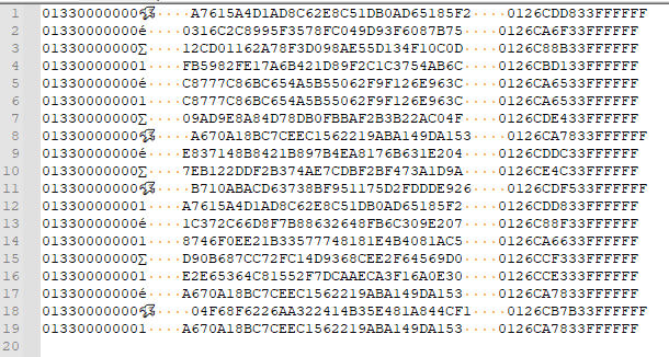

          With the v7.9.2 release, after doing a zero-length column-mode selection, at column 17, right before the MD5 checksums, through all the lines and running a usual Sort Lines Lexicographically Ascending, I got this text :
          As you can see, the MD5 strings seem to be sorted in two distinct ranges :
          • A first block of lines, containing the character with Unicode code-point over U+FFFF
          • A second block of lines, containing, only, characters with Unicode code-point under U+10000
          Again, I verified that, if I inserted these same characters, instead of the first char of the 0126... string, so after the MD5 values to sort, the bug does not occur and the MD5 checksums are correctly sorted !
          So, guys, I’ll probably create an issue, after your possible replies !

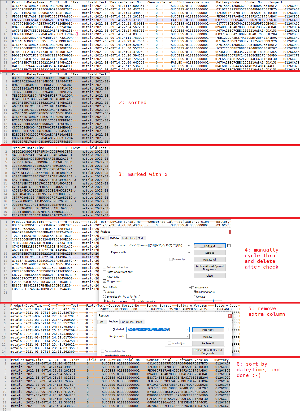

            PeterJones @guy038
            @Petr-Jaja ,
            Here’s a series of screenshots for the 6 steps, showing it in action

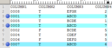

              Now, three options are possible :
              • You would like to get an idea of the different duplicate MD5 strings and lines which need future deletion ( option A )
              • You would like to delete the duplicate MD5 strings, one at a time, with the Replace button ( Option B )
              • You are rather confident about all the replacements to achieve . For instance, you have made a backup of your file ! ( Option C )
              Whatever the option chosen, remember to :
              • Tick the Wrap around option
              • Option A :
                  • SEARCH (?-s)^.*([[:xdigit:]]{32}).*\R(?:.*\1.*\R)+
                  • Tick the Bookmark line option
                  • Note that using the Search > Bookmark > Remove Bookmarked Lines option, you can also delete all the lines with duplicate MD5 strings !
              • Option B :
                  • REPLACE Leave EMPTY
                  • Click several times on the Replace button to delete the first duplicate blocks of lines
                  • If everything seems OK, you may click once on the Replace All button
                • After deletion of the lines with duplicates, with the options A or B, uses the following regex S/R to get rid of the temporary MD5 strings at beginning of lines ;:
                  • SEARCH (?-i)^(?!Product).+?\t(.)
                  • REPLACE \1
              • Option C :
                  • SEARCH (?-is)^.*([[:xdigit:]]{32}).*\R(?:.*\1.*\R)+|^(?!Product).+?\t(.)
                  • REPLACE ?2\2
                  • Click, just once, on the Replace All button
              Whatever the option A, B, or C used, we obtain that text :
              Product	Date/Time	C	T	H	Test	Field Test	Device Serial No	Sensor Serial	Software Version	Battery Code	Order No	Inspector
              metalo	2021-03-09T14:21:30.437178		0		SUCCESS	013300000001	0316C2C8995F3578FC049D93F6087B75	0126CA6F33FFFFFF	v2.7.1-UROB-20210112085121 (v8.7.1)
              metalo	2021-03-09T14:26:12.536780		0		SUCCESS	013300000001	04F68F6226AA322414B35E481A844CF1	0126CB7B33FFFFFF	v2.7.1-UROB-20210112085121 (v8.7.1)
              metalo	2021-03-09T14:22:34.567201		0		SUCCESS	013300000001	09AD9E8A84D78DB0FBBAF2B3B22AC04F	0126CDE433FFFFFF	v2.7.1-UROB-20210112085121 (v8.7.1)
              metalo	2021-03-09T14:21:44.398500		0		SUCCESS	013300000001	12CD01162A78F3D098AE55D134F10C0D	0126C88B33FFFFFF	v2.7.1-UROB-20210112085121 (v8.7.1)
              metalo	2021-03-09T14:24:50.557704		0		SUCCESS	013300000001	1C372C66D8F7B88632648FB6C309E207	0126C88F33FFFFFF	v2.7.1-UROB-20210112085121 (v8.7.1)
              metalo	2021-03-09T14:24:11.763923		0		SUCCESS	013300000001	7EB122DDF2B374AE7CDBF2BF473A1D9A	0126CE4C33FFFFFF	v2.7.1-UROB-20210112085121 (v8.7.1)
              metalo	2021-03-09T14:25:04.470269		0		SUCCESS	013300000001	8746F0EE21B33577748181E4B4081AC5	0126CA6633FFFFFF	v2.7.1-UROB-20210112085121 (v8.7.1)
              metalo	2021-03-09T14:24:23.617504		0		SUCCESS	013300000001	B710ABACD63738BF951175D2FDDDE926	0126CDF533FFFFFF	v2.7.1-UROB-20210112085121 (v8.7.1)
              metalo	2021-03-09T14:25:20.594258		0		SUCCESS	013300000001	D90B687CC72FC14D9368CEE2F64569D0	0126CCF333FFFFFF	v2.7.1-UROB-20210112085121 (v8.7.1)
              metalo	2021-03-09T14:25:48.726621		0		SUCCESS	013300000001	E2E65364C81552F7DCAAECA3F16A0E30	0126CCE333FFFFFF	v2.7.1-UROB-20210112085121 (v8.7.1)
              metalo	2021-03-09T14:23:54.831355		0		SUCCESS	013300000001	E837148B8421B897B4EA8176B631E204	0126CDDC33FFFFFF	v2.7.1-UROB-20210112085121 (v8.7.1)
              metalo	2021-03-09T14:21:53.262360		0		SUCCESS	013300000001	FB5982FE17A6B421D89F2C1C3754AB6C	0126CBD133FFFFFF	v2.7.1-UROB-20210112085121 (v8.7.1)
              Finally, select all lines, but the first header line, again and sort the lines with the Edit > Line Operations > Sort Lines Lexicographically Ascending menu command
              You should get your expected output :

                  Hi, @petr-jaja, @peterjones, @astrosofista, @alan-kilborn and All,
                  @astrosofista, thanks for your insight, but I worked on my side and I’ve found out a coherent explanation which means that is, finally, a predictable bug !
                  Yes, I’m glad because I find out the algorithm which fully explains how the column-mode sort behaves ;-))
                  • First, it only concerns the TAB characters, located before the position of your zero-length column-mode selection. Now :
                  • For each TAB character, estimate the number n of positions, taken by the TAB character and, then, note the number n - 1
                  • Add up all these numbers n- 1 ( so, n1 - 1 + n2 - 1 + n3 - 1 + … = S )
                  This sum S is the offset between the user column Cu of your zero-length selection AND the real column Cr, used to perform the column-mode sort. Hence the relation Cr = Cu + S
                  One example ( refer to the picture, below )
                  • The first table, before the sort, with a zero-length column-mode selection, at column 45
                  • The second table, after the sort, is not sorted, obviously, at column 45
                  • Each line contains 8 tabulations before column 45
                  • The positions, taken by each tabulation, are, respectively, 4, 2, 3, 1 3 2, 3 and 4
                  • So, the numbers n - 1 are, respectively, 3, 1, 2, 0 2 1, 2 and 3
                  • The sum of all these “n - 1” numbers is 14
                  • So, although you think to sort at column 45, where you did the column-mode selection, the effective sort will begin at column
                    45 + 14, so at column 59 of each line ! ( The column-selected column, in the picture )
                  Best Regards
                  P.S. :
                  • I also verified that, after changing the number of positions for tabulations, in normal text, either below or above the default value 4, in the Preferences dialog, my algorithm is still correct and always gives, in all cases, the real column of the sort !
                  • Text in an ANSI encoded file, is sorted, using this same algorithm, too

                    I looked at @guy038 's data, from the post where he said:
                    If I paste this data into a new tab, and convert tabs-to-spaces (to forget about tabs for now), I get something that appears like this:
                    If I then try to make a zero-width column selection, it looks like this:
                    But this isn’t right…the column caret should be to the left of the leading zero of the third column of data for the entire block, but it isn’t.
                    Thus if I attempt a sort, I definitely don’t obtain what I intend.
                    And no tabs involved.
                    This problem goes deeper than sorting, I think this is a Scintilla problem.
                    Just because the “little birdie” appears to take up two columns, he doesn’t–he’s only one character, just like all the rest of the final characters in column 1 of the data.
                    The following is what a proper column selection should look like for this data:
                    • Petr JajaP

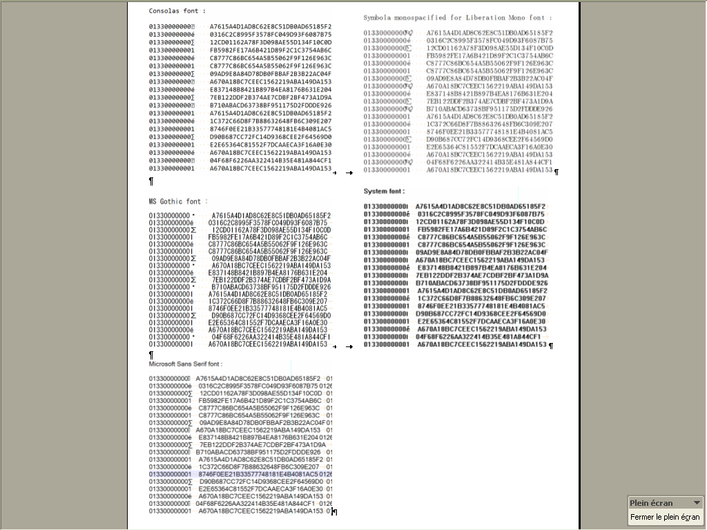

                          Hello @alan-kilborn,
                          As you can see, in the picture below, sometines, even with Monospaced fonts, some characters as the ∑ and other symbols like 🦅 do not have the same width than standard ANSI characters, when displayed in Notepad++ !
                          The raw text is :
                          So,if your going to use the colum-mode feature, I think that the best is to switch, first, to a classical true monospaced font, like Consolas or Courier New !
                          Best Regards
                            Alan Kilborn @guy038
                            @guy038 said in Identical strings in column:
                            if … use the column-mode feature, … best is to switch … to … true monospaced font, like … Courier New !
                            So I’m confused.
                            My screenshots in my immediately previous post WERE made with the font set to Courier New.
                            So remembering that I’ve converted all tabs to spaces, if I put my caret here:
                            and I press Shift+Alt+downArrow, I should get this:
                            because that is the only way to keep the same number of characters to the left of both carets in their respective lines.
                            But what I actually obtain is this:
                            which puts 52 characters to the left of the caret on line 1, and 53 characters to the left of the caret on line 2. And for a column mode selection this makes no sense. It is like it is doing it on a visual basis…and what good is that?!
                            So as an example that should really hammer this home, what if I insert a character, for example, an a. Here’s what happens:
                            That’s wrong!
                              Hi, @alan-kilborn,
                              Don’t be bothered by my reply. Results can be different because of:
                              • My old Win XP machine
                              • Old versions of some of my fonts
                              • The substitution fonts, used by the system, to display particular Unicode blocks
                              • The fallback font used by the system
                              So, just be patient, for a while, and we’ll speak about this later, when I finally get this bloody Win 10 laptop ;-)) Otherwise, I’ll won’t be able to follow the latest N++ releases, any more !
                                @guy038
                                Hmmm, well, Courier New seems to be about as “vanilla” as one can get, given that it is the default font in Notepad++, and every Windows computer since time began has it (I suppose).
                                It seems like a non-power user trying to do what I’ve shown, is going to encounter a similar problem, and complain. I guess it is debatable whether or not a non-power user is going to be doing column blocking, but maybe not out of the question.
                                I’m willing to keep talking about this (if there’s more to say), in the context of your old computer, because I feel this has been in existence in N++ for a long time, so such discussions should be valid.
                                  PeterJones @Petr Jaja
                                  @Petr-Jaja ,
                                  Sorry. I thought briefly about that condition when I started, but I didn’t notice your 3+ example in your data when I was debugging my answer, so forgot.i am on my phone now. Maybe later today, I will get a chance to be on the computer and work on this more.
                                  Also, maybe @guy038 solution would work better for you. ( I haven’t tried it. )
                                    @Petr-Jaja said in Identical strings in column:
                                    If there are more than two equal strings in the file, the sequence 3 indicates only first two of them.
                                    Okay, I found a workaround. I tried a clever alternation with \K on one of them, or anchoring on \G, but that wasn’t working easily. So, as I often do for practical solutions rather than optimized solutions, I added another step.
                                    Step 4 (as listed above) will catch 2, or 4, or 6, or any even number of replicated rows. But any odd number of rows will miss the last row. So added a step 4b:
                                    • Find What = (?-s)^([[:alnum:]]{32}).✗\x20{3}.*\R\K\1\x20{5}
                                      Replace With = $1\x20✗\x20\x20\x20
                                    This will take care of the odd rows out. (I tried on 2,3,4,5,6, and 7 repeats, and I see no reason it woudn’t work beyond that)
                                    Someone cleverer than I am might be able to come up with the magical formula to reduce the number of steps. And that’s great if you’re writing an application that will be running the regex millions of times, where the efficiency improvement might save significant time (and thus money) over the lifetime of the regex. But for a sequence that you’re just running once, or only occasionally on a small number of rows, efficiency isn’t the most important.

                                      • Petr JajaP
                                        Petr Jaja @PeterJones
                                        @PeterJones , @guy038
                                        I have tested your solutions and both work fine. However, for futher work I will use probably the solution from @guy038 because it is a little bit faster.
                                        Thank you very very much for your help.
                                        Tested - NP v.7.9.3 on Win10, Win7
