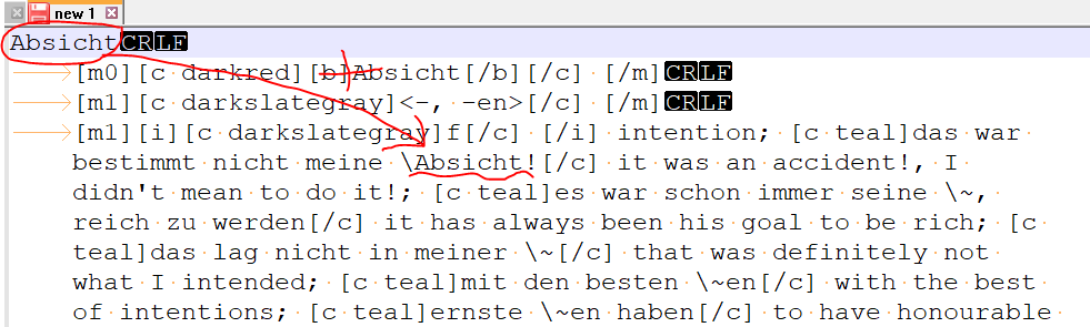

          With the first regex S/R provided in previous post, we’re able to insert the current headword, at the end of each card section, to refer to when further match of the \~ string, located after a space char. OK !
          So, now, let’s start with the regex \x20\\~ which matches a space character followed by the \ symbol and a ~ character and which must be replaced, somehow, with the current headword !
          Assuming this example, from the Absicht entry :
          \~, etw zu tun[/c] with a view to \[[i]or[/i] the intention of] doing sth; [c teal]er verfolgte sie in der
          @glossar, Which kind of output do you expect to ?
          • (A) \Absicht, etw zu tun[/c] with......, where everything after ~, till next word char, is just rewritten, as it is
          • (B) \Absicht etw zu tun[/c] with......, where everything after ~, till next word char, is replaced with a single space char
          • (C) \Absicht: etw zu tun[/c] with......, where everything after ~, till next word char, is replaced with : and a single space char
          • (D) \Absicht; etw zu tun[/c] with......, where everything after ~, till next word char, is replaced with ; and a single space char
          • (E) \Absicht. etw zu tun[/c] with......, where everything after ~, till next word char, is replaced with . and a single space char
          • (F) \Absicht> etw zu tun[/c] with......, where everything after ~, till next word char, is replaced with > and a single space char
          • (G) \Absichtetw zu tun[/c] with......, where everything after ~, till next word char, is simply deleted

                If I shouldn’t sound demanding :D, I would say I would expect all and none of them. There are thousands of entries in the file, with possibly ten thousands of tildes - I can’t go through all of them visually and manually, hence I can’t know or predict what stays before and after (each) tilde(s). As I said, you can’t ruin anything since they are not part of anything in the file. The regex should therefore replace a tilde with the headword exactly there, where it finds it - if there are zero or one or multiple spaces, letters, chars or whatever before or after a tilde, let it be, it should be replaced regardless.

                  Hi, @glossar, @terry-r, @alan-kilborn, @peterjones and All,
                  Thanks for your reply. So the second regex S/R should simply replace :
                  • A tilde character, in the expression space character + backslash character ( \ ) + tilde character ( ~ )
                  with :
                  • The headword of the current card section, only, without any additional char, either before or after
                  Note, @glossar, that this formulation means this kind of replacement :
                  ...nicht meine \Absicht![/c] it was an accident!, I didn't mean to do it!; [c teal]es war schon immer seine
                  ...immer seine \Absicht, reich zu werden[/c] it has always been his goal to be rich; [c teal]das lag nicht in meiner
                  ...in meiner \Absicht[/c] that was definitely not what I intended; [c teal]mit den besten
                  ...den besten \Absichten[/c] with the best of intentions; [c teal]ernste
                  ...[c teal]ernste \Absichten haben[/c] to have honourable \[[i]or[/i] [c sienna]AM[/c] -orable] intentions; [c teal]verborgene
                  ...[c teal]verborgene \Absichten[/c] hidden intentions; [c teal]die
                  ...[c teal]die \Absicht haben, etw zu tun[/c] to have the intention of doing sth; [c teal]in selbstmörderischer
                  ...elbstmörderischer \Absicht[/c] with the intention of killing herself/himself; [c teal]\~ sein[/c] to be intentional; [c teal]in der
                  ...in der \Absicht, etw zu tun[/c] with a view to \[[i]or[/i] the intention of] doing sth; [c teal]er verfolgte sie in der
                  ...in der \Absicht, sie zu berauben[/c] he followed her with intent to rob her; [c teal]eine
                  ...[c teal]eine \Absicht verfolgen[/c] to pursue a goal; [c teal]mit/ohne
                  ...mit/ohne \Absicht[/c] intentionally/unintentionally[/m]
                  ...[c teal]ein \Kaminfeuer machen[/c] to light the fireplace[/m]
                  where the headword Absicht will be inserted with these different syntaxes :
                  If you agree, to this general format, which, BTW, simplifies the second regex, here is a summary of the final solution :
                  • This first regex S/R, as said before :
                    • SEARCH (?s)^(\w+).+?\K(?=^\w+|(\Z))
                    • REPLACE (?2\r\n)\1\r\n
                  Adds each headword at the end of each card section
                  • Then, this second regex S/R :
                    • SEACRH (?s)\x20\\\K~(?=.+?^(\w+))|^\w+\R(?=\w+|\Z)
                    • REPLACE ?1\1
                  Replaces any tilde character, in the expression “space char + the \~” string, with the current headword
                  Deletes any headword, temporarily inserted at the end of each card section
                  IMPORTANT : for these two S/R :
                  • You must tick the Wrap around option
                  • You MUST use the Replace All button, ONLY ( Do not use the Replace button at all ! ). This is because of the \K syntax in the regexes
                  glossarG 1 Reply Last reply Reply Quote 2

                      Hi, @glossar,
                      Ah… OK ! If you want to get rid of the \ character, as well, just use this modified version of the second regex :
                      • SEARCH (?s)\x20\K\\~(?=.+?^(\w+))|^\w+\R(?=\w+|\Z)
                      • REPLACE ?1\1
