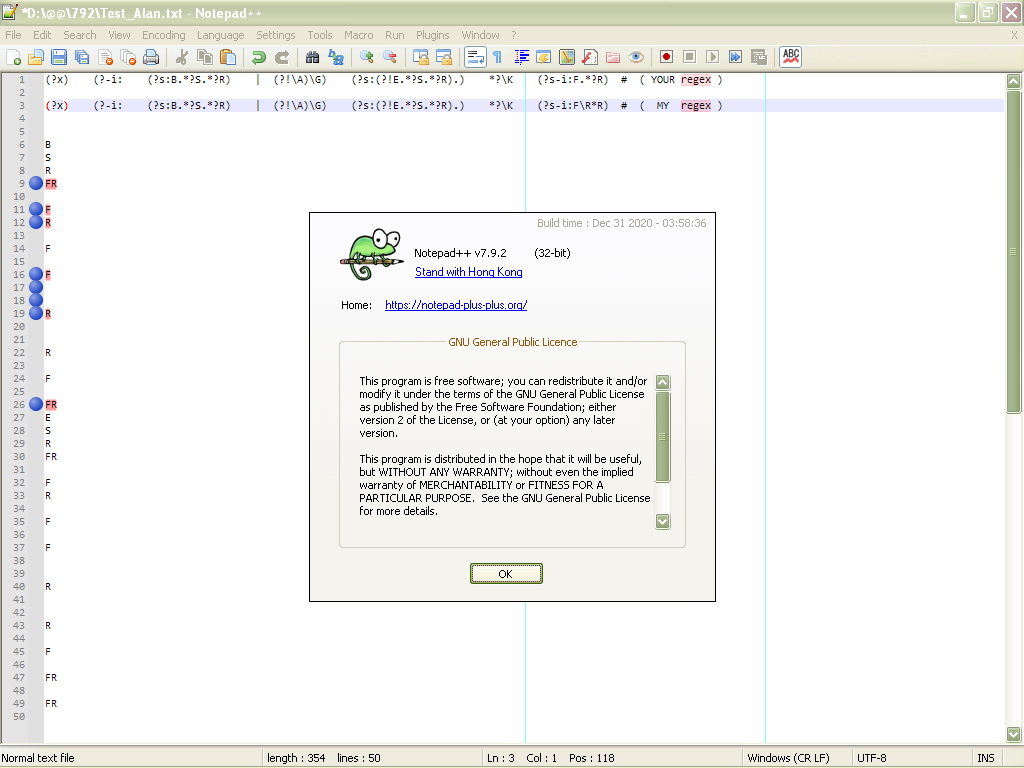

                So, if we use this overall regex ( only the FR part have been changed ) :
                (?x)    (?-i:    (?s:B.*?S.*?R)    |  (?!\A)\G)    (?s:(?!E.*?S.*?R).)    *?\K    (?s-i:F\R*R)
                it correctly matches and marks :
                • The string FR, line 9, right after the BSR
                • The string FCRLFR, lines 11 and 12
                • The string FCRLFCRLFCRLFR, between the lines 16 and 19
                • The string FR, line 26, right before the ESR
                • And every other match of the simple regex (?s-i:F\R*R), located after the ESR, are discarded, as expected ;-))
                Refer the picture, below, where I’m using the regex in line 3 :

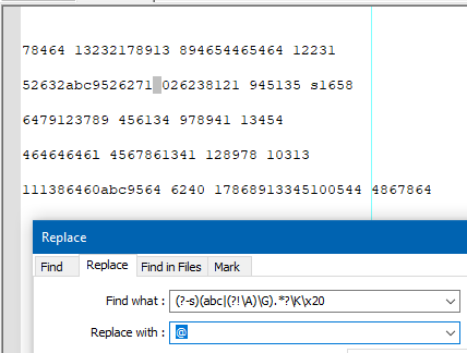

                    I tried to study the \K behavior, in case of a simple replacement with the Replace button and, unfortunately, I cannot deduce a general rule for that assertion :-((
                    • Open a new tab and paste the simple expression abgcd ef ghi j
                    • Select one line of the list , below, containing a regex
                    • Open the Replace dialog( Ctrl + H )
                    • For all the examples, the Replace with field contains only the @ character
                    • Click once on the Find Next button
                    • Then, click several times on the Replace button … till no replacement occurs
                    Results, after :
                        - A "CTRL + HOME" operation
                        - SELECTION of ONE regex or LINE, below
                    	- A "CTRL + H" operation
                        - ONE click on the "FIND NEXT" button
                        - SEVERAL clicks on the "REPLACE" button  ( NOT the "REPLACE ALL" button ! )
                    against the string  "abgcd ef ghi j", PASTED in a NEW tab :

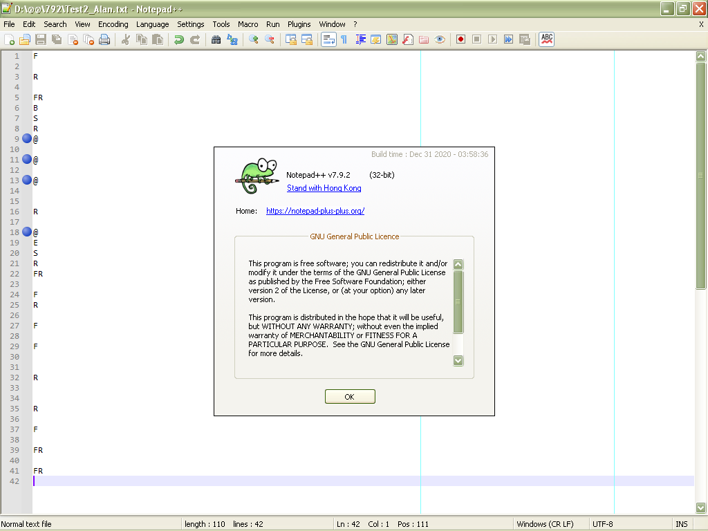

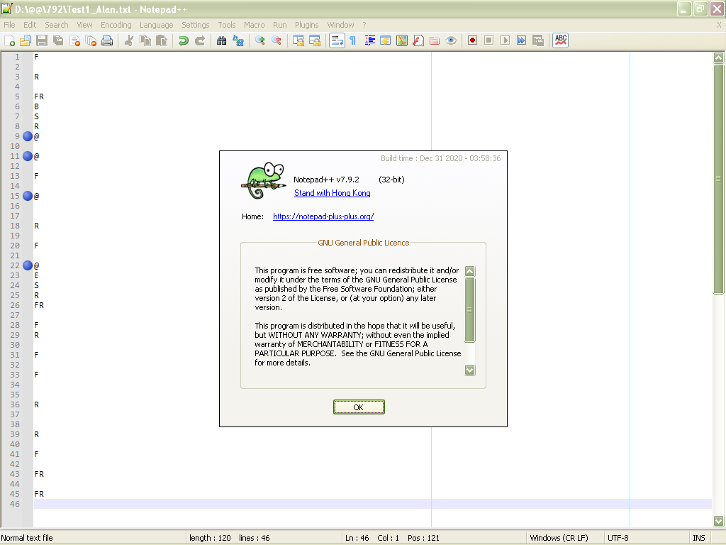

                    • Move back to the very beginning ( Ctrl + Home )
                    SEARCH    (?x)  (?: (?s-i:B.*?S.*?R)  |  (?!\A)\G )  (?s-i:(?!E.*?S.*?R).)*?  \K  (?s-i:F\R*R)   #  With my FR version
                    REPLACE   @
                    • Click once on the Find Next button ( it should select the first FR, after “BSR” )
                    • Then, click four times on the Replace button
                    => One at a time, the selected matched zone is replaced with the @ sign ;-))
                    and you should get that picture :

                        For instance, let’s imagine this text, in a new tab, beginning with two blank lines :
                        78464 13232178913 894654465464 12231
                        52632abc9526271 026238121 945135 s1658
                        6479123789 456134 978941 13454
                        46464646l 4567861341 128978 10313
                        111386460abc9564 6240 17868913345100544 4867864
                        Note that the lines 5 and 11, only, contains the string abc
                        And let’s use a simple regex, derived from our generic regex, presently studied in the previous posts :
                        (?-s)(abc|(?!\A)\G).*?\K\x20
                        Now, in this new tab, containing the sample text :
                        • Move back to the beginning ( Ctrl + Home )
                        • Open the Replace dialog Ctrl + H )
                          • SEARCH (?-s)(abc|(?!\A)\G).*?\K\x20
                          • REPLACE @
                        • Click once on the Replace button ( identical to a click on the Find Next button ! )
                        => The first space character, of line 5, is matched. As the caret was initially on a blank line, it cannot match any standard character. So the part (?-s)(?!\A)\G.*?\K\x20, with the second alternative, has not been used by the regex engine
                        Thus, the regex engine uses, necessarily, the first alternative ( the regex (?-s)abc.*?\K\x20 ), which indeed, contains a part, before \K, which is not a zero-length area, as equal to (?-s)abc.*?
                        However, if you click a second time on the Replace button, the first space char of line 5 is, as expected, changed into the @ symbol !
                        Of course, any further space char, located in lines containing the abc string, are replaced, in the same way, after successive clicks on the Replace button
