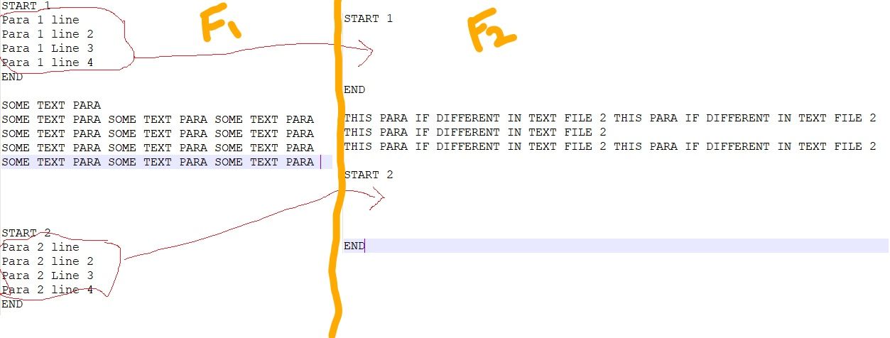

@guy038 Thanks, Again sorry for my bad communication. My text file has 300 paragraph Numbered from 1 to 300 Ascending order. When Replacing this order changes instead of 1,2,3 it paste 199,299,336,49,59…99,109,119 etc.209,219,229 this is order.
************File2*********** START 1 END Between para line START 2 END Between para line START 3 END Between para line START 4 END Between para line START 5 END Between para line START 6 END Between para line START 10 END Between para line START 11 END Between para line START 12 END Between para line START 13 END Between para line START 14 END ================= ************File 1********** START 1 some line END File 1 para between START 2 some line END File 1 para between START 3 some line END File 1 para between START 4 some line END File 1 para between START 5 some line END File 1 para between START 6 some line END File 1 para between START 10 some line END File 1 para between START 11 some line END File 1 para between START 12 some line END File 1 para between START 13 some line END File 1 para between START 14 some line ENDouput
************File2*********** START 13 some line END Between para line START 2 some line END Between para line START 3 some line END Between para line START 4 some line END Between para line START 5 some line END Between para line START 6 some line END Between para line START 10 some line END Between para line START 11 some line END Between para line START 12 some line END Between para line START 13 some line END Between para line START 13 some line ENDHope you will get my point. The sequence or ordering changes instead of 1,2,3. It shows first 13.Thanks.
