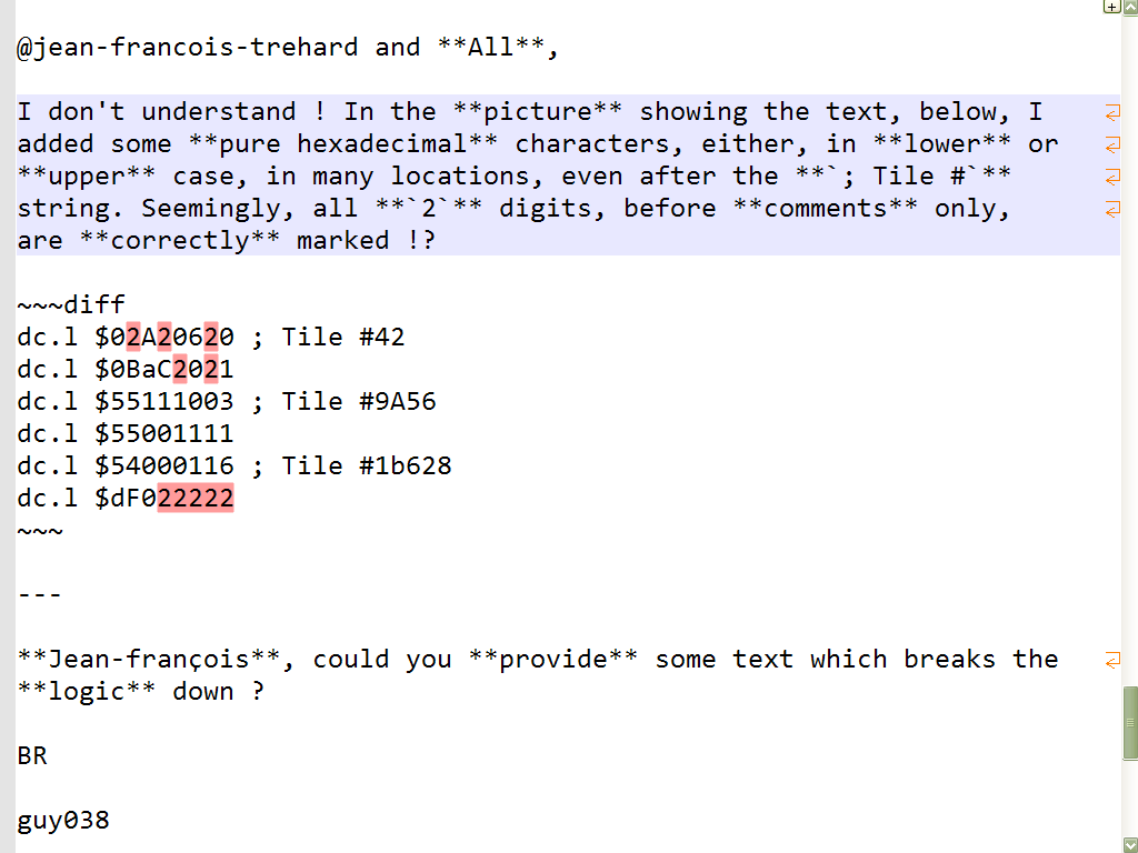

                  Hi, @jean-francois-trehard, @terry-r and All,
                  No problem too. We can do miracles with regexes ;-))
                  This time :
                  • We must use a non-capturing group at the very beginning of the regex
                  • We must add a second non-capturing group to get the \K feature for search of, either, the digits 0, 1 or 3, only
                  • We must add inner real groups in order that :
                    • Group 1 is defined when a 0 digit is matched
                    • Group 2 is defined when a 1 digit is matched
                    • Group 3 is defined when a 2 digit is matched
                  And the replacement zone is self-explanatory !
                  So, given this text :
                  dc.l $02A20620 ; Tile #42
                  dc.l $0BaC2021
                  dc.l $55111003 ; Tile #9A56
                  dc.l $55001111
                  dc.l $54000116 ; Tile #1b628
                  dc.l $dF022222
                  The following regex S/R :
                  SEARCH (?:\$|\G)\w*?\K(?:(0)|(1)|(2))
                  REPLACE (?1G)(?2H)(?3I)
                  will output, in one pass, the expected text, leaving the comments untouched
                  dc.l $GIAIG6IG ; Tile #42
                  dc.l $GBaCIGIH
                  dc.l $55HHHGG3 ; Tile #9A56
                  dc.l $55GGHHHH
                  dc.l $54GGGHH6 ; Tile #1b628
                  dc.l $dFGIIIII
