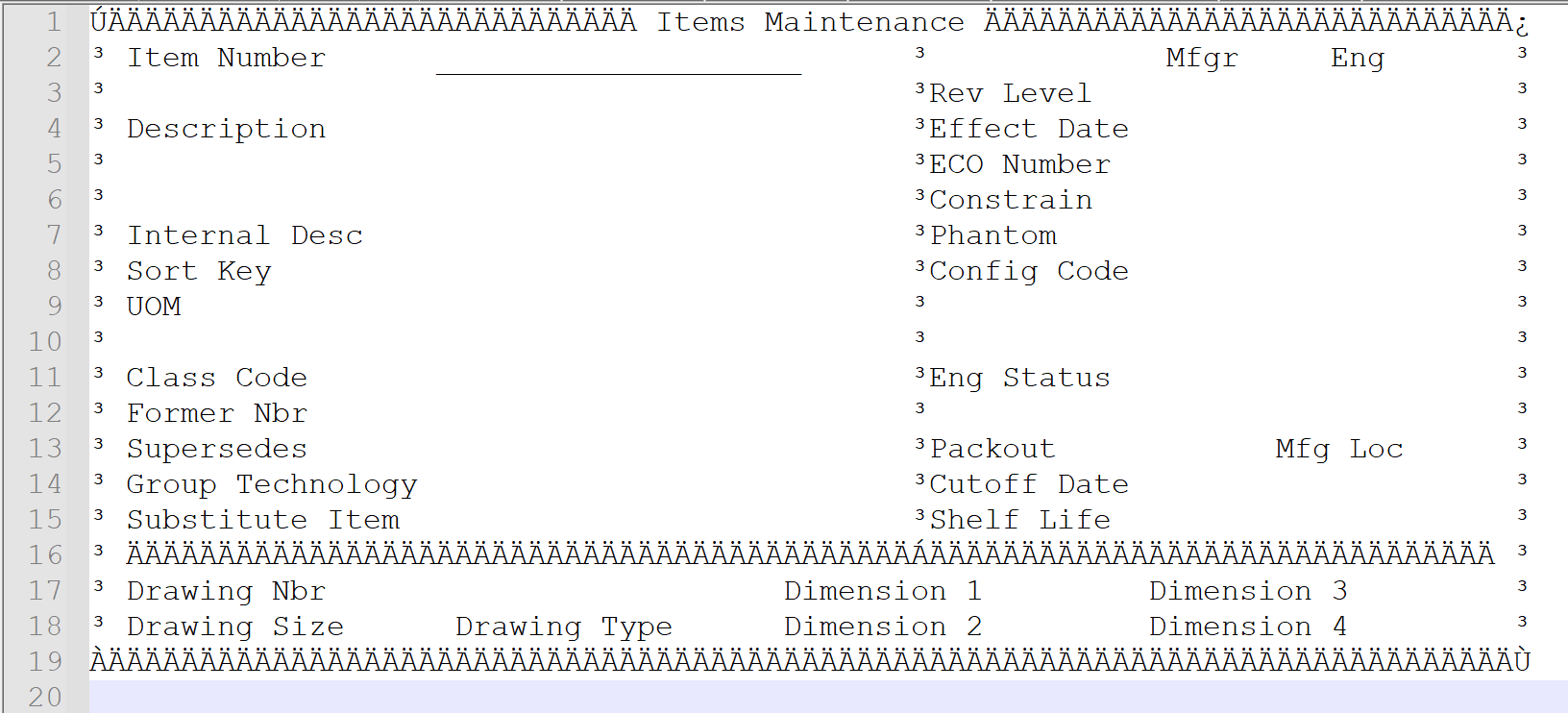

    • Gregory GG
      Gregory G

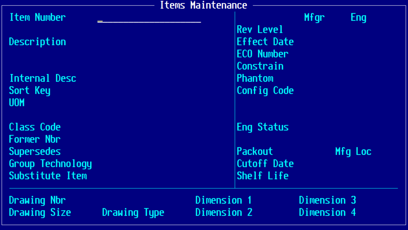

      I’ve seen references to the box drawing characters when I’ve searched for it, but not found a solution that works for my application. I’m working with an application that draws screens using the ASCII box drawing characters of old. PC DOS style (replacing it is not an option at this time, because reasons)
      When developing, I will copy the screen and paste it into the text editor. I have been unable to find the proper configuration in Notepad++ to display the line characters properly. Instead, they are shown as ÄÄÄÄÄÄÄ instead.
      I’ve flagged all the various encoding types, but it doesn’t seem to help.
      It wouldn’t be too large of an issue, except the search and replace seems to get confused on how it interprets the copied double-line upper-right corner symbol, making search and replace impossible, and I have to manually edit every after paste.
      That or briefly return NoteTab Pro. That app too has it’s pros and cons for use. Generally, I consider Notepad++ superior, but there are a few features that make me open the other one. Developing in this particular app is one of them.

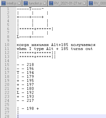

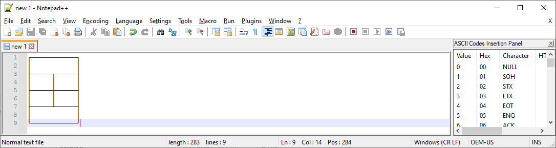

          Just a little more research on this side before we hear back from the OP…if we hear back:
          I found that if I get a file encoded in OEM-US and it is displayed that way in the status bar:
          Imgur
          Then I don’t seem to have a problem with “box characters”, as inserted from the ASCII Codes Insertion Panel in Notepad++.

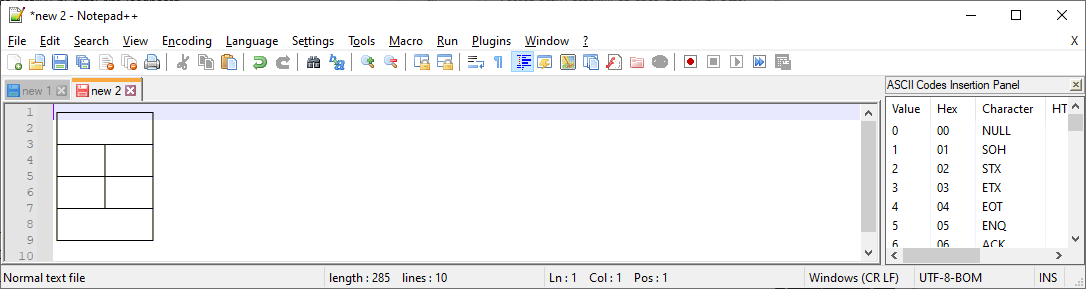

          Here’s a sample of what I’m seeing in a N++ tab:
          Imgur
          Note: I wasn’t trying to draw a nice box! Too much effort! I just put some random “box” characters in my document.
          Not sure if this info helps the OP in any way, as we are still “information insufficient” from him.

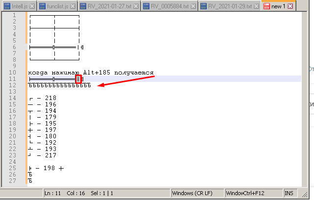

            @Alan-Kilborn , @Gregory-G
            Yesterday, when I had tried, I was having difficulty: I would try to pick OEM-US, but it would still show as UTF-8 on the status bar and in the encoding. But today, that problem isn’t occurring – I don’t know what I was doing wrong yesterday, but that’s not really important.
            Anyway, the steps I had to take:
            • create a new document
            • change Encoding > Character Sets > Western European > OEM-US
            • paste in boxdrawing characters
            • save as boxdrawing.nfo
            • save copy as boxdrawing-nfo.txt
            • close those files
            • open those files =>
              • boxdrawing.nfo properly recognized as OEM-US. that extension defaults to that encoding, because NFO files are associated with boxdrawing from the ancient MSDOS era
              • boxdrawing-nfo.txt might not be recognized (and may depend on settings for Preferences > New Document > Apply to Opened ANSI files and Preferences > MISC > Autodetect character encoding
                • if not recognized, you should be able to Encoding > Character Sets > Western European > OEM-US
            And I did confirm that OEM-US codepoint 196 ─ is “ANSI” encoding codepoint 196 Ä (where ANSI can be any of the windows 125x encodings, but most often Windows-1252)

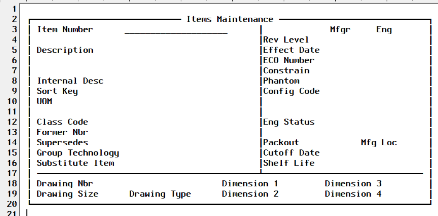

              PeterJones @Gregory G
              @Gregory-G ,
              Sorry, forgot to make my main point, though I hinted at it: if you want to ensure your file is always interpreted as OEM-US, give it the NFO extension .nfo. Alternately, if it’s already got a unique extension, add your user extension (without the dot) to Style Configurator > Dos Style > User Ext., and Notepad++ will always treat that extension as a “dos style” as well. If your file ends in .txt, I don’t recommend adding that to the user ext, and instead you may have to always manually pick OEM-US
              If you’re going to be doing the conversion to OEM-US frequently, and you cannot automate it through extension-recognition, you might want to associate a keyboard shortcut to that entry: Settings > Shortcut Mapper > Main menu, in filter, type “OEM-US”, then Modify the shortcut to some keyboard combo that you can remember.

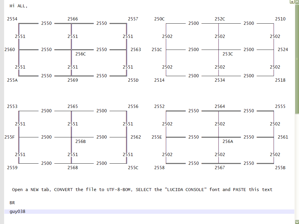

                Hello, @gregory-g, @alan-kilborn, @peterjones and All,
                As you can see, from the answers of Peter and Alan, dealing with these drawing box characters is not very easy for many reasons :
                • Generally, the installed fonts of your system cannot cover the old OEM-US or CP437 encoding
                • If you decide to use the CP-437 encoding ( Encoding > Character Set > Western European > OEM-US ), you can write ONLY with a set of 256 characters, shown in the Character Panel ( Edit > Character Panel )
                • And, if you decide to mix your box drawing characters with other normal characters, you’re likely meet some encoding problems, as @peterjones exposed ;-((
                Fortunately, there a simple way to safely use these drawing box characters !
                First, when I said that fonts do not cover the OEM-US encoding, it’s not totally exact : among the main fonts available, the Lucida console font can draw all these box drawing characters, as well as the old LineDraw font. If necessary, download the Lucida Console font from this link :
                https://www.fontyukle.net/downloadfont/Lucida-Console
                This font can display 644 characters, listed at the end of this post, for information
                Once the Lucida Console font ( Lucida Console.ttf ) is installed on your system :
                • Start Notepad++,
                • Open a new tab ( Ctrl + N )
                • Run the Encoding > Convert to UTF-8-BOM menu option ( Not the simple UTF-8-BOM option )
                • Paste the text below, in this new tab
                 2554                   2566                   2557      250C                   252C                   2510
                     ╔═══════ 2550 ══════╦════════ 2550 ══════╗              ┌─────── 2500 ──────┬──────── 2500 ──────┐
                    2551                2551                 2551           2502                2502                 2502
                2560 ╠═══════ 2550 ══════╬════════ 2550 ══════╣ 2563    251C ├─────── 2500 ──────┼──────── 2500 ──────┤ 2524
                     ║                   ║ 256C               ║              │                   │ 253C               │
                     ╚═══════ 2550 ══════╩════════ 2550 ══════╝              └─────── 2500 ──────┴──────── 2500 ──────┘
                 255A                   2569                   255D      2514                   2534                   2518
                 2553                   2565                   2556      2552                   2564                   2555
                     ╓─────── 2500 ──────╥──────── 2500 ──────╖              ╒═══════ 2550 ══════╤════════ 2550 ══════╕
                255F ╟─────── 2500 ──────╫──────── 2500 ──────╢ 2562    255E ╞═══════ 2550 ══════╪════════ 2550 ══════╡ 2561
                     ║                   ║ 256B               ║              │                   │ 256A               │
                     ╙─────── 2500 ──────╨──────── 2500 ──────╜              ╘═══════ 2550 ══════╧════════ 2550 ══════╛
                 2559                   2568                   255C      2558                   2567                   255B
                Note that this text does not seem aligned. But, once pasted it in a N++ new tab, everything is correctly aligned ;-))
                • Save this file as Box_Drawing_chars.txt
                • Now, when opening a new file, which is generally an UTF-8 encoded file, if you need to insert some box drawing chars :
                  • Open the true UTF-8-BOM file Box_Drawing_chars.txt, in the secondary view
                  • Select some of these line chars of file Box_Drawing_chars.txt
                  • Paste them in your current file, in the main N++ view
                • Remark that I indicated the Unicode code-point of each of these chars. Thus, using the Microsoft input method 'ALT' + '+' numpad key + 'four hexadecimal chars' you may insert any of these 40 box drawing characters. For instance :
                  • Hit the ALT key
                  • While holding down the ALT key, hit the + key of the numeric pad
                  • Still holding down the ALT key, hit, successively, the four keys 2, 5, 6 and A of the numeric pad
                  • Release the ALT key
                => The box drawing char ╪ should be inserted in current file
                Note that it could be necessary, on older OS, as mine, to do a registry modification in order that this input method would be effective !
                • So, you can insert any of these 40 special chars, as well as the 604 classical characters, shown below !
                • When all is in place, simply save your UTF-8 file. Even, if your close and re-open the file or if you stop and re-start N++, no problem anymore, as long as you use the Lucida Console font, from within N++ ;-))
                In the list, below, I shortened the name of the characters, in order to get a post not exceeding 16,300 bytes about !
                Lucida Console v5.01 [644 characters ] :

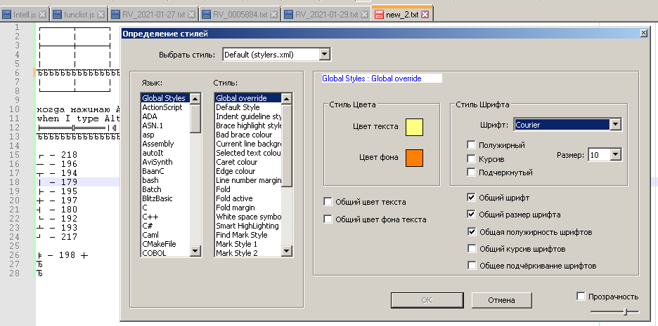

                  • TroshinDVT
                    TroshinDV @TroshinDV
                    когда нажимаю Alt+185 получается = when I type Alt + 185 turns out
                    • TroshinDVT
                      @TroshinDV
                      https://github.com/trdm/hlam/blob/main/files/new_2.txt
                      • TroshinDVT
                        @TroshinDV alt text
                        • TroshinDVT
                          • &Кодировки->Кодировки->Кириллица->Windows-1251 Ctrl+F12
                            шрифт:
                            Alan Kilborn @guy038
                            @guy038 said in ASCII Box drawing characters forcing me to use alternative text editor:
                            +1, for the box-drawing character diagrams alone! :-)

                              • TroshinDVT
                                TroshinDV @PeterJones
                                @PeterJones file from https://community.notepad-plus-plus.org/post/62317 after save and reopen.
                                it looks like Windows operates on other characters when alt + a combination of numbers.
                                badly.
                                I would like to have symbols for drawing tables in 1251 …
                                • TroshinDVT
                                  TroshinDV
                                  And I already wanted to write a script in javascript for a jN plugin that draws a table by pressing Alt + (arrows). :)
                                  • TroshinDVT
                                    TroshinDV
                                    скопировал текст из
                                    https://community.notepad-plus-plus.org/post/62316
                                    Very strange behavior. Bug?
                                    alt text
                                      Gregory GG 1 Reply Last reply Reply Quote 0
                                      • Gregory GG
                                        Gregory G @guy038
                                        @guy038 @Alan-Kilborn @PETERJONES @TroshinDV
                                        I know this is an old post. I want to thank you all for explaining why it happens.
                                        My situation is a bit rare. I’m using a slightly modified telnet client to access a database engine. This client was designed in the Windows-XP era and the developers seemed to do as little as possible to it to keep it functional as the OS progressed.
                                        It is a x86 distribution, they distribute their own Windows font with it, and they use ascii line drawing symbols to represent on screen forms.
                                        See examples below. The example is not a good one, because some of the developer portions of the interface use many more box segments.
                                        New document -> Convert to UTF-8-BOM and even selecting the vendor supplied font does not produce the line drawings.
                                        I understand this is probably a case of new vs old. Or perhaps if I uninstall the 64 bit version and hunt down a 32 bit version that would work?
                                        A screen snip from the client program:
                                        Pasting into [cough] NoteTab Pro
                                        Pasting into Notepad++
                                          @gregory-g
                                          If I type those characters in an OEM-US (the boxdrawing code page), Notepad++ does just fine with them. If I copy/paste from the OEM-US tab to a UTF-8-BOM tab, they still look right.
                                          Looking at the bytes in my files after saving:
                                          C:\usr\local\apps\npp\npp.8.2.2-RC1.portable.x64>xxd oem-us.txt
                                          00000000: dac4 c4c4 c4c4 c4c4 c4c4 c4c4 bf0d 0ab3  ................
                                          00000010: 2020 2020 2020 2020 2020 20b3 0d0a c3c4             .....
                                          00000020: c4c4 c4c4 c2c4 c4c4 c4c4 b40d 0ab3 2020  ..............
                                          00000030: 2020 20b3 2020 2020 20b3 0d0a c3c4 c4c4     .     .......
                                          00000040: c4c4 c5c4 c4c4 c4c4 b40d 0ab3 2020 2020  ............
                                          00000050: 20b3 2020 2020 20b3 0d0a c3c4 c4c4 c4c4   .     .........
                                          00000060: c1c4 c4c4 c4c4 b40d 0ab3 2020 2020 2020  ..........
                                          00000070: 2020 2020 20b3 0d0a c0c4 c4c4 c4c4 c4c4       ...........
                                          00000080: c4c4 c4c4 d90d 0a                        .......
                                          C:\usr\local\apps\npp\npp.8.2.2-RC1.portable.x64>xxd utf8bom.txt
                                          00000000: efbb bfe2 948c e294 80e2 9480 e294 80e2  ................
                                          00000010: 9480 e294 80e2 9480 e294 80e2 9480 e294  ................
                                          00000020: 80e2 9480 e294 80e2 9490 0d0a e294 8220  ...............
                                          00000030: 2020 2020 2020 2020 2020 e294 820d 0ae2            ......
                                          00000040: 949c e294 80e2 9480 e294 80e2 9480 e294  ................
                                          00000050: 80e2 94ac e294 80e2 9480 e294 80e2 9480  ................
                                          00000060: e294 80e2 94a4 0d0a e294 8220 2020 2020  ...........
                                          00000070: e294 8220 2020 2020 e294 820d 0ae2 949c  ...     ........
                                          00000080: e294 80e2 9480 e294 80e2 9480 e294 80e2  ................
                                          00000090: 94bc e294 80e2 9480 e294 80e2 9480 e294  ................
                                          000000a0: 80e2 94a4 0d0a e294 8220 2020 2020 e294  .........     ..
                                          000000b0: 8220 2020 2020 e294 820d 0ae2 949c e294  .     ..........
                                          000000c0: 80e2 9480 e294 80e2 9480 e294 80e2 94b4  ................
                                          000000d0: e294 80e2 9480 e294 80e2 9480 e294 80e2  ................
                                          000000e0: 94a4 0d0a e294 8220 2020 2020 2020 2020  .......
                                          000000f0: 2020 e294 820d 0ae2 9494 e294 80e2 9480    ..............
                                          00000100: e294 80e2 9480 e294 80e2 9480 e294 80e2  ................
                                          00000110: 9480 e294 80e2 9480 e294 80e2 9498 0d0a  ................
                                          So, given the characters you are showing from your copy paste into Notepad++, I think what you need to do is to is to
                                          1. New file
                                          2. Set to Encoding > Character Set > Western > OEM-US
                                          3. Paste boxdrawing clipboard into the file
                                          4. Save
                                          5. Encoding > Convert to UTF-8-BOM
                                          6. Save
                                          When I followed those steps exactly, I got the same thing in the final file as I showed in my utf8bom.txt above.
                                          Addendum: Alternately, if your new file is set to Language > MSDOS style, it will automatically choose OEM-US, and it will want to save as xxx.nfo, and the bytes will be the same as before. But once you convert to UTF-8-BOM, you should save with a different extension, so that Notepad++ will stop trying to coerce it into boxdrawing MSDOS-style.
                                          Edit: I had incorrectly called OEM-US character set something else originally; I went back and fixed it all.
                                          Addendum 2: All this is basically a repeat of what I said a year ago. Apparently, I am not capable of explaining such things in a way you understand. Sorry. But now I’m worried you will again not understand.
                                          Gregory GG 1 Reply Last reply Reply Quote 2
                                          • Gregory GG
                                            Gregory G @PeterJones
                                            @peterjones
                                            Well, catch me running down the the street shouting “give me a towel”
                                            Or… Eureka.
                                            I just realize I was adjusting the wrong setting for font.
                                            I was working with global override when I should have modified Default Style
