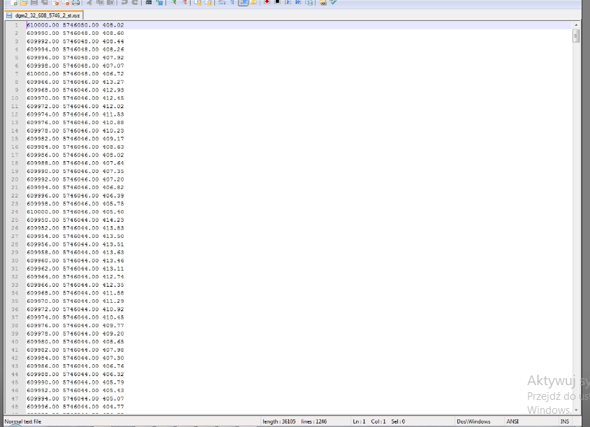

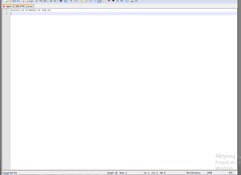

      Hello,
      I have problem of this kind: I have many txt files like that A example. And I need to remove all the content from them, except first line, like in B example (leave only one line, but in many files). How to do it ? Can it be made with N++ ?

        but make sure you have a backup in case something goes wrong.
        Regular expression search and replace with
        search: ^(.+?\R).+
        and replace: \1
        mark regular expression and . matches newline
