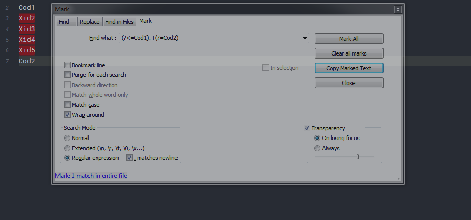

            Hello, @javier-Rivas, @ekopalypse and @alan-kilborn and All,
            I think that a more accurate regex would be :
            MARK (?s-i)^Cod1\R\K.+?(?=^Cod2\R)
            Because :
            • The (?-i) ensures that search of the limits Cod1 and Cod2 are done with case respect
            • The lazy quantifier +? is needed if several sections Cod1.......Cod2 exist in a same file
            • The start of line assertion ^ and the EOL characters \R ensure, for instance, that the line Cod2 will not be matched, either, in lines XXXCod2, Cod2XXX or XXXCod2XXX
            • The \R syntax, after Cod1, prevents from marking the line Cod1, too
            Javier RivasJ 1 Reply Last reply Reply Quote 1
              @Javier-Rivas
              so that I can copy … that out to another notepad
              If you highlight the text using either @Ekopalypse or @guy038 methods, you’ll want to use the Copy Marked Text button after.
              … or cut …
              There is no Cut Marked Text capability – maybe there should be?

                  @guy038 do I need to download a plugin. Because my Mark screen does not look like the one in the screen shot
                    Alan Kilborn @Javier Rivas
                    @Javier-Rivas
                    You just need N++ version 7.9.1 or greater.
