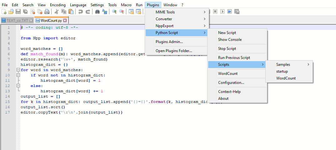

                                  1. Go to Plugins > Plugins Admin, and install the PythonScript plugin.
                                  2. Restart Notepad++ as necessary
                                  3. Plugins > Python Script > New Script, give it the name WordCount.py or similar
                                  4. Copy/paste the script that Alan posted earlier
                                  5. Plugins > Python Script > Scripts > WordCount.py will run the script for you, and use Paste / Ctrl+V to paste the count data wherever you want it (a new file, whatever)
                                  Once you know it works,
                                  1. Plugins > Python Script > Configuration…
                                  2. Select WordCount.py in the UserScripts
                                  3. Click the left Add to add that script to Menu Items list
                                  4. Make sure Initialisation is et to ATSTARTUP
                                  5. Click OK
                                  6. Exit Notepad++ and restart
                                  7. Settings > Shortcut Mapper > Plugin Commands
                                  8. Filter for WordCount
                                  9. Select that line, click Modify, and set the keyboard shortcut you desire, and close the dialogs.
                                  From now on, that keyboard shortcut will run the histogram (or you can go to Plugins > Python Script > WordCount), and it will put the word count in your clipboard buffer. Then all you have to do is paste the result somewhere.
                                  No programming required for you, because Alan already did the work.

                                      @PeterJones thanks Peter,
                                      nothing is happening…
                                        PeterJones @Patrik Spacek
                                        @Patrik-Spacek
                                        As I said,
                                        Did you paste somewhere after running the script?
                                        Patrik SpacekP 1 Reply Last reply Reply Quote 0

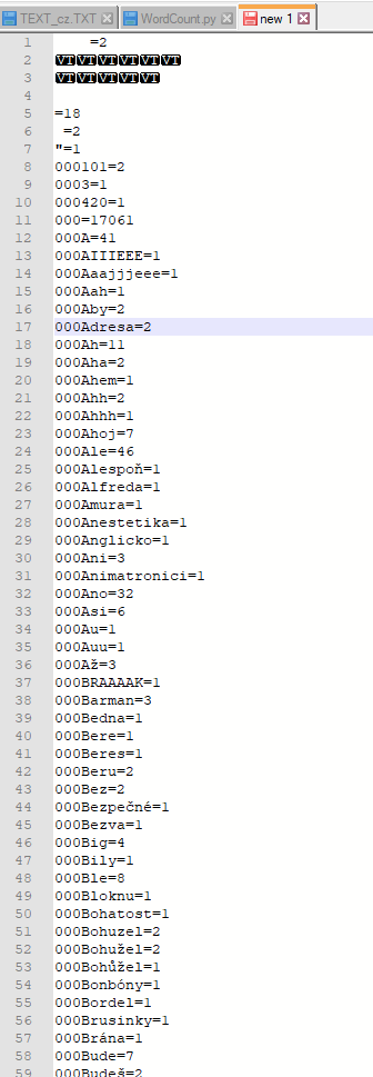

                                        • Patrik SpacekP
                                          Patrik Spacek @PeterJones
                                          @PeterJones ouch, i missed that paste to somewhere… yes, its working!
                                          what about add command that opens a new doc in notepad++ and paste it right away?
                                          also set in count order from highest to lowest?
