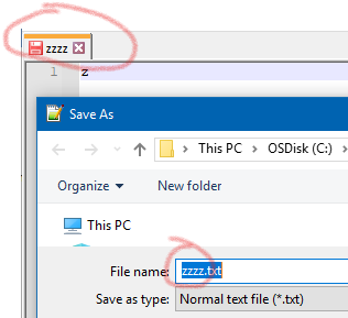

                        but surely every tab content that you try to save should have a “tab name” which should become the “filename” by default. So wouldn’t the filename field in the Save/Save As dialog box be filled with the default?
                        This IS what happens, whether an as-yet-unsaved-to-disk file has a default name (e.g. “new 1”, “new 4”, etc.) or you’ve right-clicked a “new X” tab and Rename…'d it to something else, e.g. “zzzz”:
                        However, it feels like I am missing some point in the discussion. ¯\_(ツ)_/¯

                          @Alan-Kilborn said in Page break Text File saving:
                          @PeterJones question to me has gone past the current theme, however I had previously responded to his statement
                          “No, I do not know of a way to pass a name to the Save As command”
                          in that (as you just pointed out) the filename field is already filled. I think the issue is really that the dialog is waiting for an enter key which I did try to manually insert into the macro code, that only made matters worse. I think the macro idea on the current theme is a dead duck.
