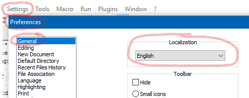

                        @pdanes said in Open with search:
                        So sometimes the find dialog has the title “Find”, and sometimes it’s “Najít”. Haven’t yet tracked down which circumstance makes it use which language…
                        Perhaps this?:
                        pdanesP 1 Reply Last reply Reply Quote 0

                          • pdanesP
                            pdanes @Alan Kilborn
                            @Alan-Kilborn said in Open with search:
                            Perhaps this?:
                            No, it changes in mid-stream. When I first call it, the dialog opens with “Find”, but after a while, it switches on its own to “Najít”. I haven’t (yet, anyway) taken the trouble to find out exactly when, or see if I can isolate the exact cause - I’ve been too busy just trying to get it working at all.
