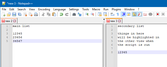

      Alright i have done the secondary view and downloaded the script that you published 19 hours ago. i tried it with only a couple thousand numbers and it took the program quite a while, but the program also marked all 9s that are in list 1, together with the numbers that are in list 2.
      here i’ve done a video about that:
      https://streamable.com/l81voi
        Alan Kilborn @M P
        @M-P
        It wasn’t considered that numbers in the list could be part of larger numbers. Meaning that you probably have a line with only 9 on it in your list in the secondary view?
        A similar thing would happen if you had a line of 123 and in the main view you had 1234, 61235, 7891230, etc.
        We can work around that, but some other further experimentation has shown that this might not be a viable way to do what you need. I don’t think the script logic is flawed, but I don’t have time immediately to dig in deeper to see what is truly going on.
        In light of that I suppose I’d advise you to seek an alternate solution if your need is short-term. I’d really not like to see a non-Notepad++ solution worked out in this forum, because it is off-topic, but perhaps this one time is OK (because I feel bad taking you down the N++ road only to abort) if someone has time and wants to present one of those.

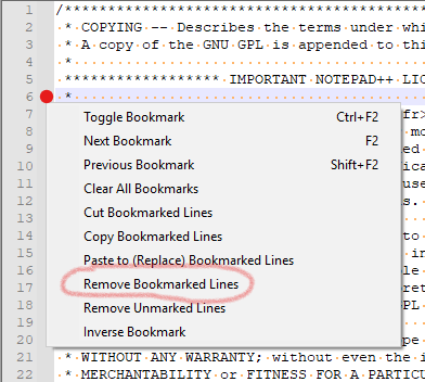

              But, your next step should be to right-click where I have the red dot in the following (doesn’t have to be on line 6!, just in that same vertical “bookmark margin” area), and choose the indicated command:
