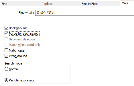

                    Alan Kilborn @cisco779k
                    @cisco779k said in help to delete part of line:
                    how can i put a bookmark only on even lines of a list?
                    I would do it this way:
                    This will put red marking on the text for the first character in even lines. If you don’t like that, untick Bookmark line and press the Clear all marks button.
                    can i put a bookmark only on specific ranges of lines?
                    Yes, use In selection checkbox rather than Wrap around for this. However, note that the notion of “even” will be from the point where you start the selection, NOT the absolute line numbering.
