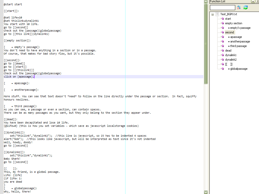

            So, assuming your last example :
            • First perform the macro Squiffy for Function List against your regular Squiffy code
            You should get the modified code, below :
            @start start
            [[start]]:
            @set life=10
            @set thislink=dynalink1
            You start with 10 life.
            go to [[second]]
            Check out the [passage](globalpassage)
            go to [[this link]](dynalink1)
            [[empty section]]:
            [    • empty's passage]:
            You don't need to have anything in a section or in a passage.
            Of course, that makes for bad story flow, but it's possible.
            [[second]]:
            go to [[dead]]
            go to [[start]]
            go to [[{thislink}]]
            click on [apassage].
            [    • apassage]:
            [    • anotherpassage]:
            More stuff. You can see that text doesn't *need* to follow on the line directly under the passage or section.  In fact, squiffy honours newlines.
            [    • third passage]:
            As you can see, a passage or even a section, can contain spaces.
            There can be as many passages as you want, but they only belong to the section they appear under.
            [[dead]]:
            You have been decapitated and lose 10 life.
            {@life=0} (this is how you set variables - which save as javascript localstorage cookies)
            [[dynalink1]]:
                set("thislink","dynalink2");  //this line is javascript, so it has to be indented 4 spaces
            alert("bob");  //this looks like javascript, but will be interpreted as text since it's not indented
            Well, howdy, doody!
            go to [[second]]
            [[dynalink2]]:
                set("thislink","dynalink1");
            Baby Shark!
            go to [[second]]
            This, my friend, is a global passage.
            Life: {life}
            {if life< 1:
            you are dead
            [    • globalpassage]:
            Why, hello, there!
            • Now, click on the View > Function List menu option.: here we are ! We get the picture :
            Do you like it ? If not, no problem ! We may “prepare” your regular Squiffy code for any other kind of displaying, in the Function List panel ;-))
            Remember, these two gestures, available since Notepad++ 7.9.1 :
            26. Add TAB keystroke in Function List to switch between search field and list (Fix 8665).
            27. Add ESC keystroke in Function List to switch to edit window (Fix #8886).
            See you later !
            Cheers,
            BGM CoderB 1 Reply Last reply Reply Quote 2

                    And what is the maximum of lines, which may separates a link from the definition ?
                    Also, could you provide your sample code, placing a dash - everywhere needed ? Just to visualize all the modifications to do with the regex S/R. Of course, I suppose :
                    • In passage definition as in [-apassage]:
                    • In passage link as in Check out the [passage](-globalpassage)
                    • Now, in the sentence above, does [passage], right before (-globalpassage), need to be written [-passage], too ?
                    • And, in sentences like this link [passage] will give you some hints, does [passage] need to be written [-passage] ?
                    Thanks for your cooperation !
                    • BGM CoderB
                      BGM Coder
                      @guy038 haha - you are relentless!
                      So, you can Click on [this link](-passage) where [this link] could be any text at all and it creates a link to what is in the parenthesis where (-passage) must be the same as in [-passage]: (the definition). The parenthesis always come after the link text.
                      Bascially, we are using this text to generate an html link. What is in the [ ] is the link text. What is in the parenthesis comes as a property called data-passage in the <a> element.
                      There is no limit on the amount of lines between a link and a definition.
                      If I used dashes, I think we would put them in the definition for the passages. So, anywhere we have [somepassagename]: with the : at the end. We would also have to use them in the links themselves.
                      [[Some Section]]:
                      Here is a section!
                      Click [here](-a passage) to display the passage.
                      Or we could display the link like:  [-a passage] and we don't need the parenthesis to tell us what passage.  The parenthesis are only needed if we use link text that is different than the definition name.  You see we can do it both ways.
                      Or we can summon [this one](-a global passage) or like this: [-a global passage]
                      Because we can call a global passage from any section.
                      [-a passage]:
                      Aha!  A passage has been revealed.
                      Behold! The Global Section.
                      [-a global passage]:
                      And this is text in a global passage.
                      Uh, since a passage only exists for each section, that means you can have passages with the same name in different sections, but you can’t have two with the same name in the same section.

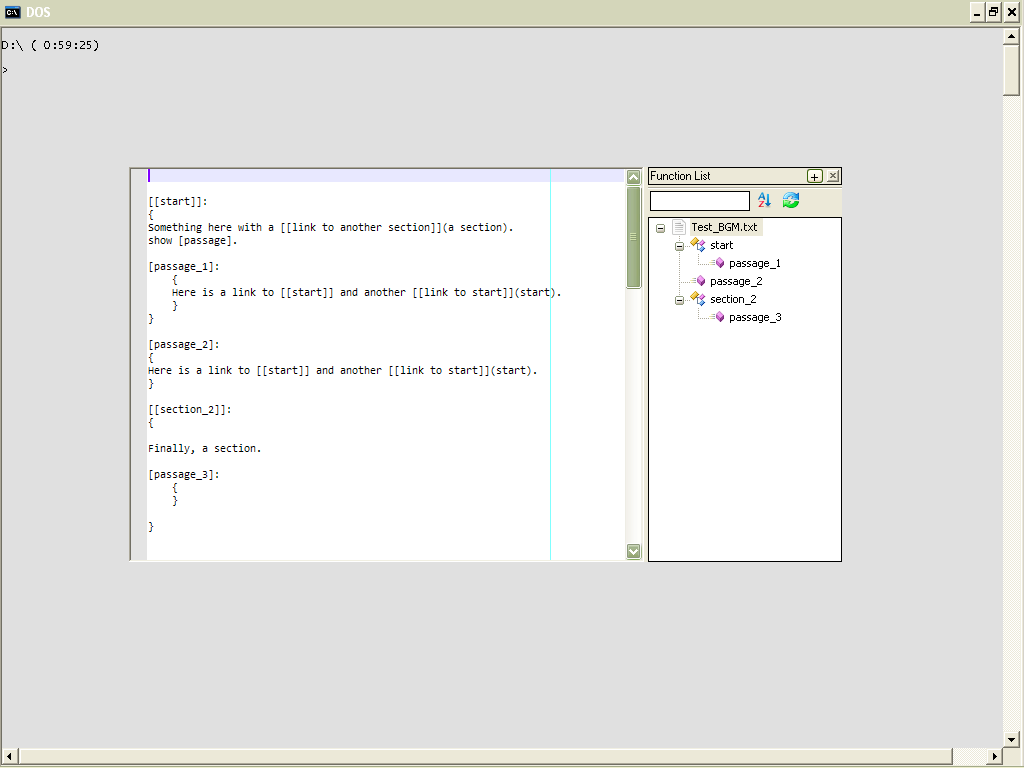

                        Hello @BGM-coder,
                        Could you confirm me that the regexes should act as below :
                        Case A  ^[[]]:                                    =>  Unchanged
                        Case B  ^[[aaaaa]]:                               =>  Unchanged
                        Case C  [[bbbbb]] not followed by (ccccc)         =>  Unchanged
                        Case D  (eeeee)   preceded by [[ddddd]]           =>  Unchanged
                        Case E  ^[]:                                      =>  Unchanged
                        Case F  [fffff] not followed by (gggggg)          =>  [-fffff]
                        Case G  (iiiii) preceded by [hhhhh]               =>  (-iiiii)
                        Case H  ^[jjjjj]:                                 =>  [-jjjjj]:
                        Note that, when cases F or G occur, the respective passage fffff or iiiii may be defined or not
                        See you later,
