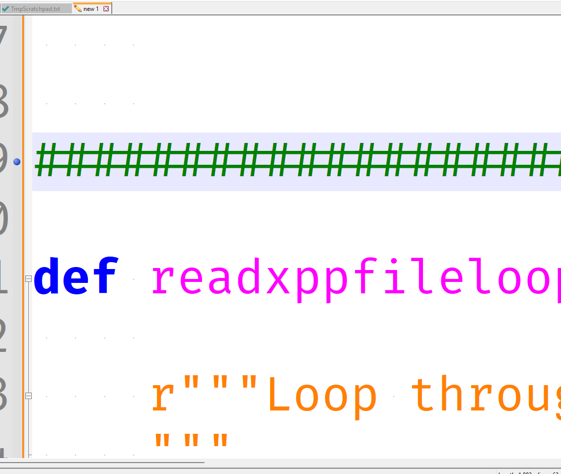

      Hi,
      I have the following situation: I bookmark a line with CTRL+F2 then scroll down to some other text in the document. After some time I jump back to the bookmark using SHIFT+F2 and the bookmarked line appears in the middle of the screen. However, I would like it to appear at the top.
      Is it possible to avoid the default behaviour and show the bookmarked line at the top of the window, i.e. the first visible line after jumping to the bookmark is the bookmarked line itself .
      Just for better understanding a more concrete example:
      I am writing a function in, let’s say C++ and bookmark the function head for later reference.
      As I add more text to the document, I want to jump back to the function and be able to see as much as possible from the function’s body.
      When the bookmarked line is showed in the middle of my screen however, I first have to scroll down a bit using the mouse or the arrow keys.
      Since this is a quite common situation for me, it would really be a timesaver to have the bookmarked line alway at the top of the window when jumping to it.

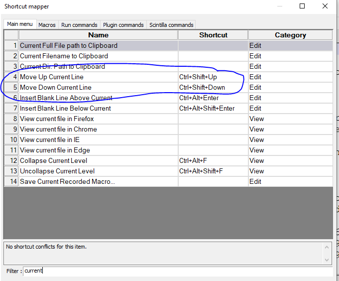

            @Terry-R Using CTRL+SHIFT-UP/DOWN moves the current line up/down for me. Did you mean CTRL+UP/DOWN? That works for me

              @Sebastian-Freeh said in How to jump to a bookmark and show the bookmarked line at the top of the screen, not in the middle:
              That suggests you have already started with customising your shortcuts. For me it’s
              That is unless there is some language setting which changes the shortcuts, doubtful?
              And as you resize your NPP window that will make my macro somewhat ineffective.

                        My fault. I initially thought you’d changed the shortcuts I referred to in the image of “my” shortcuts. But actually you were just using a different shortcut. If you look in the shortcut mapper for the items I was referring to you should see the keys I used will likely be what you have also.
