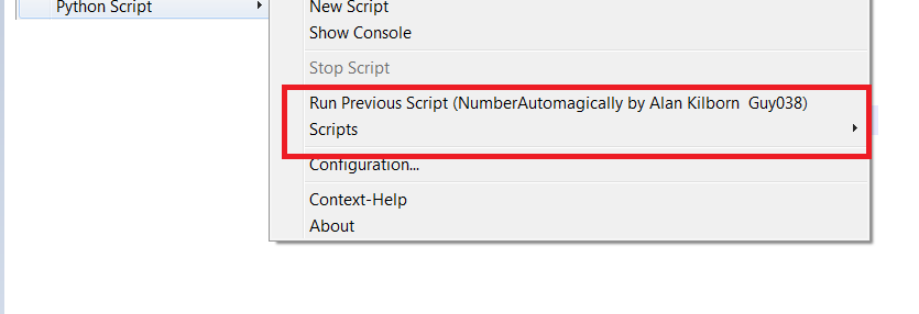

                      So the first thing is to use Plugins Admin (on Plugins menu) to get the Python Script plugin.
                      After that, do Plugins > Python Script > New Script and give the script a name; as I said, I called my copy NumberAutomagically.py but you are free to name it anything you like (it is just a name so that the plugin can find the script file).
                      Then N++ will open the (empty) script file, at which point you can copy and paste one version of the script above in and save it.
                      To run a script you do Plugins > Python Script > Scripts > and then click on your script.
                      I recommend trying it out before bothering to try to hook it into running when Notepad++ runs.

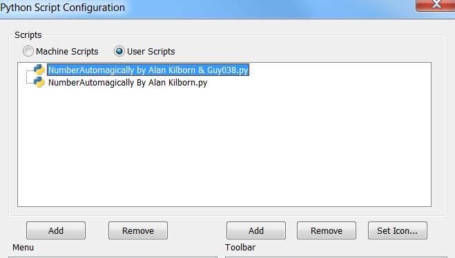

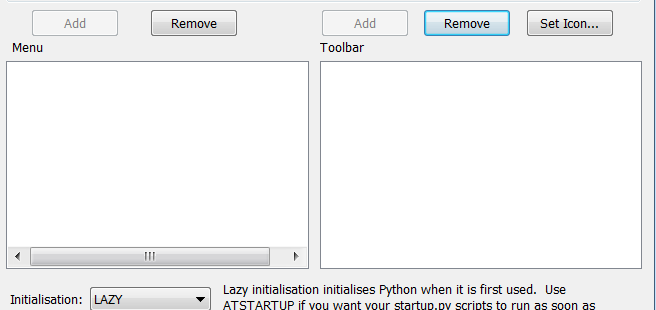

                        After installing Python Script and creating the script, you can add it to NPP toolbar with a custom icon or added to the Python script menu by going to:
                        [ Main Notepad++ UI>Plugins> Python Scripts>Configuration…> choose [NumberAutomagically by Alan Kilbor and Guy038.py] or [NumberAutomagically by Alan Kilbor.py] and then click Add button on the right side or left depending on your preference.
                        Clarification:
                        The left Add button will add [NumberAutomagically.py] to [Plugins>Python Scripts>NumberAutomagically.py] menu
                        And, the right button will add the a button to run the script on NPP toolbar
                        Also, you can install Customize Toolbar by going to [plugins>Plugins Admin…] and searching for [Customize Toolbar ] to change the order of that buttons :)
