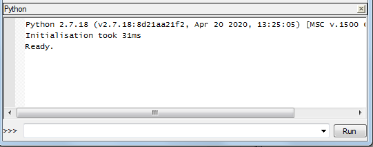

      Can you check if you see an error in the PythonScript console?
      Plugins->PythonScript->Show Console

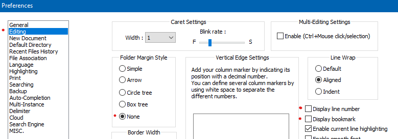

          So without any plugins that might create additional margins, I think N++ has 3 possible margins:
          1. Line number
          2. Bookmark
          3. Fold (for certain Language types, e.g. Python)

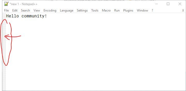

          If you have them all turned off, like this (see the red dots):
          Then you have a “don’t have any margin turned on” situation – or maybe I’m misunderstanding something?

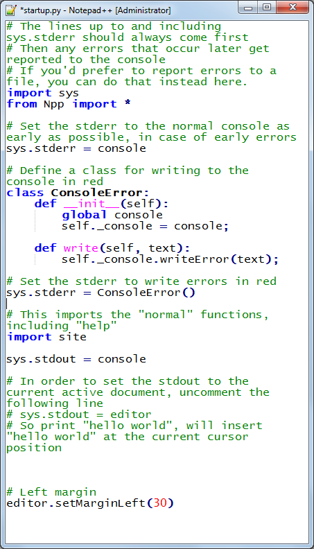

                  I created user scrypt startup.py.
                  Here is contents:

                  Console is empty

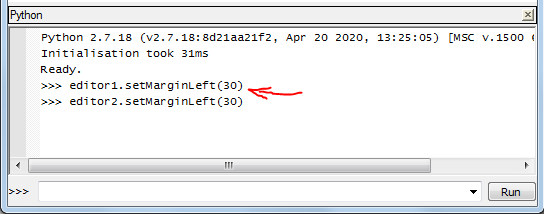

                  I enter commands manually:
                  But nothing happens

                            So the only other thing is that your user startup.py should only contain the two setMarginLeft… lines. The other stuff will get initialized from the standard startup.py.

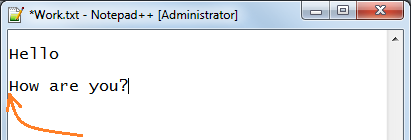

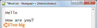

                                      My first post on this forum, so sorry for my noob question. I really don’t get it if this question is solved? I wanted to try the trick with Pyton Script plugin but I would need step by step instructions since I’m no programmer.
                                      So basically I need exactly what the OP asked, ability to change how close is the text from the left border. I would be satisfied with space that I get when choosing Settings>Preferences>Margine/Border/Edge>Folder Margin Style if the border was only white not gray (dotted pattern).

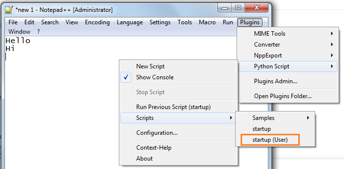

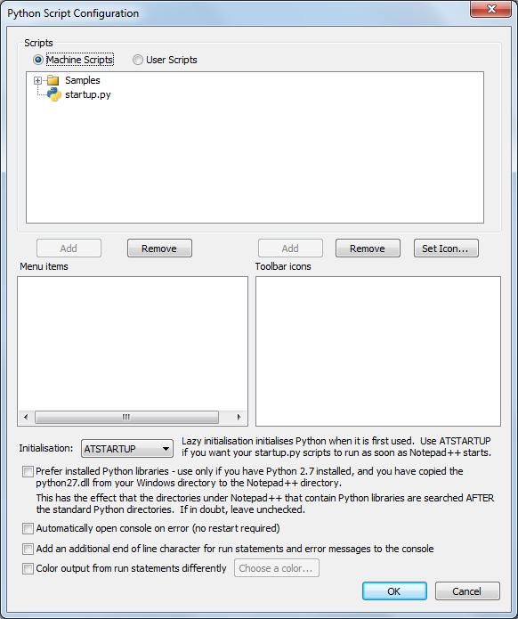

                                        1. Plugins > Plugins Admin: in the Available tab, enable ☑ Python Script and Install. Notepad++ should restart after installing the plugin
                                        2. Plugins > Python Script > Scripts: in the resulting sub-menu, Ctrl+Click on the Startup (user)
                                          (if you normal-click, it will run the script; ctrl+click will edit the script – you want to edit it)

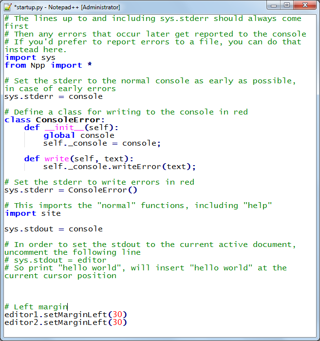

                                        3. It will open a file in Notepad++. At the end of that file, add the lines
                                          editor1.setMarginLeft(30)
                                          editor2.setMarginLeft(30)
                                          and save that file.
                                        4. Plugins > Python Script > Configuration…. Change the Initialisation: drop-down to ATSTARTUP, and click OK
                                        5. Exit and restart Notepad++.
                                        This should set wider margins. If it’s too wide or too narrow, use a smaller or larger number than 30 (bigger number means wider)
                                        If it doesn’t work for you, show us your ? > Debug Info, and give us screenshots showing your edited startup.py open in Notepad++, and maybe with the Plugins > Python Script > Show Console showing, so we can see if there are any unexpected error messages
