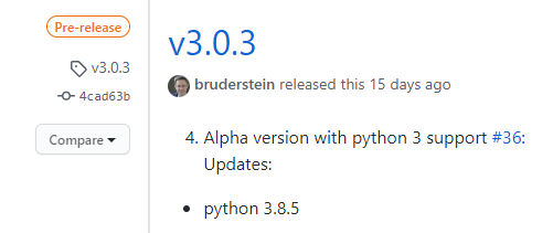

      Please note that v3.0.3.0 is clearly marked on https://github.com/bruderstein/PythonScript/releases as a “Pre-release” alpha version with Python 3 support:
      This means it is not necessarily fully debugged. It also means that some scripts are likely to change, because all fully-released versions of PythonScript have used Python 2, not Python 3, and there are differences in syntax.

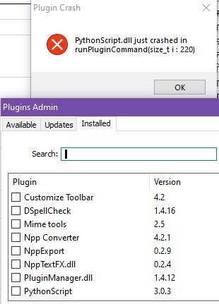

      my npp7.8.9 (64bit) (W10) Plugin manager is showing installed Pytonscript 3.0.3.0
      No it doesn’t, because Plugin Manager is a deprecated plugin which is not compatible with NPP7.8.9. Plugins Admin is the builtin tool that shows and manages npp7.8.9 plugins. You have been around long enough to know the difference, and to use the right words.

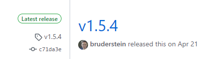

      v1.0.8.0 is not the latest version. I’m pretty sure that version isn’t even compatible with Notepad++ v7.8.9. That website is out of date. Please note that the Plugins Admin tool tells you that the modern homepage for PythonScript is the github page:
      The version that you can download from Plugins Admin is the version I showed above: v1.5.4. If you look on the official github releases page, v1.5.4 is clearly marked as the “latest release”:
      When I run your code with v1.5.4, it works.
      If you are going to be an alpha/beta tester for v3.0.3, you are going to have to use Python 3 syntax and make sure that the PythonScript API hasn’t changed. But if you want things to “just work” the way they used to, I would highly recommend you un-install the v3.0.3 Alpha version, restart, then use Plugins Admin to install the latest v1.5.4 full-release.

        By the way: nothing forced you to install the pre-release alpha version. If you had just used Plugins Admin to install PythonScript in the first place, you would have gotten a version that worked as you would expect. Don’t complain about “auto updates” when nothing about the installation of 3.0.3 was automatic: you had to manually install that, by choice.

              where do you find this 1.5.4 version?
              My post included a link and a screenshot.
              Note, I gave this link. But you gave the link https://github.com/bruderstein/PythonScript/ earlier, and the only way to get v3.0.3 from that site, which you apparently already accomplished, was to navigate from there through the “releases” link to the https://github.com/bruderstein/PythonScript/releases page.
              So you knew that page already.
              Scroll down to the first one on that page that doesn’t say “pre-release”. Note that it matches my screenshot from above:
              Or use the Plugins Admin to install Notepad++, as I suggested you do. It will install v1.5.4, like I said it would.

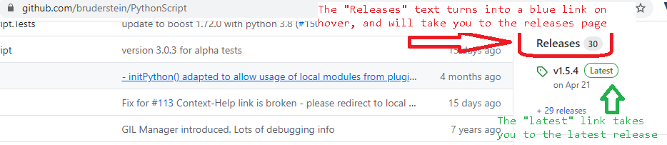

                  @V-S-Rawat said in Old Pythonscript stopped working:
                  this link
                  that is shown in your image takes to a page that shows this link
                  that again takes to the page that shows pythonscript v 1.0.8.0
                  Perhaps the problem is that the link you show takes you to a page that doesn’t directly have a “releases” button. However, if you click where it (currently) says “30 tags” you are quickly taken to the correct place.
                  Your linked page also shows text that says “see also (sourceforge)”.
                  These days I’m not sure why someone would think that a project that is on github would have a more-current hosting on sourceforge, but maybe that’s just my thinking. The “see-also…” part should have been a big clue that it is “historical”, but again, just the way I happen to think.

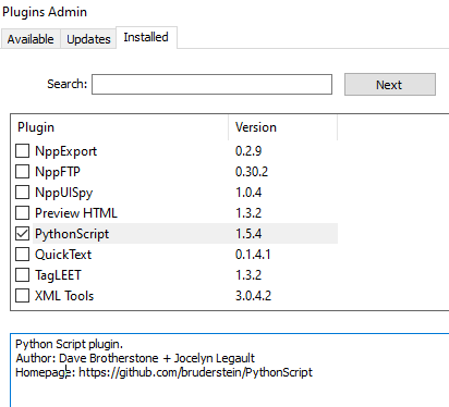

                    I downloade v1.5.4 and installed it,
                    though my Plugin Admin is still showing pythonscript v3.0.3 and when I ran my pythonscript on my text, it crashed with the message given in this image.
                    seems I have to first uninstall previous pythonscript, and then reinstall 1.5.4.

                      @Alan-Kilborn said in Old Pythonscript stopped working:
                      The “Releases” on the right (which turns blue when you hover, indicating it’s a link) takes you to the releases page, with all the alpha and permanent releases.
                      The “Latest” link in the green takes you to just the latest release, v1.5.4.
                        Yes. That is why I specifically said,
                        Note the words “I would highly recommend you un-install the v3.0.3 Alpha version”. That was meant to indicate that you uninstall the v3.0.3 before trying to install the v1.5.4. Apparently, that wasn’t clear enough.

                          V S Rawat @PeterJones
                          Solved.
                          I uninstalled and reinstalled pythonscript, this time directly through plugin admin, it installed v1.5.4
                          Then I ran my script on my text, and the script is working again.
                          Thank God.
                          Now, I am freezing my pythonscript plugin to 1.5.4 and will not update it ever, untill it stops working for some future npp.

                            @PeterJones said in Old Pythonscript stopped working:
                            I stand corrected.
                            Perhaps I’m alone in this, but I’m more used to github showing a “releases” button/link up across the top of such pages, and not on the right; but truly, Peter is correct, and it is there.
                              PeterJones @V S Rawat
                              That’s a recent change. I think I originally opted into the “feature preview” that made the UI slightly more “modern”, but moved the releases/most-recent links to the harder-to-find location, so I got used to it. But it appears that’s no longer a “feature preview”, and may have been pushed to everyone.
