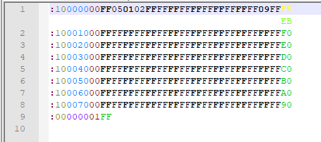

                      Sorry, I hadn’t noticed the example “intel hex” document in the initial piece of this conversation. I asked for example data because without seeing that example data that you presented now (or going back and seeing it at the beginning), I had no idea what the data would look like, so I had no way of giving the script valid data.
                      I ran the script, and it didn’t immediately do anything, so I went back and re-read the entire thread (seeing the original data… sorry) to see if it gave clues; then glanced through to the source code for print statements; I found if I changed self.debug_mode = False to self.debug_mode = True, it would enable a print. When I reran the script, I saw it print a single checksum. Given it was more than one line of data, I was surprised it only showed one. I clicked somewhere else, and it printed another. So then I started arrowing through. When I got to the first line (the one that had an error highlighted), it “dropped down” a second line after the first, where it showed a separate checksum lined up with the incorrect checksum:

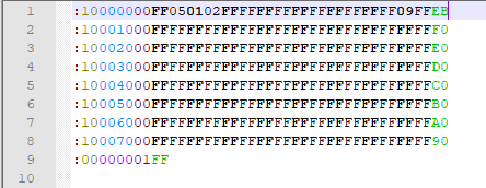

                      Not the best color choice (IMO), but it shows EB instead of F5 as the correct checksum. When I change F5 to EB, the syntax highlighter changes from red to green, and the “dropped down” line goes away.
                      Does it behave the same way for you? If not, turn on the debug printing by changing the line of code, saving, and re-running the script, and look at the console output as you run it. It should look like:
                      Once you know it’s working, then you can change that back to False. Exit Notepad++ and re-enter. The next time you run the script, it won’t be printing to the console anymore, but it should show you the fixed checksums.

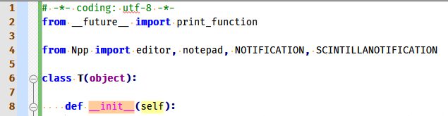

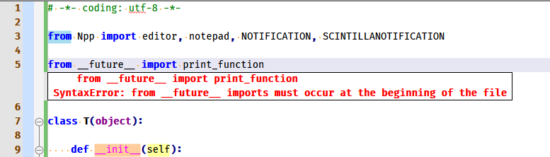

                        @PeterJones said in Intel Hex not higlighting:
                        This is called a Scintilla “annotation”.
                        I use it in my “python-check-syntax-on-save” script to produce some information that saves me the time of not finding that problem when I run the script, but rather when I save the file.
                        An example:
                        So I know I did an “oopsie” and need to move my from __future__ ... line upward, like this, where all is good:
                        This little syntax checker was inspired by @dail 's which is for Lua: https://dail8859.github.io/LuaScript/examples/luasyntaxchecker.lua.html
