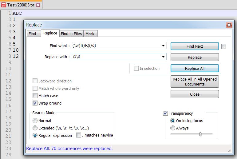

              Your replacement \1\3 will strip out the newlines, but it will not put a space after the abc and before the 123.
              I showed there is a space between ABC and 123451012.

                  it works:
                  Replace With:(?1\1\x20)(?2\3)
                  correct:
                  Replace With:\1\3
                  Cheers, Thomas 2020.

                              @Terry-R said in RegEx problems:
                              will add a space where none is, I do NOT believe it.
                              I don’t believe anymore either.
                              You were right
                              ABC was with a space
                              1
                              2
                              the space was invisible
                              formula used there:
