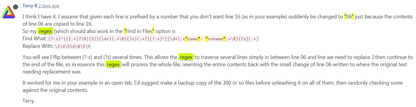

      Terry R
      You are right, however if you copy back what shows on your post it probably won’t work. I think the quotes have been nobbled by the markdown interpreter. We have all suffered from this issue and one way to resolve it is to put special characters around the code so the interpreter does NOT alter the characters at all.
      In the same way as you provided your 2nd example and I provided my regex, these can prevent the problem. Just inserting the code as you would text (as you did above) has (according to my test) affected the code.
      But good on you for trying it out. I got my code and removed the 2 (\d+) bits as I stated and then used your \1\4\5\4\7 and got the answer for when your file does NOT include line numbers.
      • Thomas 2020T
        Thomas 2020
        It can be like that?
        ^(((.+)\R){5})(\d+)(.+\R)(?s)(.+)(?-s)^(..)(.+“name”: “noname”.+\R)(?s)(.+)
        \1\4\5\6\7\5\9

          Terry R
          @Pan-Jan said in How to replace a line, which has a specific text, with the content of a specific line?:
          You are welcome to submit your proposed solution but I strongly suggest you need to insert those regexes within special codes so the markdown interpreter (the window you type the response in) does not adjust any characters that you type.
          You will note that my regex was in red text. This can be achieved by using the ` (grave accent character) around the regex. This key is generally top left on a full US keyboard, on the same key as the tilde character (~).
          The OP supplied their updated version without the (\d+) groups just as text, much like you and it was affected.
          Mine:
          (?-s)^(((.+)?\R){5})(\d+)(.+\R)(?s)(.+?)(?-s)^((\d+).+"name": "noname".+\R)(?s)(.+)
          Theirs:
          (?-s)^(((.+)?\R){5})(.+\R)(?s)(.+?)(?-s)^(.+“name”: “noname”.+\R)(?s)(.+)
          Look closely at the quotes in each regex, notice any difference? This is one of many changes that can occur if you don’t add the codes around text you do NOT want altered.
          Also, once typing a response in the window, you have other commands available. You should see a </> button above the window, select this first when entering code text, note this is what I did above rather than use the grave character. It is also useful for when inserting example text so that others may copy the data “unchanged”.
