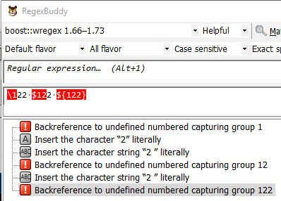

Haha, well, that’s why I said “fairly” certain.
Actually, I cheated: Long ago I read about RegexBuddy here on the Community (at least I think it was here), and purchased a license. It has proved invaluable.
Here’s what it told me for this case:
I should have cited RB a few minutes ago when I posted, but I wanted to see if there was agreement/disagreement first.
Very rarely have I found any discrepancies between RB and N++, but this may be one of those cases.
It is interesting that RB doesn’t say “Insert the character string 22 literally” in the second and third lines of its output, but breaks it into 2 parts…hmmm…
maybe that is implementation detail (!?)
