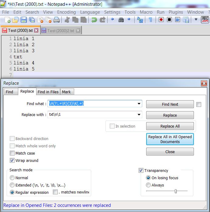

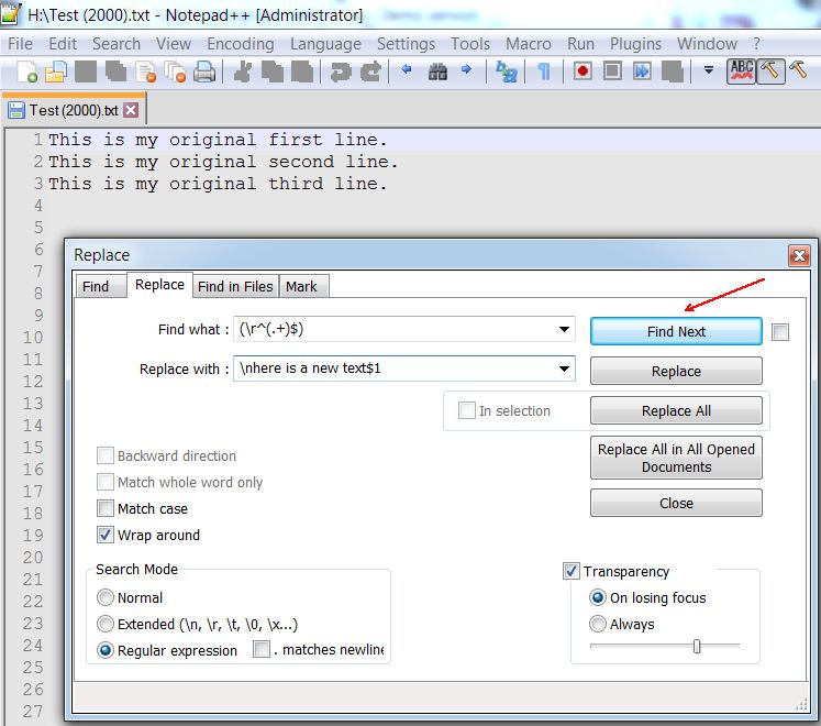

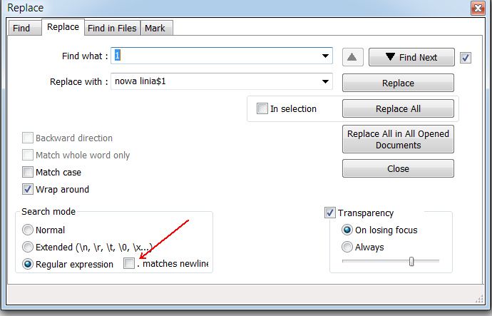

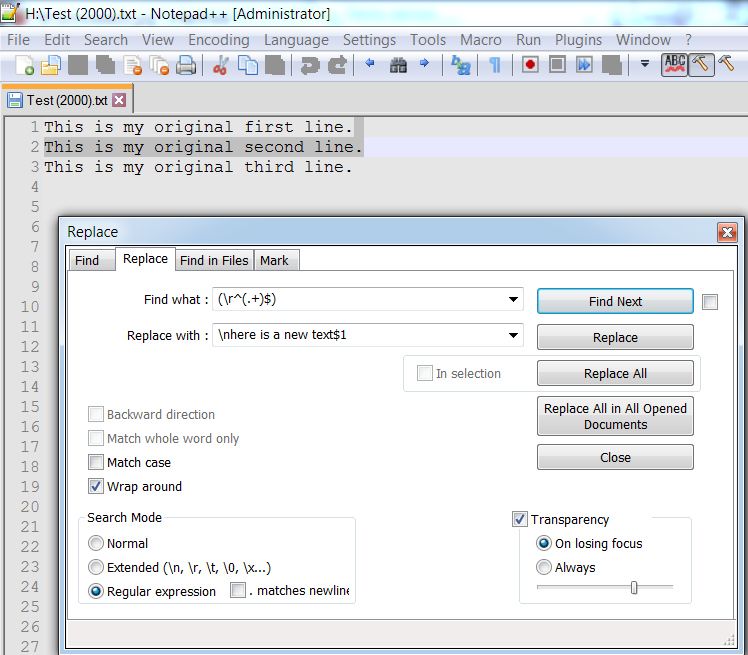

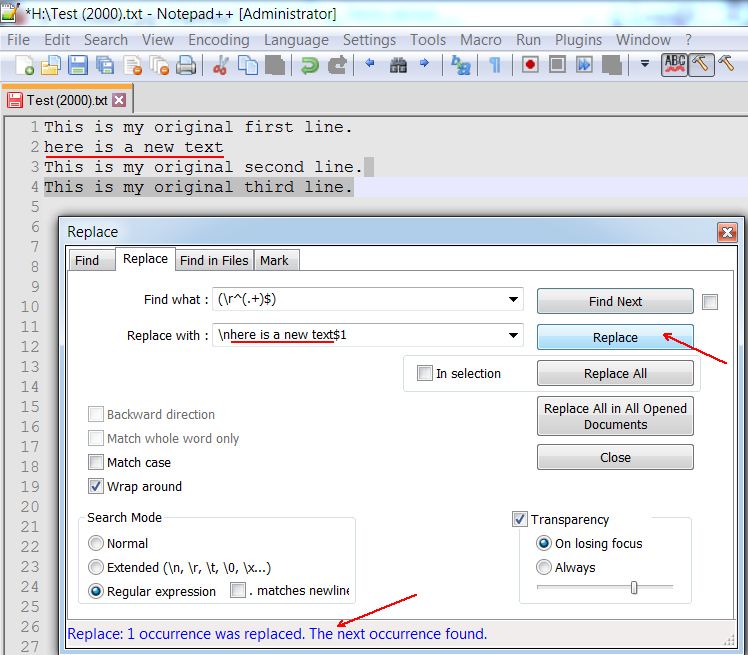

                        \n^(.+)
                        txt\n$1
                        My motto:
                        The simpler the pattern, the better.
                        NZ SelectN 1 Reply Last reply Reply Quote 0

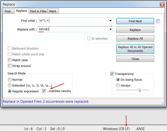

                          @Pan-Jan said in How to insert text into the second line with RegEx in Notepad ++ ?:
                          txt\n$1
                          I tried the code above, it will insert “txt” to line number 2; if only run once.

                                \n^(.+)
                                txt\n\1
