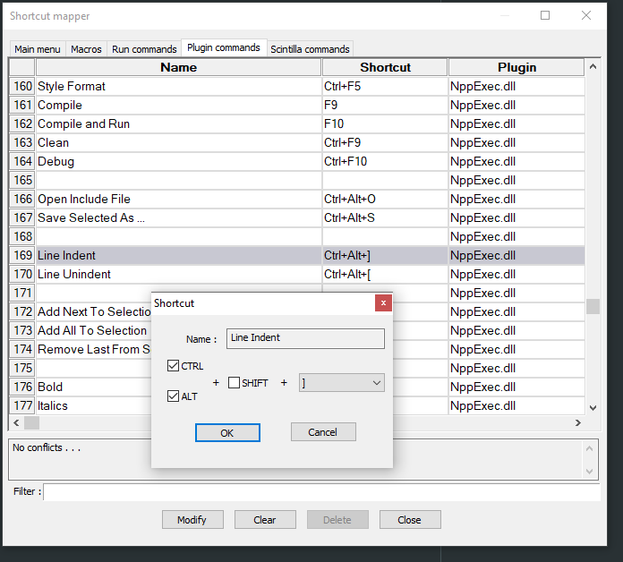

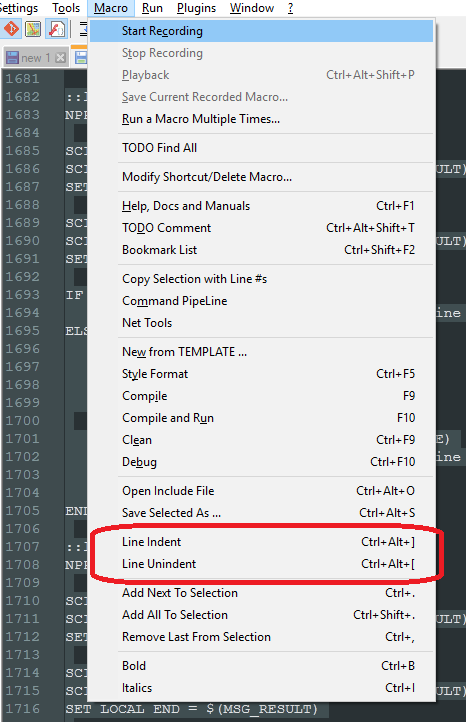

        I then use NppExec to add them to the Macro menu and then Shortcut Mapper to add the “Ctrl + Alt + [ and ]” shortcuts as @PeterJones did (note the OP’s request of “Ctrl + [ and ]” are already taken by SCI_PARAUP and SCI_PARADOWN respectively)

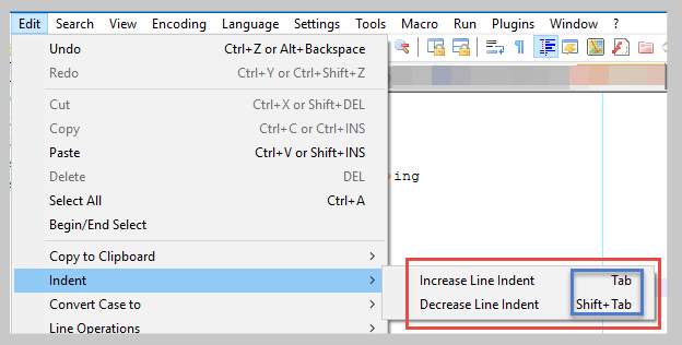

          These commands seem to have Tab and Shift+Tab tied to them:
          These commands aren’t in the Shortcut Mapper (that I could find, in the Edit category) so perhaps what is boxed in blue above is a hard-coding?
          At run-time the corresponding code is not hit with the key presses but only invoking via the menu items:

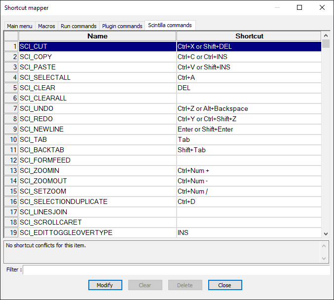

            Interestingly, if you remove the Tab and Shift+Tab mappings on the Scintilla commands page in Shortcut Mapper, the indent stuff in the Edit menu now looks like this:
            Note, no key mappings shown to the right of the commands.
            So then it would seem that Tab and Shift+Tab are now totally unmapped.
            BUT…trying them in an editor window I see that Tab still works. Curiouser and curiouser… Of course, maybe now it is at the point where it is just inserting a raw \x09. :-)

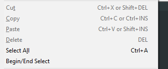

              You can find the SCI_TAB and SCI_BACKTAB in Shortcut Mapper as well as some shortcuts for Cut / Paste:
              And notice the Edit menu for Cut / Paste:
              The two (multiple) shortcuts are assigned, something you can’t do with Shortcut Mapper, so again, assuming N++ code is somehow adding the shortcuts based on Scintilla “defaults” or something?

                Edit => Indent => menu items are not quite doing what they advertise … I never knew they were there but now that I do, I like the functionality I’ve implemented above…
                Yes, but it seems like standard Notepad++ could do better here. I mean, the stuff in the Edit -> Indent menu is rather pointless if it is just going to do the same thing as Tab or Shift+Tab.
                Or maybe the idea is to give script writers a way to invoke these keys without calling a “key sender”?
                I have no idea of the history on this.
                But I do know that Increase Line Indent (and Decrease) surely seems misleading (unless you have a multiline selection).

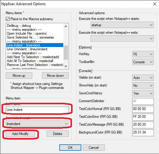

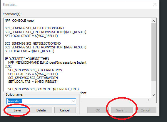

                            Michael Vincent @Cr8zy_Ivan
                            @Cr8zy_Ivan said in Change Indent Keyboard Shortcut?:
                            I’m a novice at Notepad++ and coding and general. I’ve installed the plugin, but then I’m confused as to what to do next. Macro\Modify Shortcut/Delete Macro? Plugins\NppExec\Show Console…? Save the code into a dll file? (I’m not even sure how dll files work)… oh boy
                            Plugins=>NppExec=>Execute. In the window, paste one of the “scripts” without the name and save with that name instead:
                            Do the same for the other saving it as the other name.
                            Then, Plugins=>NppExec=> Advanced Options…
                            Add a name, select the script name you saved that matches and press the Add/Modify button. Make sure the “Place to the Macros submenu” at the top is checked.
                            Finally, open Setting=>Shortcut Mapper… and add the “Ctrl + Alt + [” shortcuts:
