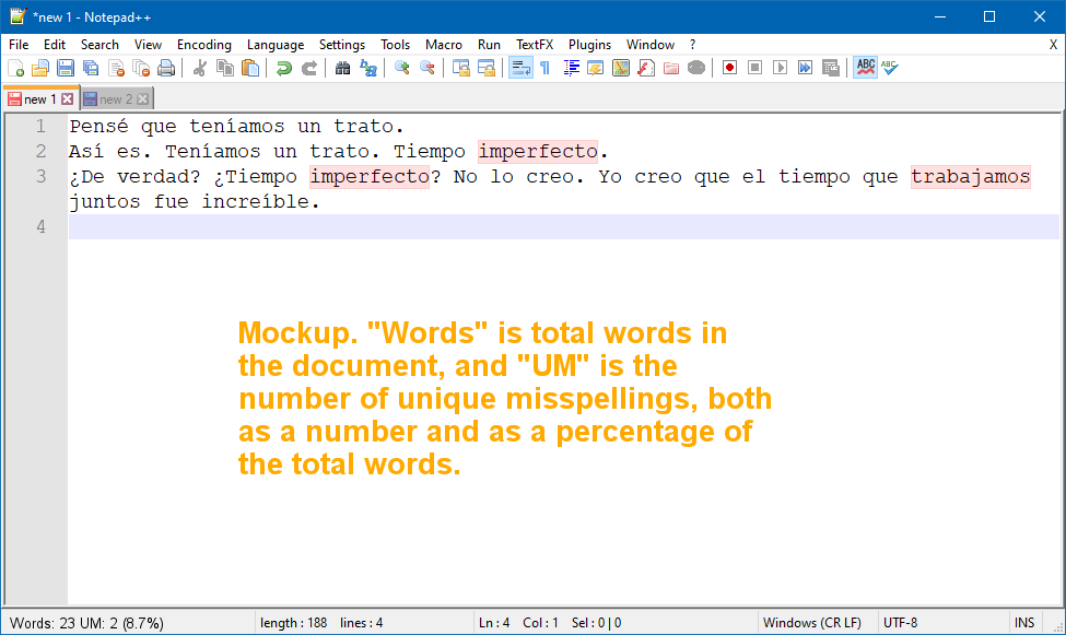

      I need a plugin for Notepad++ that tells me:
      1. The total number of words in the document
      2. The number of unique words
      3. The total number of non-misspelled words
      4. The total number of misspelled words, both as a number and as a percentage of the total number of words in the document
      5. The number of unique misspelled words, both as a number and as a percentage of the total number of words in the document.
      For example, in this document, you can see that there are 3 misspelled words, but only 2 unique misspelled words:
      The plugin should be able to produce the following window after pressing a keyboard shortcut:
      If you can manage to show the “Unique misspelled words” information in real time, while I type, even better!!

                        @Ekopalypse Hi! Yes, it’s just a mockup made with GIMP. I like creating mockups to make my ideas clearer.

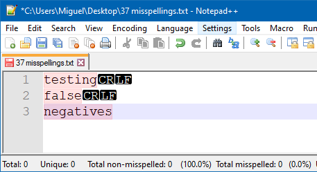

                                        here my first version.
                                        from Npp import notepad, editor, NOTIFICATION, SCINTILLANOTIFICATION, STATUSBARSECTION, MODIFICATIONFLAGS
                                        import os
                                        class WORD_CHECKER:
                                            def __init__(self):
                                                self.report = ('Total: {0:<5}  '
                                                               'Unique: {1:<5}  '
                                                               'Total non-misspelled: {2:<5}({3:.1%})  '
                                                               'Total misspelled: {4:<4}({5:.1%})  '
                                                               'Unique misspelled: {6:<4}({7:.1%})')
                                                editor.callbackSync(self.on_modified, [SCINTILLANOTIFICATION.MODIFIED])
                                                notepad.callback(self.on_buffer_activated, [NOTIFICATION.BUFFERACTIVATED])
                                                current_dict_path = os.path.join(notepad.getPluginConfigDir(), 'Hunspell')
                                                current_dict_file = os.path.join(current_dict_path, 'Spanish TOP972.dic')
                                                with open(current_dict_file, 'r') as f:
                                                    self.current_dict = f.read().splitlines()[1:]   # skip length entry
                                                self.on_buffer_activated({})
                                            def check_words(self):
                                                words = []
                                                editor.research('\w+', lambda m: words.append(m.group()))
                                                error_words = [word for word in words if word.lower() not in self.current_dict]  # insensitive word check
                                                total = len(words)
                                                unique = len(set(words))
                                                misspelled = len(error_words)
                                                misspelled_unique = len(set(error_words))
                                                notepad.setStatusBar(STATUSBARSECTION.DOCTYPE,
                                                                     self.report.format(total,
                                                                                        unique,
                                                                                        total-misspelled,  # non-misspelled
                                                                                        (float(total-misspelled) / total) if misspelled else 1,  # non-misspelled %
                                                                                        misspelled,
                                                                                        (float(misspelled) / total) if misspelled else 0,
                                                                                        misspelled_unique,
                                                                                        (float(misspelled_unique) / total) if misspelled_unique else 0))
                                            def on_modified(self, args):
                                                if ((args['modificationType'] & MODIFICATIONFLAGS.INSERTTEXT) or
                                                    (args['modificationType'] & MODIFICATIONFLAGS.DELETETEXT)):
                                                    self.check_words()
                                            def on_buffer_activated(self, args):
                                                self.check_words()
                                        WORD_CHECKER()
                                        I assume your customized hunspell file is in .\plugins\Config\Hunspell and is a file
                                        having one word per line? If this is not the case, then please post a few lines how this file look like.
                                        Btw. to get a Spanish Top 1000 dict, just name it so. I named mine Spanish TOP972.dic and this resulted in
                                        Open question are
                                        1. How do you plan to switch between Top??? dictionaries. Is this something you do while editing a story?
                                        2. Currently, all open documents are affected. Do you want a toggle switch mechanism?
                                        Known issues:
                                        1. Currently it seems that my script calculates misspelled words differently than DSpellCheck,

                                            And yes, I noticed it calculates misspellings a bit different. The differences from DSpellCheck default settings are that DSpellCheck ignores:
                                            -Numbers
                                            -Words containing numbers
                                            -ALL CAPS words, such as USA or V&M.
                                            -Words containing _
                                            There also seem to be some non-visible characters being counted as misspellings. The file I’m linking to here has 37 misspellings, but the script counts 38.
                                            https://www.spanishinput.com/uploads/1/1/9/0/11905267/37_misspellings.txt
