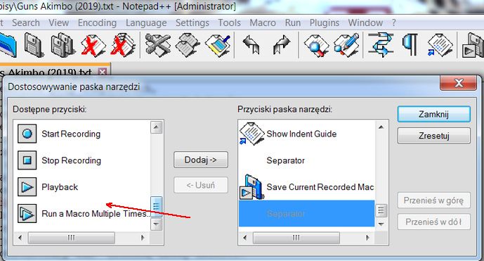

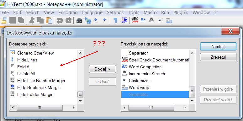

        Next the same icons

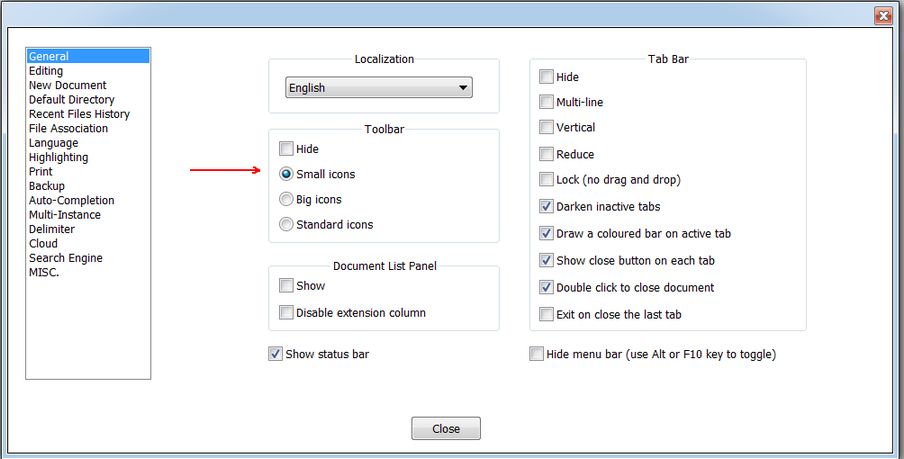

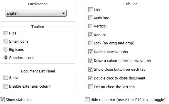

          Hi, @pan-jan,
          As you installed the Customize Toolbar plugin, I suppose that some icons are absent, by default. You’ll have to add some of them to your current toolbar !
          Now, in Settings > Preferences...> General > Toolbar, under the box **Hide**, there 3 possibilities :
          • Small icons
          • Big icons
          • Standard icons
          Did you really select the Standard icons ?
          Thomas 2020T 1 Reply Last reply Reply Quote 0
          • Thomas 2020T
            Thomas 2020 @guy038
            @guy038
            • Thomas 2020T
              Thomas 2020 @Thomas 2020

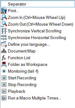

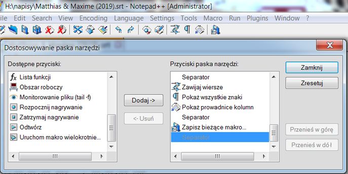

              These are the icons I can choose from
                @pan-jan,
                Could you do a test, selecting the choice Standard icons ?
                Then stop and restart Notepad++ => You should see all the plugin’s icons on the right of the toolbar !
                • Thomas 2020T
                  Thomas 2020 @guy038
                  @guy038
                  This is it.
                  I have them all now.
                  Thank you very much.

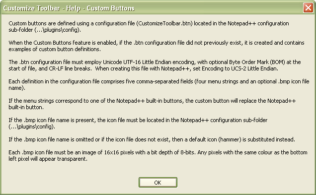

                    I would like to insert into the Toolbar an icon with …
                    How to add icon to this bar …
                    if she’s not here.

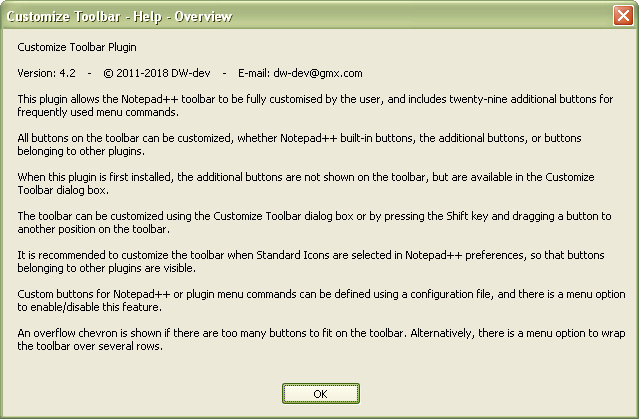

                      Hello @pan-jan and All,

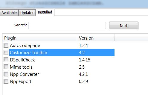

                      I just installed the last Unicode 4.2.0.0 - x32 version of the Customize Toolbar plugin in N++ v7.8.8 from here :
                      https://sourceforge.net/projects/npp-customize/files/Customize Toolbar v4.2/
                      And, in the Customize Toolbar menu, I see two lines :
                      • Help - Overview :
                      • Help - Custom buttons :
                      Sorry, I do not have time, presently, to investigate further on, in this matter. However, if this help is not enough for you, you could ask the plugin’s author, by e-mail, for additional information !

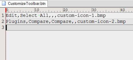

                            Hi, @pan-jan and All,
                            • Change the contents of the CustomizeToolbar.btn as below :
                            • Save the modifications of CustomizeToolbar.btn
                            • Stop and restart N++
                            • As you can see, the first default hammer icon is colorized and works ( Select All )
                            • However the second hammer icon remains grayed and does not seem to work :-((
                            After some tests, I realized that this second hammer becomes active ONLY IF you select a tab with a normal selection in its contents. In this case, hitting the second hammer icon does apply the Proper Case feature to the selection !
                            Indeed, if you select Edit > Convert Case to, you can see that the sub-menu is all grayed, if no selection has been done, previously !
                            So, refer to the plugin’s author for possible fixes. May be this wrong behavior depends on of Notepad++, itself !
                            BTW, in the meanwhile, simply do your selection and use the default Alt + U shortcut ! Easier, isn’t it ?.

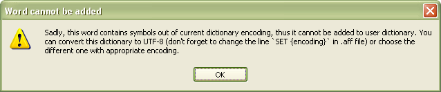

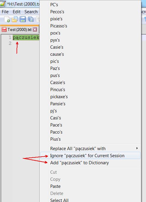

                              I can’t add the word with the letter “ą” to the dictionary or for Current Session
                                Hello, @pan-jan and All,
                                Sorry for my late answer ! Initially, I did not see a good explanation ! One day, I realized that, may be, your dictionary file was probably ANSI encoded ! I verified my assertion and, indeed, it’s the cause of your problem !
                                So, here is the road map :
                                • Go to the folder ...\plugins\config\Hunspell
                                • Back-up your lang.dic and lang.aff files ( One never knows ! )
                                • Start Notepad++
                                • Disable, temporarily, the DSpellCheck plugin
                                • Open the two files lang.dic and lang.aff, from within N++
                                • Change the first line of lang.aff with the command SET UTF-8
                                • Verify, in the status bar, that its encoding is UTF-8 ( not UTF-8-BOM ! )
                                • Select the lang.dic tab ( Probably, this file is ANSI encoded )
                                • Run the command Encoding > Convert to UTF-8 ( not convert to UTF-8-BOM ! )
                                • After a little while, save the modifications of lang.dic
                                • Now, close the two files lang.dic and lang.aff files
                                • Enable, again, the DSpellCheck plugin
                                => This time, if special words contain Unicode characters, with code-point over \x{00FF}, you should be able to add to the dictionary , in the lang.usr file
                                Anyway, the method is self-explained in the dialog, below, and I suppose that you’ve found out the solution, by now !
                                Best Regards

                                  I don’t use Hunspell.
                                  This is happening in Aspell.
                                  These words are written in pl.pws.
                                  pl.pws has ISO format.
