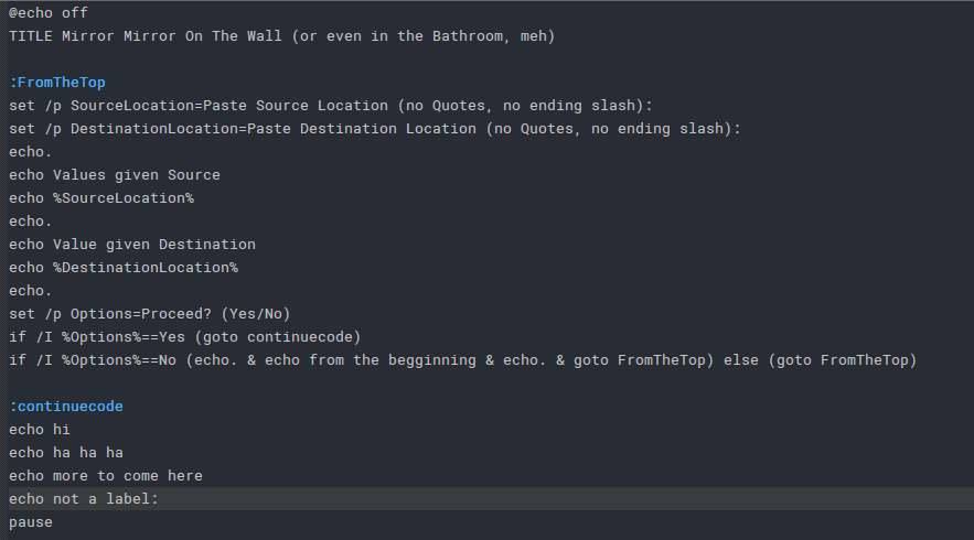

      The problem with this setup is, the “:” from delimiter 4 highlights labels in batch script, but it also highlights colons which are written for questions and other stuff.
      I want the highlight to be done only if the colon is at the beginning of the line and ignore other colons,
      I do understand that we can use colon on comment setting with force at the beginning, but I already have comment highlighters there and I use two colours for with two style in :: and REM.
      Can you please tell me if there is a way I can make the UDL highlight the line only if : is present at the beginning of the line and ignore others?

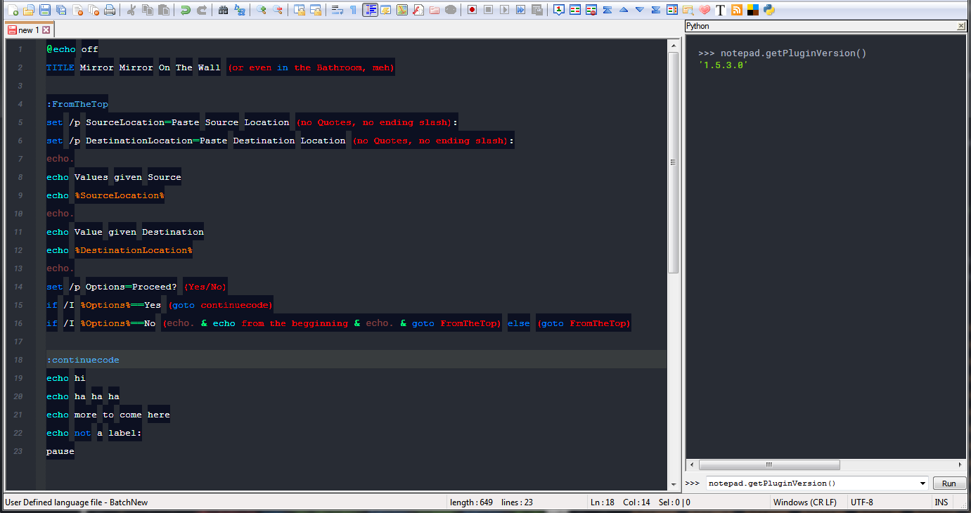

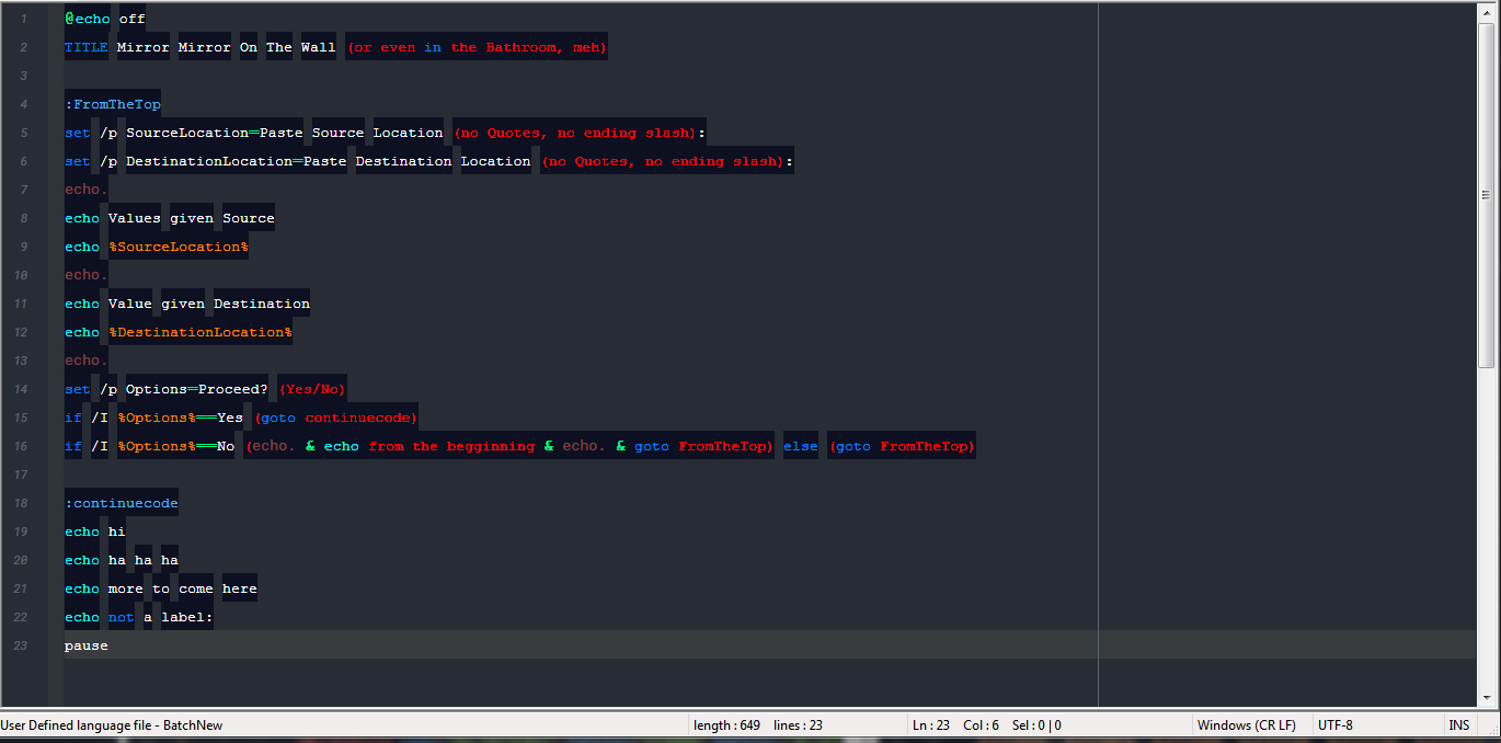

              Vin dickator
              @Ekopalypse
              Could you please spare some time to help me out here?

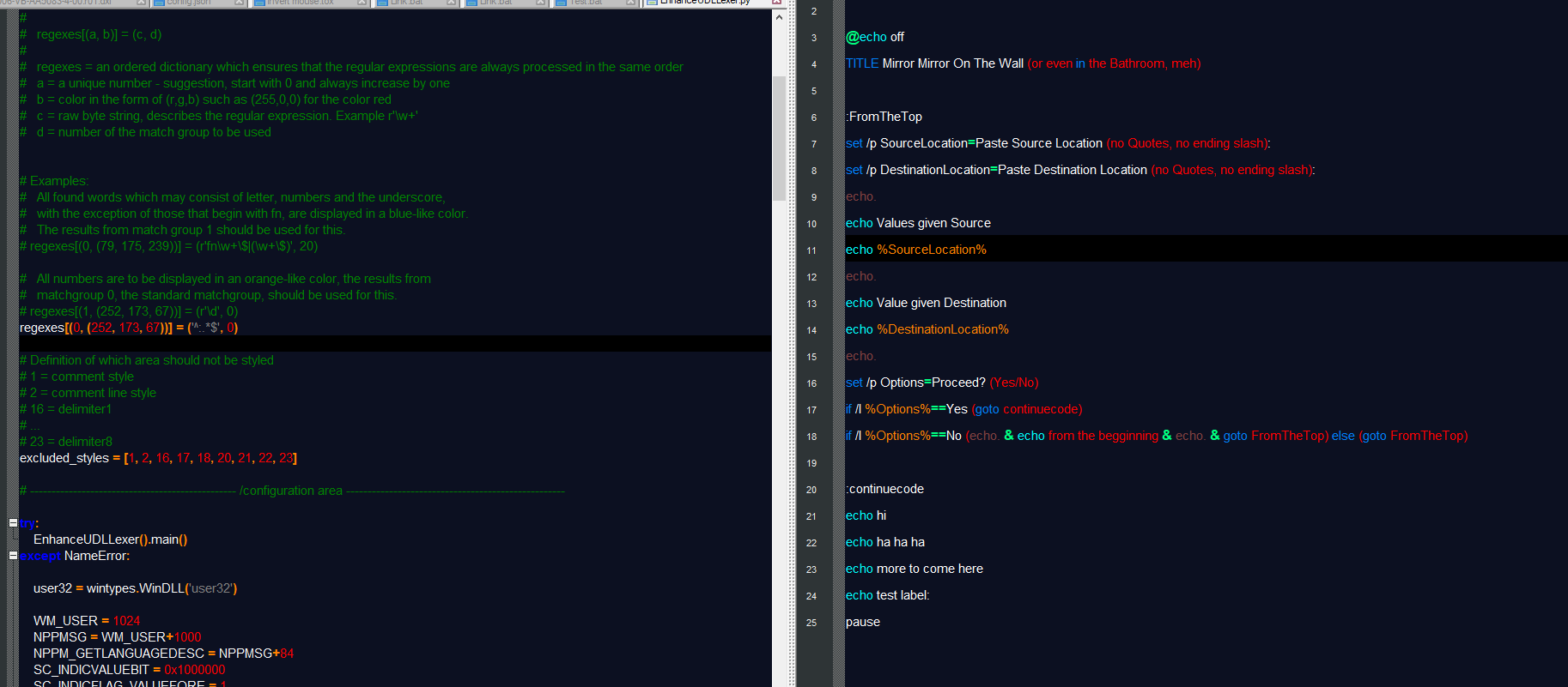

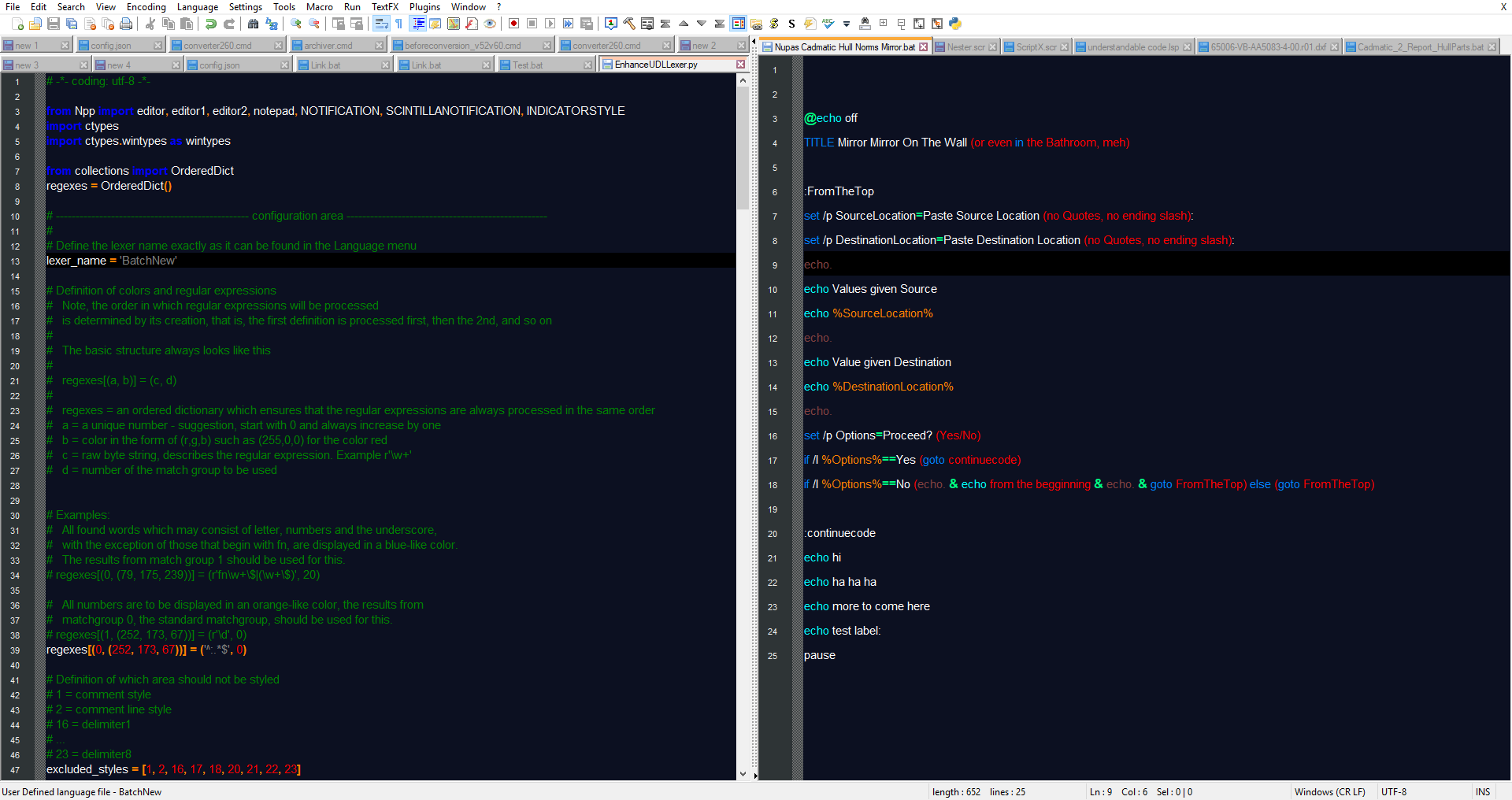

              Thanks to Peter’s link and direction, I have installed the PythonScript plugin and am using your script from the interface…
              I tried modifying the py to fit my requirements following the in-code instructions, but it doesn’t seem to do anything even If I run it manually; For diagnosis if the PythonScript works naturally I tried enabling and disabling the virtual space option and it works…
              Can you please check and let me know which part I’m missing here because the syntax highlighting is not working.
              My UDL is named “BatchNew”
              EnhanceUDLLexer.py
              lexer_name = 'BatchNew'
              regexes[(0, (252, 173, 67))] = ('^:.*$', 19)
              excluded_styles = [1, 2, 16, 17, 18, 20, 21, 22, 23]
              Test.bat
              @echo off
              TITLE Mirror Mirror On The Wall (or even in the Bathroom, meh)
              :FromTheTop
              set /p SourceLocation=Paste Source Location (no Quotes, no ending slash):
              set /p DestinationLocation=Paste Destination Location (no Quotes, no ending slash):
              echo.
              echo Values given Source
              echo %SourceLocation%
              echo.
              echo Value given Destination
              echo %DestinationLocation%
              echo.
              set /p Options=Proceed? (Yes/No)
              if /I %Options%==Yes (goto continuecode)
              if /I %Options%==No (echo. & echo from the begginning & echo. & goto FromTheTop) else (goto FromTheTop)
              :continuecode
              echo hi
              echo ha ha ha
              echo more to come here
              echo not a label:
              pause

                  I just tried replacing 19 with 0 and it still doesn’t change the highlight; please see below image
                    Ekopalypse @Vin dickator
                    @Vin-dickator
                    Hmm
                    this is what I get and what you want to achieve, right?
                    Vin dickatorV 1 Reply Last reply Reply Quote 2
                    • Vin dickatorV
                      Vin dickator @Ekopalypse
                      @Ekopalypse Yes , yes !
                      Did I miss something in my setup?
                        No, I don’t think so - is the name really BatchNew?
                        It must be exactly the same as listed in the language menu.
                        Vin dickatorV 1 Reply Last reply Reply Quote 1
                        • Vin dickatorV
                          @Ekopalypse
                          It’s actually User Defined language file - BatchNew (I tried this too, before checking for just BatchNew)
                          Please see below image

                            OK- then it should be BatchNew, the other stuff gets automatically added.
                            this means that regex matches do not get colored if one of the
                            styles is set to the positions of the match. Maybe you wanna start with
                            excluded_styles = [] to see if there is something set.
                              If this doesn’t work, can you post or link to the udl so that I can check this
                              on my side as well?
                              • Vin dickatorV
                                @Ekopalypse
                                Yes, I kept empty brackets for ‘excluded_styles’, still no change
                                Please click here to get the UDL
                                  gimme a sec to check it.
                                    Seems to work for me
                                    Could it be that you did the changes but haven’t restarted npp?
                                    If so, sorry, there is no restart mechanism in the script - maybe I should add one. What I do, normally, is to edit the script, then run another instance of npp to see if the changes are good and if not, close the new instance, reedit, restart a new instance …
                                    Not very user friendly but most of the time I only need one or two shots to make it work and see if the changes are good.
                                    • Vin dickatorV
                                      Vin dickator
                                      I actually did restart several times, I suppose I did a faulty installation with the PythonScript… I’ll redo that one more time,

                                          It’s strange, it does return the version, but it also shows other things for me
                                          Python 2.7.6-notepad++ r2 (default, Apr 21 2014, 19:26:54) [MSC v.1600 32 bit (Intel)]
                                          Initialisation took 32ms
                                          Ready.
                                          Traceback (most recent call last):
                                            File "C:\K\OD\Stuff\Soft\Notepad++\plugins\PythonScript\scripts\EnhanceUDLLexer.py", line 260, in <module>
                                              EnhanceUDLLexer().main()
                                            File "C:\K\OD\Stuff\Soft\Notepad++\plugins\PythonScript\scripts\EnhanceUDLLexer.py", line 72, in __call__
                                              cls._instance = super(SingletonEnhanceUDLLexer, cls).__call__(*args, **kwargs)
                                            File "C:\K\OD\Stuff\Soft\Notepad++\plugins\PythonScript\scripts\EnhanceUDLLexer.py", line 100, in __init__
                                              self.configure()
                                            File "C:\K\OD\Stuff\Soft\Notepad++\plugins\PythonScript\scripts\EnhanceUDLLexer.py", line 179, in configure
                                              editor1.indicSetStyle(0, INDICATORSTYLE.TEXTFORE)
                                          AttributeError: type object 'INDICATORSTYLE' has no attribute 'TEXTFORE'
                                          >>> notepad.getPluginVersion()
                                          '1.0.8.0'
