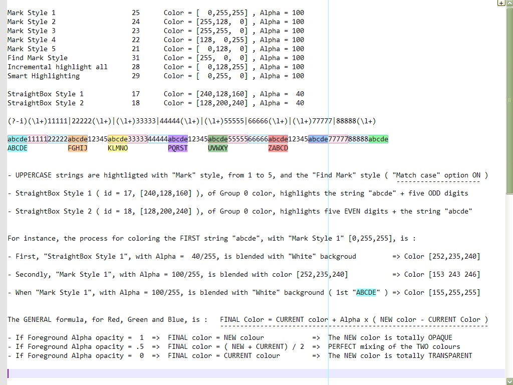

      Perfect, Alan ! I chose an other color for Straightbox Style 2, which have the same Saturation and Lightness than Straightbox Style 1 color, in the HSL Color Space ( S ≈ 79 and L ≈ 72 ). So, I could choose the same Alpha transparency ( 40 ).
      From their Hue ( 343 and 201 ) we deduce that they come from the pure colors [255,0,73] and [0,164,255] ( [343,100,50] and [201,100,50] values in the HSL Color Space )
      Here is, in a screenshot, a summary of the different styles, with their RGB values and their Alpha transparency as well as an example of the color alpha blending process, used in Notepad++, relative to the mixing of the ID style 25 with the ID style 17, over the White background ( [255,255,255] ) of the Default style of Default theme ( Stylers.xml )
      Two observations :
      • I noticed that you cannot use the Smart Highlighting style, either, natively and with your script. Thus, I preferred to place it at the end of the list, so for group 8
      • When less than 6 groups are involved in the overall regex, after running your script, if we use the Context menu Remove style > Clear all Styles option, we just see the highlighting of each $0 occurrence, alternatively, in light sky-blue or carmine color

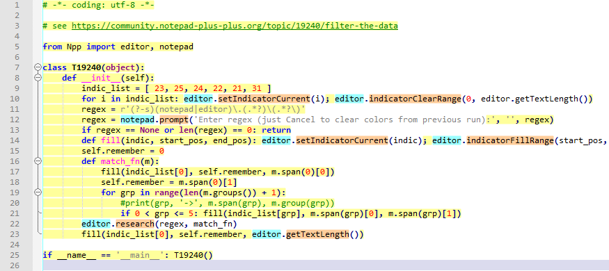

          How about supplying your screenshoted text as ACTUAL text here so that I can attempt to duplicate your coloring results without a lot of retyping? :-)
            Hello, @alan-kilborn, @ekopalypse, @peterjones and All,
            Alan, when I said :
            • When less than 6 groups are involved in the overall regex, …
            I do not see this behaviour as an issue. On the contrary, I think that it’s quite useful ;-)) I mean, as most of regex S/R don’t need more than 5 groups, we can :
            • Easily identify these groups, from 1 to 5, with your Python script
            • Then, easily identify successive $0 matches, thanks to the 2 colors of styles 17 and 18, after running the context command Remove style > Clear all Styles

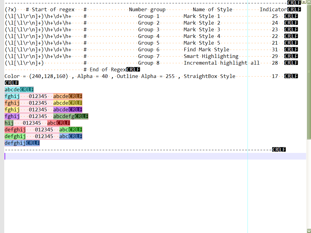

            Ah, OK ! Here is my text, being in N++ Post-it screen mode, in my previous post :
            Mark Style 1                   25      Color = [  0,255,255] , Alpha = 100
            Mark Style 2                   24      Color = [255,128,  0] , Alpha = 100
            Mark Style 3                   23      Color = [255,255,  0] , Alpha = 100
            Mark Style 4                   22      Color = [128,  0,255] , Alpha = 100
            Mark Style 5                   21      Color = [  0,128,  0] , Alpha = 100
            Find Mark Style                31      Color = [255,  0,  0] , Alpha = 100
            Incremental highlight all      28      Color = [  0,128,255] , Alpha = 100
            Smart Highlighting             29      Color = [  0,255,  0] , Alpha = 100
            StraightBox Style 1            17      Color = [240,128,160] , Alpha =  40
            StraightBox Style 2            18      Color = [128,200,240] , Alpha =  40
            (?-i)(\l+)11111|22222(\l+)|(\l+)33333|44444(\l+)|(\l+)55555|66666(\l+)|(\l+)77777|88888(\l+)
            abcde1111122222abcde12345abcde3333344444abcde12345abcde5555566666abcde12345abcde7777788888abcde
            ABCDE          FGHIJ     KLMNO          PQRST     UVWXY          ZABCD
            - UPPERCASE strings are hightligted with "Mark" style, from 1 to 5, and the "Find Mark" style ( "Match case" option ON )
            - StraightBox Style 1 ( id = 17, [240,128,160] ), of Group 0 color, highlights the string "abcde" + five ODD digits
            - StraightBox Style 2 ( id = 18, [128,200,240] ), of Group 0 color, highlights five EVEN digits + the string "abcde"
            For instance, the process for coloring the FIRST string "abcde", with "Mark Style 1" [0,255,255], is :
            - First, "StraightBox Style 1", with Alpha =  40/255, is blended with "White" backgroud         => Color [252,235,240]
            - Secondly, "Mark Style 1", with Alpha = 100/255, is blended with color [252,235,240]           => Color [153 243 246]
            - When "Mark Style 1", with Alpha = 100/255, is blended with "White" background ( 1st "ABCDE" ) => Color [155,255,255]
            The GENERAL formula, for Red, Green and Blue, is :   FINAL Color = CURRENT color + Alpha x ( NEW color - CURRENT Color )
            - If Foreground Alpha opacity =  1  =>  FINAL color = NEW colour            =>  The NEW color is totally OPAQUE
            - If Foreground Alpha opacity = .5  =>  FINAL color = ( NEW + CURRENT) / 2  =>  PERFECT mixing of the TWO colours
            - If Foreground Alpha opacity =  0  =>  FINAL color = CURRENT colour        =>  The NEW color is totally TRANSPARENT
              Hi, @alan-kilborn and All
              At the end of my description of the blending process, I made a little mistake. I should have written :
              - If NEW color Alpha opacity =  1  =>  FINAL color = NEW colour            =>  The NEW color is totally OPAQUE
              - If NEW color Alpha opacity = .5  =>  FINAL color = ( NEW + CURRENT) / 2  =>  PERFECT mixing of the TWO colours
              - If NEW color Alpha opacity =  0  =>  FINAL color = CURRENT colour        =>  The NEW color is totally TRANSPARENT
              This is more rigorous !

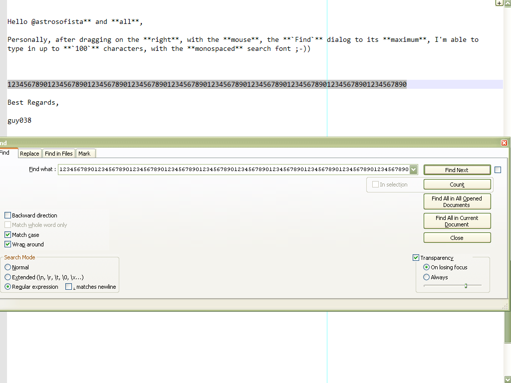

                @guy038 said in Filter the data !!!:
                Personally, after dragging on the right, with the mouse, the Find dialog to its maximum, I’m able to type in up to 100 characters, with the monospaced search font ;-))
                That solves quite well one of the problems I pointed out above, but creates another one, as it covers too much space on the only screen of my laptop. It might help in some cases, or if I had another monitor, but I don’t think it’s a long-term solution.
                Anyway, thanks for the suggestion.

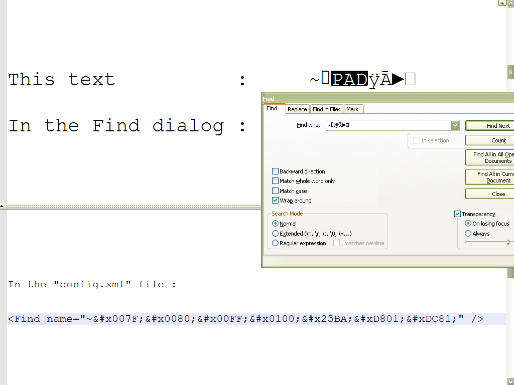

                              Hi, @alan-kilborn and All,
                              Seemingly, in the config.xml file, all characters above \x{007F} ( so non pure ASCII ) are encoded with the usual XML syntax &#x....;, where a dot stands for an hexadecimal digit
                              For characters, over \x{FFFF} ( so outside the Unicode Basic Multilingual Plane - BMP ), they are represented with two 16-bit code units called a surrogate pair. Refer to :
                              https://en.wikipedia.org/wiki/Universal_Character_Set_characters#Surrogates
                              https://en.wikipedia.org/wiki/UTF-16#Code_points_from_U+010000_to_U+10FFFF
                              An example :
                              In this example, the last character, displayed by the Courier New font as a small white square box, is the OSMANYA letter BA ( Unicode code-point 10481 ) which can be described with the surrogate pair \x{D801}\x{DC81}, correctly handled and decoded by your OS !
                              Refer     http://www.unicode.org/charts/PDF/U10480.pdf
                                Ekopalypse @guy038
                                @guy038
                                This is how it looks on your system, but I assume it might look different on a system where OSMANYA is more common.
                                That is, of course, if there is a localized version of Windows that OSMANYA takes into account.
