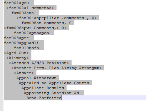

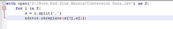

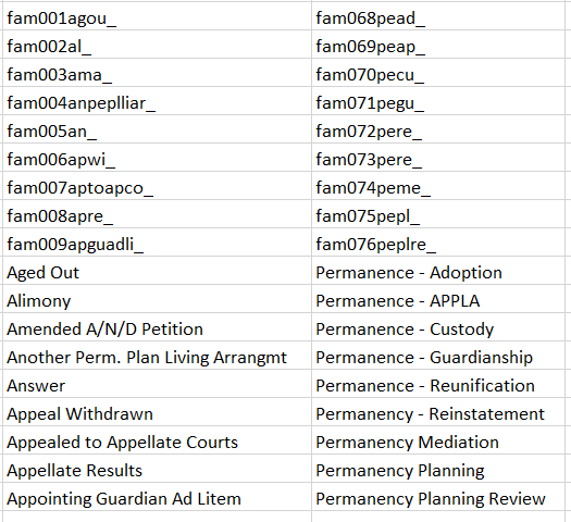

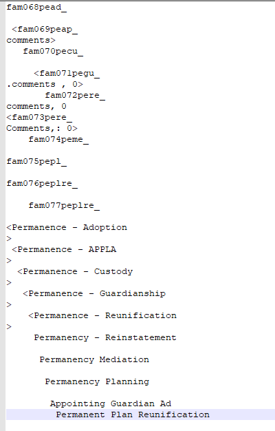

                                      I am learning so, I certainly do not object to being told the simplest way to accomplish my task. At this time I have the following:
                                      I have the following as an excel csv file:
                                      the sample code I am experimenting with is:
                                      And the script I am running is:
                                      The results I am getting is:
                                      So, it seems to be working except for the extra spaces and lines that are being added. What am I doing wrong that is causing the extra space to be added?
                                      Thanks so very much in advance for your assistance!!!

                                        I believe the extra lines are coming because l has the newline from the CSV still embedded, and when you split it, s[1] will contain the newline… You need to remove the newline before doing the split, such as s = l.rstrip().split(',').
                                        As far as the extra spaces: you haven’t shown us the actual CSV, only the spreadsheet-interpretation of the CSV… but it may be that in the raw CSV, it’s something like
                                        LEFT COLUMN,             RIGHT COLUMN AFTER ONE OR MORE SPACES
                                        The split would then leave all those spaces in s[1]. If you don’t want those spaces, you could strip all leading and trailing spaces off of a string using .strip():
                                            editor.rereplace(s[0], s[1].strip() )
