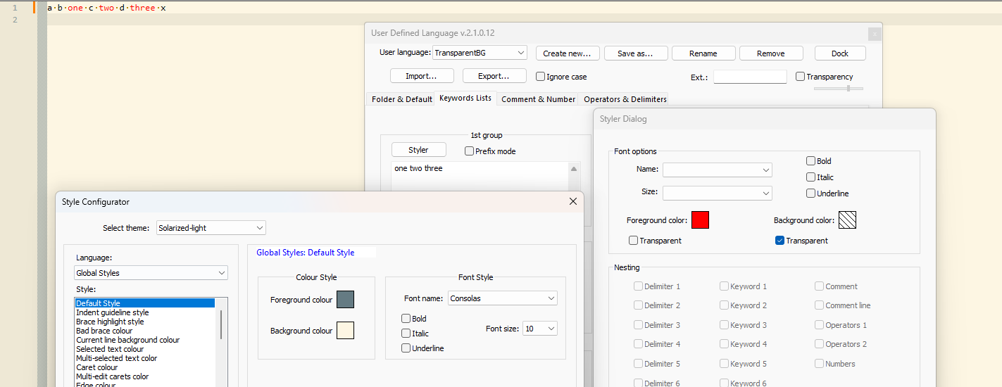

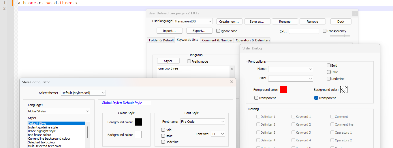

                            Here’s a screenshot of a UDL defined with keywords one two three in red-on-transparent (and that UDL’s “Default” styler set to black-on-transparent – not shown in screenshot), when originally set up in Default (stylers.xml):
                            And here, all I did was change the theme to Solarized - Light: the background changes with no change to the UDL:
