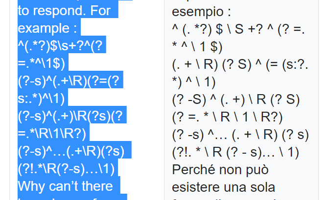

      1 / How to delete duplicate lines? I have used many expressions but it seems to help only when my file is limited to 10,000 lines. When my file has about 20,000 lines or more, the expressions are almost impossible to respond. For example :
       ^ (. *?) $ \ s +? ^ (? =. * ^ \ 1 $)
        (? -s) ^ (. + \ R) (? = (? s:. *) ^ \ 1)
        (? -s) ^ (. +) \ R (? s) (? =. * \ R \ 1 \ R?)
        (? -s) ^ … (. + \ R) (? s) (?!. * \ R (? - s) … \ 1)
      Why can’t there be only one form of expression to support the elimination of duplicate lines in my example format?

                            • Sarah DuongS
                              Sarah Duong
                              I used the line removal method as you instructed, it just shortened it. It seems that it only deletes duplicate lines close to each other. Conversely, if there is a line that is not on the side, it is not completely removed. It only helps to remove lines that have “:” unique. What I need is to delete the lines that have “:” and get the lines with all the characters before and after the “:” sign. I cannot use replacement in this case. Because it will replace all other lines. That I absolutely do not want.
                                Terry R
                                My suggestion for removing duplicate lines does NOT work as your data is different to the examples. In examples the duplicates are beside each other, your real data does not have that. If you were to sort your file lexicographically then my suggestion will work.
                                I’m not on my pc so cannot confirm the function but I think it’s in the same area as remove duplicate lines.
                                I’m sure we can have you sorted with the remaining problems very quickly. Can you answer, what do you want to do with the lines that have characters after the :, that was your #3 question.
                                Sarah DuongS 1 Reply Last reply Reply Quote 1
                                • Sarah DuongS
                                  Sarah Duong @Terry R
                                  @Terry-R In my text file, there are some lines that only have “:”. How to eliminate them? I cannot use alternative methods
                                  ^: \ R
                                  Because it replaces the “:” in other lines. You don’t seem to understand what I mean by this sentence.
                                  In question 3, how to select only the lines with the characters after the “:” example.
                                  a_cameronsse@hotmail.com: jof6IutH
                                  abradbery@gmail.com: q74Xpc0O
                                  a.tworowski@o2.pl: sXOa61Dq
                                  ageorgiev86@yandex.ru: dIYk0ONb
                                  aipunts@yahoo.co.uk: pul8OBa4
                                  I don’t know how to make you understand what I mean. Sorry for my limited english
                                    Hello, @sarah-duong, @Terry-r and All,
                                    First of all, thanks for posting a real example of your text. However, I noticed that the very last line is :
                                    idrzewicz@icloud.com:w0Re72Ht```
                                    And I suppose that the correct line is rather :
                                    • Regarding your question 2, to delete line with an unique colon char, the Terry’s regex S/R is NOT :
                                    SEARCH   ^: \ R
                                    REPLACE  Leave EMPTY
                                    but, indeed :
                                    SEARCH   ^:\R
                                    REPLACE  Leave EMPTY
                                    Assuming your example, after clicking on the Replace All button, 6 lines, with an unique :, are deleted !
                                    • Regarding your question 1, to delete duplicates lines, you could use the following regex S/R :
                                    SEARCH (?-s)^(.+\R)(?=(?s).+?^\1)
                                    REPLACE Leave EMPTY

                                      @Sarah-Duong I think I see a problem you are having with the Regexes. Using Google translator is introducing spaces in any characters not determined to be words. Thus I used your original regexes in your first post and translated from English to Italian and this is what i got:
                                      We can see that the original does NOT contain spaces, the translation does. So you need to be careful copying the regexes back to your language. by all means copy and translate so you can read our words to you. BUT, do not try to do the same for the regexes. Copy those and paste directly into NPP!

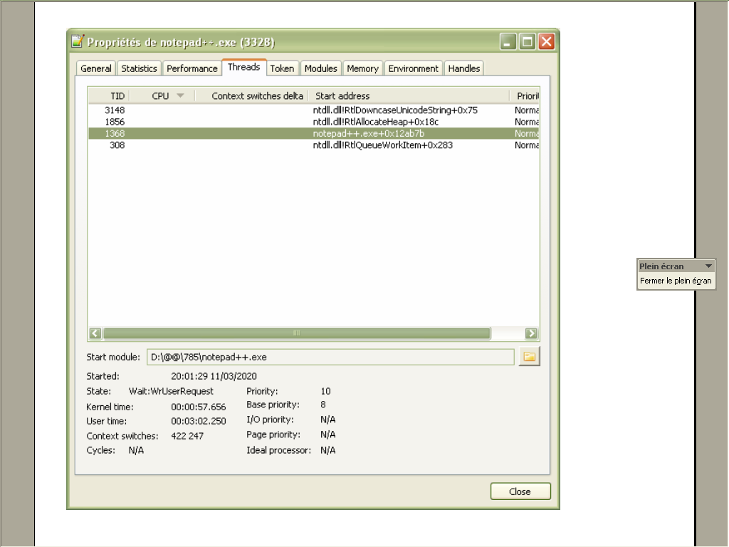

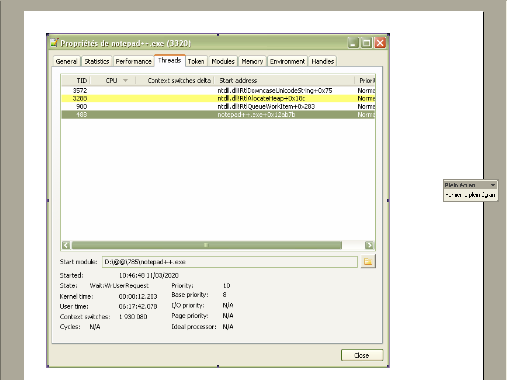

                                        Terry, I would like to emphasize, in this post, the importance of choosing the right type of quantifier ( greedy, lazy or atomic ) in a regular expression !
                                        • From the initial text of @sarah-duong, above, which contains 623 lines, I duplicated it 325 times and I added a final line-break, at the very end of this test file. So, I obtained a file of 202,475 lines, for 5,016,375 bytes
                                        • Then, applying the regex S/R, with the lazy quantifier +? :
                                          • SEARCH (?-s)^(.+\R)(?=(?s).+?^\1)
                                          • REPLACE Leave EMPTY
                                        against this large text, I did get, after clicking on the Replace All button and 202,323 replacements ( In fact, suppressions ! ), in 3mn 57s,, on my old XP laptop, the very short expected text, of 3,711 bytes long, containing the 152 lines, all different !
                                        • Then, applying the regex S/R, where I changed the lazy quantifier +?, in the look-ahead, with the usual greedy quantifier + :
                                          • SEARCH (?-s)^(.+\R)(?=(?s).+^\1)
                                        against this same text, even after a 1-hour process about, no result occurred, although Notepad++ did not seem to get stuck !?
                                        So, I decided to run, again, this regex S/R, at 10h45 about, expecting a correct result, after some hours, when I was back home ! By chance, the process did stop, in the evening and has correctly deleted 202,323 lines, giving the expecting final file of 3,711 bytes long and 152 lines ;-))
                                        In order to know the exact time, used to execute these 202,323 replacements, by Notepad++, I simply opened the Process-Hacker v2.39.124 utility, double-clicked on the Notepad++ process to get its properties and, then, clicked, in the Threads tab, on the one with start address = notepad++0x12ab7b. See, below :
                                        => The sum of the Kernel and User times, minus 2s about, due to N++ startup, indicates the time of the S/R : 6h 17m 52s !! Compare with the previous time of 3m 57s, as shown below ;-))
                                        So, guys, could you repeat these two regex S/R, to know, even approximatively, with your configuration and OS, the time to process this UTF-8 test file, containing 325 times the initial text of @sarah-duong. So, a total of 202,475 lines and 5,016,375 bytes ! I quite curious of the results ;-))
