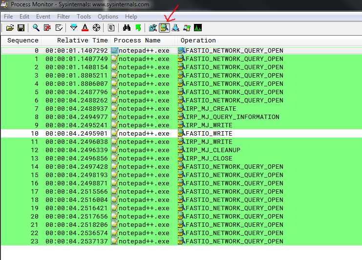

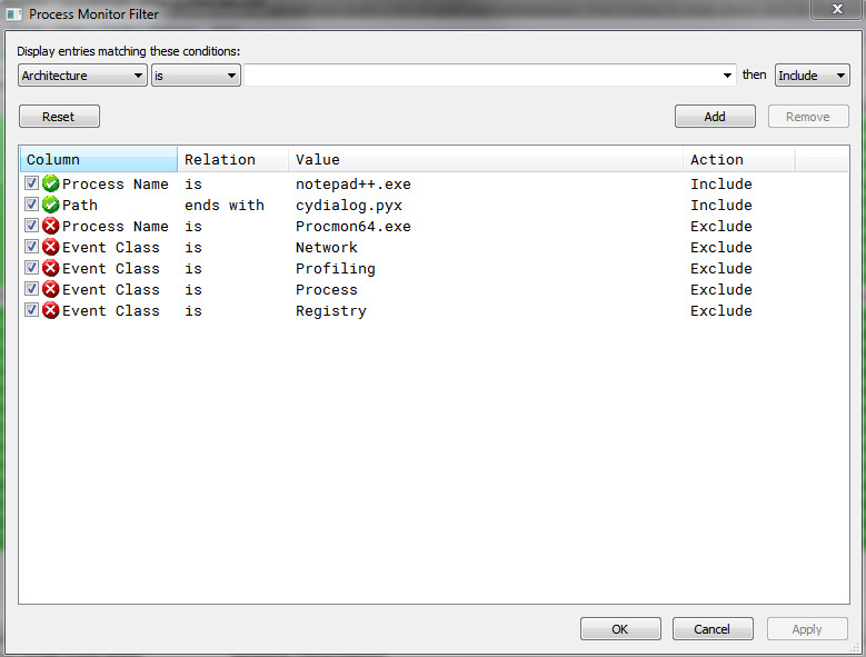

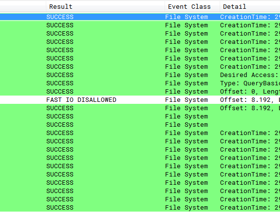

                Ekopalypse @doubledeej
                @doubledeej
                for example I created filters for process notepad++exe and file cydialog.pyx
                and made sure the file activities are selected (red arrow).
                You will get results like
                The most interesting here are the write and close operations.
                If you scroll more to the right you will see additional useful information
                • doubledeejD
