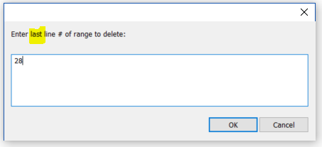

              Alan Kilborn @pinuzzu99
              @pinuzzu99
              Hmmmmmm, well, first, you don’t need the boomarks. I’m not sure if you put them in just for running the script, or if they were just already there.
              Second, you have to read the prompt on the box: Enter first line # of range to delete: where, for your example, you would enter 10:
              When you say OK to that, it will ask you for the last line, where you would enter 28:
              When you do that and press OK, it will then delete your range of lines, including the first and last (10 and 28 in this example will be gone after the final OK, as well as all lines in between).
              You can press Cancel in either box to abort everything.
              Did I really make it that hard to understand??
              Sure, it could all be combined into one box, but then one has to think more about what to put in a single input box. The way I did it, you just follow the prompts.
              By the way, your first line could have been 28 and your last line 10 and it would have worked the same way.
