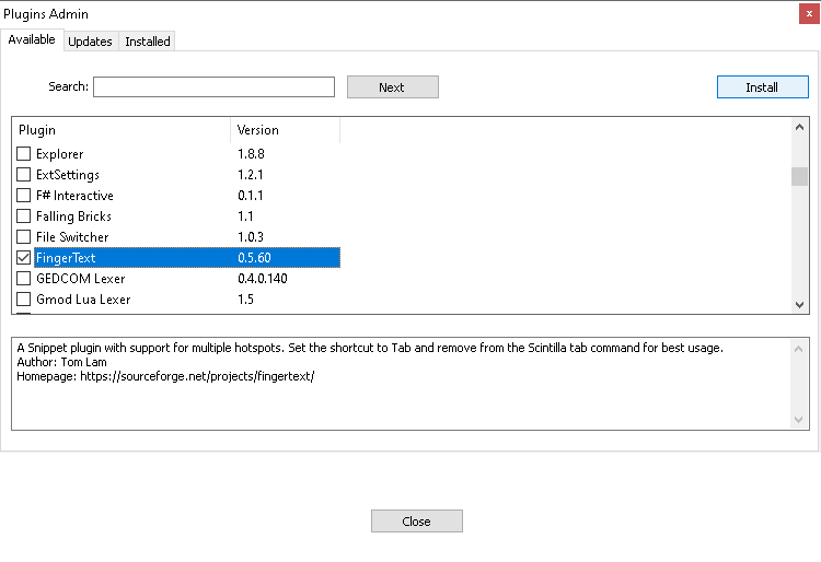

          @Alan-Kilborn How do you install a plugin? I downloaded finger text and copied the files to the plugin folder but I am not sure what to do next.
            @Anurag-Saksena said in How to create abbreviations for java code:
            There are two ways. But first, it should be noted that FingerText is only available for 32-bit Notepad++ (from the official source). If you have 64-bit Notepad++, the files you downloaded won’t work; if you must stay with 64-bit Notepad++, you will have to find alternate solution (or convince someone to rebuild FingerText as 64-bit – or find someone who already has)
            Method 1: Use the Plugins > Plugins Admin to check the box next to “FingerText”, then click Install
            Method 2: Download the zipfile (as you did). Exit all instances of Notepad++. In your Notepad++ installation (often c:\Program Files (x86)\Notepad++), go into the Plugins subfolder, create a directory that matches the name of the DLL without the extension (it looks like it’s called FingerText.dll, so the folder in a standard install would be C:\Program Files (x86)\Notepad++\Plugins\FingerText), and unzip the DLL file into that folder. Reload Notepad++.
            At this point, Plugins > FingerText menu entry should exist.

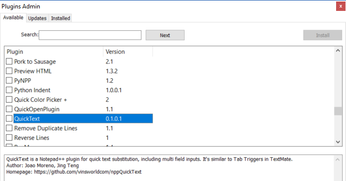

                QuickText appears to be available via Plugins Admin (not sure why you didn’t mention that?):
                • Michael VincentM Offline
                  Michael Vincent @Alan Kilborn
                  Interesting. I never did the pull request to nppPluginList to add it. Wonder how it got there? Also, that’s not the latest version; 0.1.1.1 is available on the GitHub releases page.
                        It appears @chcg added it with a commit last summer. And in December, updated it to 0.1.1.1.
                        For adding to the list (though I’ve never done it), the nppPluginList page implies you just do a Pull Request to add it into the JSON files. You can search for closed PR to see what the PR look like that get plugins updated (I couldn’t find any PR attached to @chcg’s commits, though I admit navigating these things isn’t second nature to me yet, so there might be an associated PR with his commits).
                          @PeterJones said in How to create abbreviations for java code:
                          I wonder why it still shows as 0.1.0.1 in PA then?

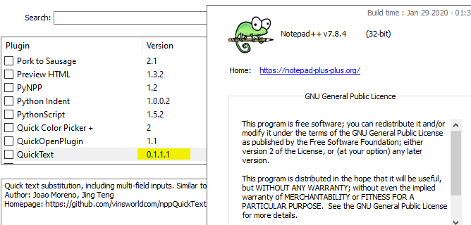

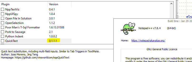

                            @Alan-Kilborn said in How to create abbreviations for java code:
                            In what version of Notepad++ / nppPluginList?
                            v7.8.4 shows 0.1.1.1 for me:
                            (both have the DLL’s RClick > Properties > Details showing 1.1.7.0)
                              Ah, I’m forgetting that PA isn’t quite “live”, like PM used to be. A shallow replacement, sadly. And all that work put into it, too…
                              Yea, I’m running a slightly older N++, so it makes sense.
                              Sorry to confuse because I forgot how things work.
