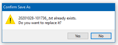

                              Alan Kilborn @carypt
                              @carypt said in Notepad++ just deleted all the text from my files:
                              saving edits of an opened file under same name (save-as-operation)
                              Ok, so WHY would you do this?
                              Don’t do a “Save As”, just do a “Save”.

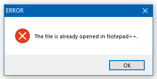

                              I find that if I try this, unintuitive as it may seem, I get this:
                              If I say “Yes”, I get:
                              and any edits in my file are not affected (the file is not saved).
                              So, aside from the fact that you shouldn’t do this, I didn’t see any real harm in it.
