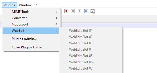

                                  • Tony ScialdoneT
                                    Tony Scialdone
                                    I’ve been trying and trying to get this plugin to work again… it makes my work SO much faster. Unfortunately, nothing seems to work. I’m hoping you can help. Here’s what I’ve done, using ++ v8.1.4 (32-bit):
                                    1. Installed through the built-in Plugins Admin
                                    2. Removed and installed manually, following the instructions above. The ANSI version gave a compatibility error, so I put the regular version’s files in /plugins/WebEdit.
                                    3. I’ve also copied WebEdit.ini and WebEdit.dll to the /plugins/ folder.
                                    I can see that the .ini file has commands in it, but the Shortcut Mapper doesn’t show the commands.
                                    Ideas?
                                      PeterJones @Tony Scialdone
                                      @Tony-Scialdone ,
                                      Here are the steps I used to get it working with v8.1.4-32bit:
                                      1. Use Plugins Admin to install WebEdit plugin.
                                        • after the restart of Notepad++, the Plugins > WebEdit menu showed up, but there were no available actions in the menu, and nothing on the toolbar:
                                        • if I look in my <npp.install.dir>\Plugins directory, there is a WebEdit subdirectory, with a Config subdirectory (<npp.install.dir>\Plugins\WebEdit\Config\)
                                      2. Exit Notepad++.
                                      3. Copy the *.bmp and WebEdit.ini from <npp.install.dir>\Plugins\WebEdit\Config\ into %AppData%\Notepad++\Plugins\Config\ directory.🛈

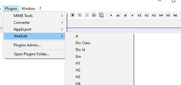

                                      4. Restart Notepad++
                                      5. Now the WebEdit menu has actions, and the buttons are on the toolbar:
                                      You might want to see this more recent WebEdit discussion: https://community.notepad-plus-plus.org/topic/21504/webedit-plugin-tooltips-out-of-sync
