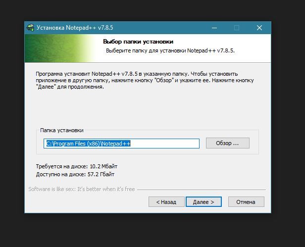

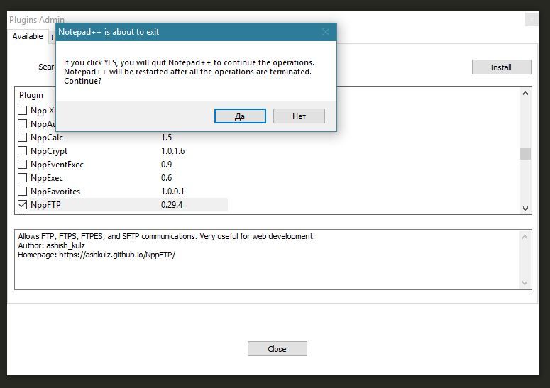

      First this:
      And then its try to install not portable version of npp

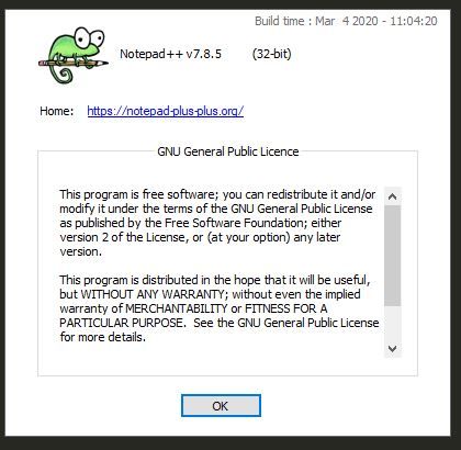

          Did you always test with the 32bit version?

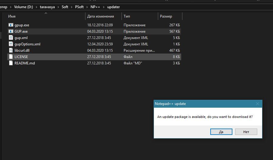

          The question why I’m asking is that I saw in your log that the
          gup.exe file is assumed to be ~700KB but for 32bit ~567KB is ok.

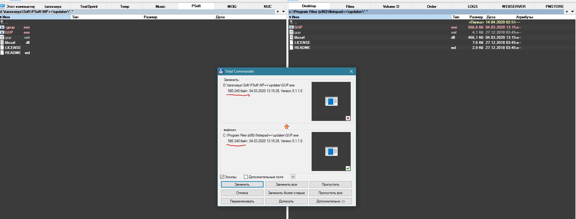

          Could you try to replace the gup.exe from the installed version with
          one from the portable version and retest?
          • Вася ТараринВ
            Вася Тарарин
            @Ekopalypse !!! Excellent!!
            Despite the fact that the GUPs are identical in size, replacing the file helped me!!! Plugins Admin start to work and I update all my plugins!
            Moreover, when I returned the GUP.exe from the portable version, the plugin manager stopped working again.
            So, I can state the fact that in the archive, of a portable version npp.7.8.5.bin, was a damaged GUP.exe.
            Many thanks for the help !!!

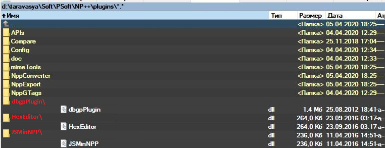

              This is my backup for any version of Notepad ++:
              Imgur

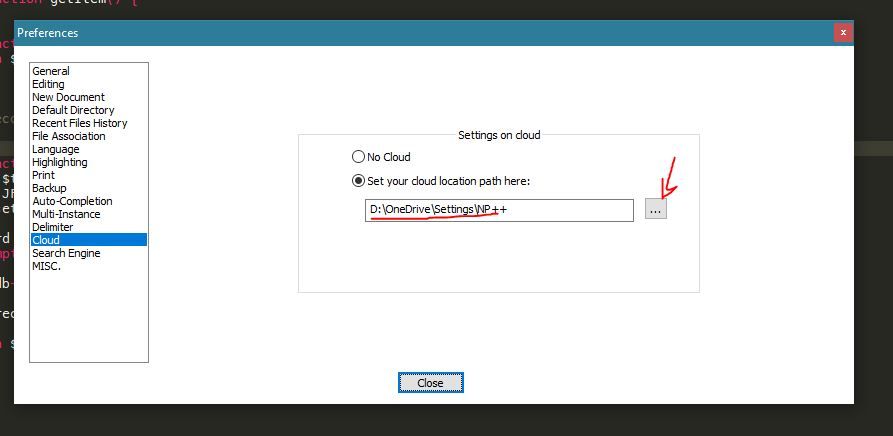

                BTW(I think this info will be is useful here)… I use the Cloud options for store my configs. With this option, I dont need to control what files copying while update, because npp use config files placed in this location:
                (of cause you can choose your desired ) and ignores those configuration files that are in the npp folder.
