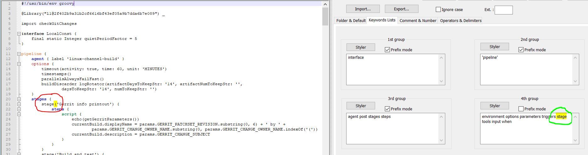

          I have come here, because I was looking up existing Notepad++ issues, have found this https://github.com/notepad-plus-plus/notepad-plus-plus/issues/7622 and followed a link in a comment pointing to here.
          My problem is that I am trying to configure a UDL in Notebook++ for Jenkins Pipeline syntax,
          but the UDL lexer in Notepad++ does not find and colour string “stage” if there is “stage(”.
          Can I use your script to replace the Notepad++’ lexer ?
