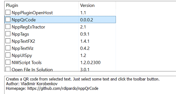

                                  ensnared
                                  Apologies if this isn’t the place to report obsolete plugins in the list. If it isn’t, please direct me to the proper place :)
                                  The plugin NppQrCode (v0.0.0.1) can not be installed (on x64 atleast). It gives the following error:
                                  Also, the homepage URL in the description for the plugin is dead (I’m not allowed to post actual links, but it’s
                                  github(dot)com/vladk1973/NppQrCode)
                                  • rdipardoR Offline
                                    rdipardo @ensnared
                                    A new version (0.0.0.2) has been available since Notepad++ 8.5.8:
                                    If you’re stuck with 8.5.7 or something older, you can also get it directly from GitHub.
